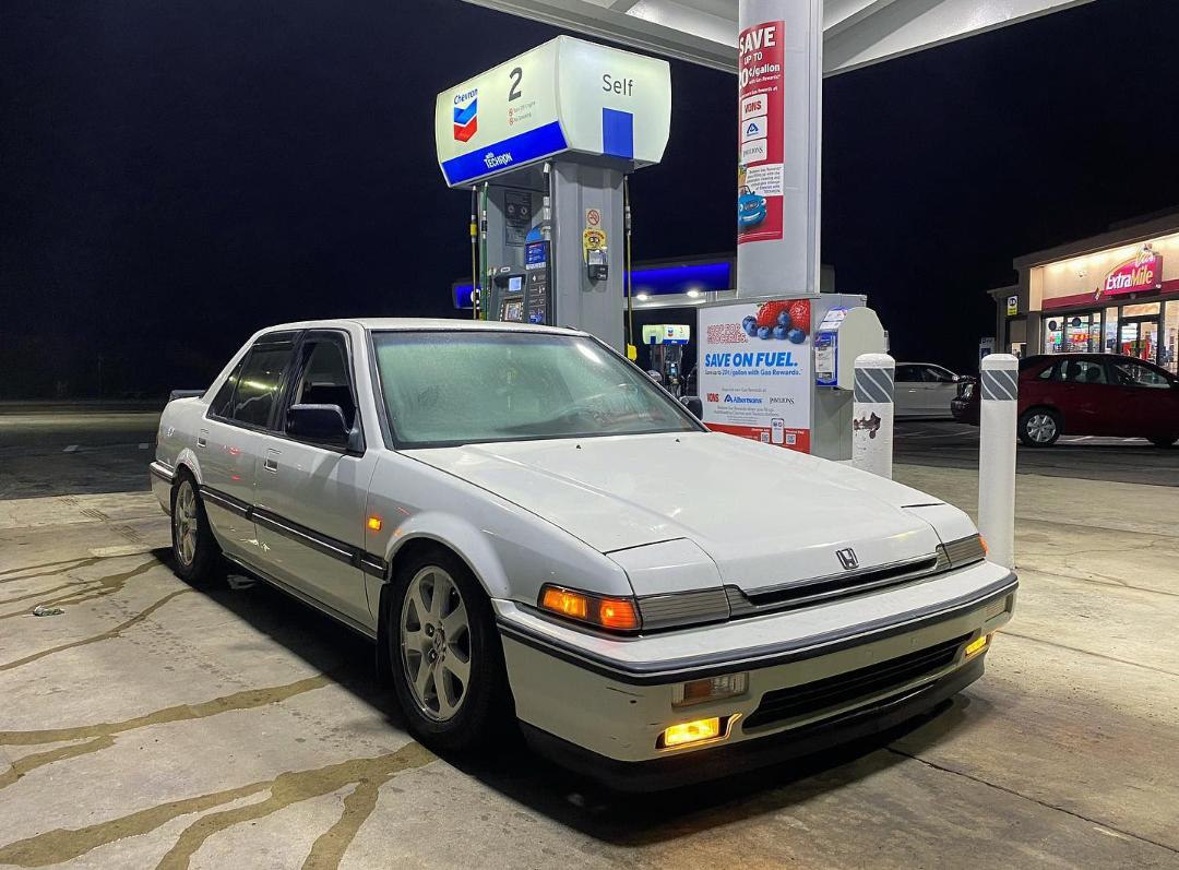

I noticed back in July m_alonzo920 on Instagram got Koni yellows for all 4 wheels with progressive Eibachs up front. I'm going to try to see what he used, supposedly Ground Control hooked him up. I assume he is in the fb group too, but I won't touch that site with a 10' pole.
As his car sits
