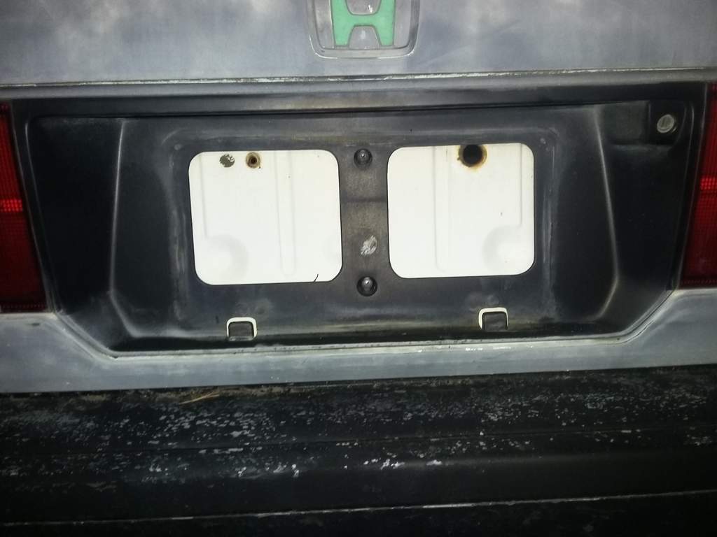

i will try to upload a pic Attachment 7918but i have that garnish unbroken on my parts car lol i guess the south climate saved all the little trim pieces from being destoryed
is that the piece so sought after?
Re: Have a quick question? Ask it here!
Yup. That's the one. I'd be surprised if you have one that's truly not broken. Guard it carefully if you do.

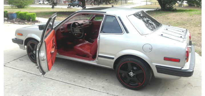

My question is. Where can i find lowering springs for my 1981 Honda Prelude? Ive looked everywhere. Attachment 8080
