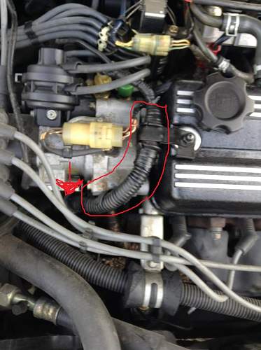

    I have discovered a big oil leak and I believe I have found the source. I don't know what this part is called so I haven't been able to research and figure out a fix. Please someone tell me how to fix this!
    This is the above view

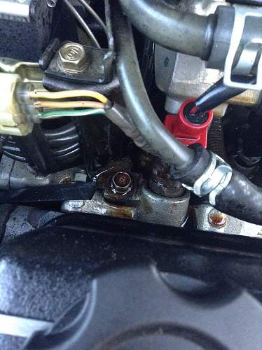

    Here is down into the engine where I believe it is leaking. It is wet with oil and seem loose when I wiggle it.
    I can take more pictures if that would help.

    That is the smallest oil leak ive ever seen.
    The black part you have in red is part of the engine wiring harness. so oil is not coming from that. There really are only three places oil can come from. One is the O-ring around your cam way in the distributor area and 2nd is your valve cover gasket, the 3rd is the three bolts that hold down your valve cover. I would suspect your valve cover gasket or where the valve cover bolt.

    I looked a little harder and it looks like most of the oil is just behind the valve cover
    I just replaced the rubber gasket last week do you think It is the problem?

    There's a good chance the valve cover gasket is leaking if you didn't put RTV in the corners by the cam shaft.

    Check the pcv valve as well, if you have oil on the intake manifold.
    Re: Oil leak - Please Help
    Check your install. Sometimes the gasket gets folded or doesn't seat right. You have a big leak so it should be fairly obvious what's going on when you see it.
