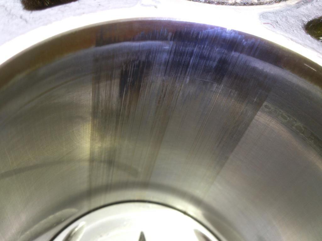

Did this cylinder have coolant in it? From the look of it, it appears to be the top part of the piston scraping the side since the scrape marks go all the way to the top so i wouldn't assume a broken ring or something but again i am no expert.
Edit: Possibly carbon build up and fell into the gap between the piston and cylinder wall scraping it up. What condition were the valves on that cylinder compared to others, how was the spark plug, was the valve lash way off or anything.
Edit 2: I've been reading online and am looking into why you had so much carbon build up, one possibility is detonation which can have several different causes. Quote from enginebuildermag.com article "Detonation can be caused by low octane fuel, over advanced spark timing, a defective or plugged EGR valve, a lean fuel mixture (dirty fuel injectors or a weak fuel pump), a buildup of carbon deposits in the combustion chamber, and engine overheating. Detonation can occur when fuel ignites spontaneously from excessive heat and pressure." Also was that the cylinder with the bad fuel injector?
