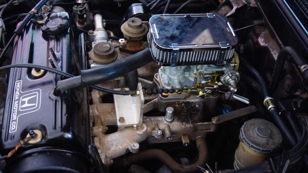

    K728 kit: It looks like the throttle cable is routed to the firewall side, is that correct? That would require tight bends in the cable, it seems pulling from the front like OEM would be much better.
    I've spent hours searching for pictures of a Weber on a 3 gen Accord and have found nothing.

    They make carbs that go either way, throttle on the left or right. The 32/36 I had was a left one so when installed, the throttle cable was on the drivers side.
    As you can see, cable routes to drivers side, fuel line route to pass side.

    You could just flip the carb the other way... I always run mine the other way so the linkage is on the driver's side. Then it'll be pulling from the front of the car.
    Excellent, I couldn't tell from the limited photos and drawings available whether it could be rotated or not. I think the fuel nipple can also be reversed.
    Thanks for posting the photo, there were a a lot of good photos in this thread I remember looking at, it's too bad they're gone.

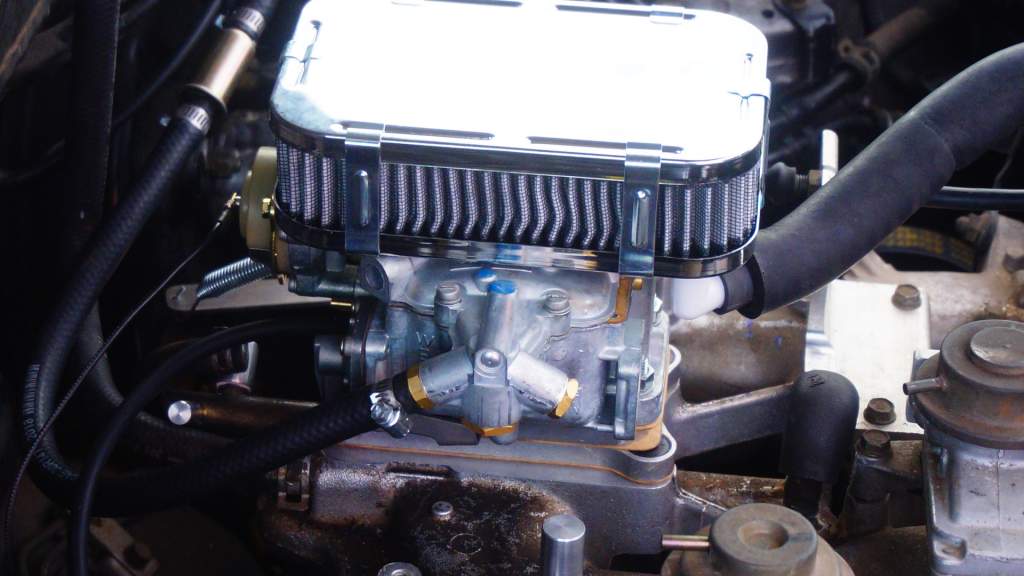

    3rd GEN ACCORD WEBER 32/36 Conversion
    I finished my Weber conversion, pretty cool! An easy job overall with a few snags. I machined a throttle cable mount and a swivel connector to avoid modifying the OEM cable and not use the included cable clamp. I switched the fuel inlet and had to fab a mounting for the safety return spring. I installed all new fuel hose and noticed the steel tube from at the firewall was 5/16" so I bought a fuel filter with 5/16" on both ends and avoided a step down hose coupler. After all that, a few cranks and it was purring like a kitten.
    Removing the old smog crap was cathartic and there is still more crap to remove but I need to know more about the fuel pump and electric choke systems, there is some kind of logic involved there that I don't want so screw up. See obligatory crap removed photo :-)
