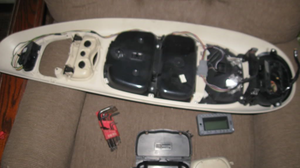

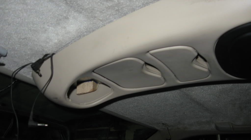

    This is a 2000 Ford Windstar mom mobile overhead console, I took a chance on eyeballing it on ebay for 15 bucks. It was a good deal as they normally go for a lot more. This gives me the neat overhead compartments and a better dome light.

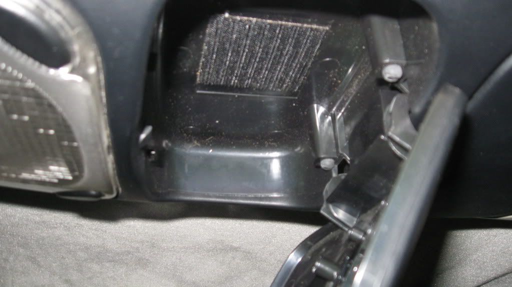

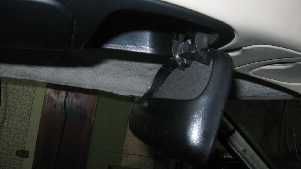

    in the picture I already have one compartment out working on it

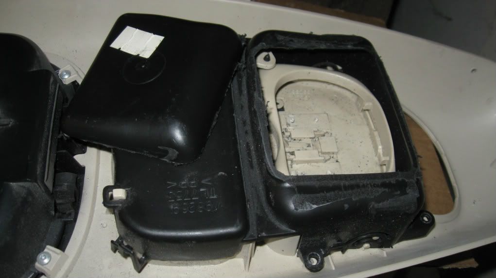

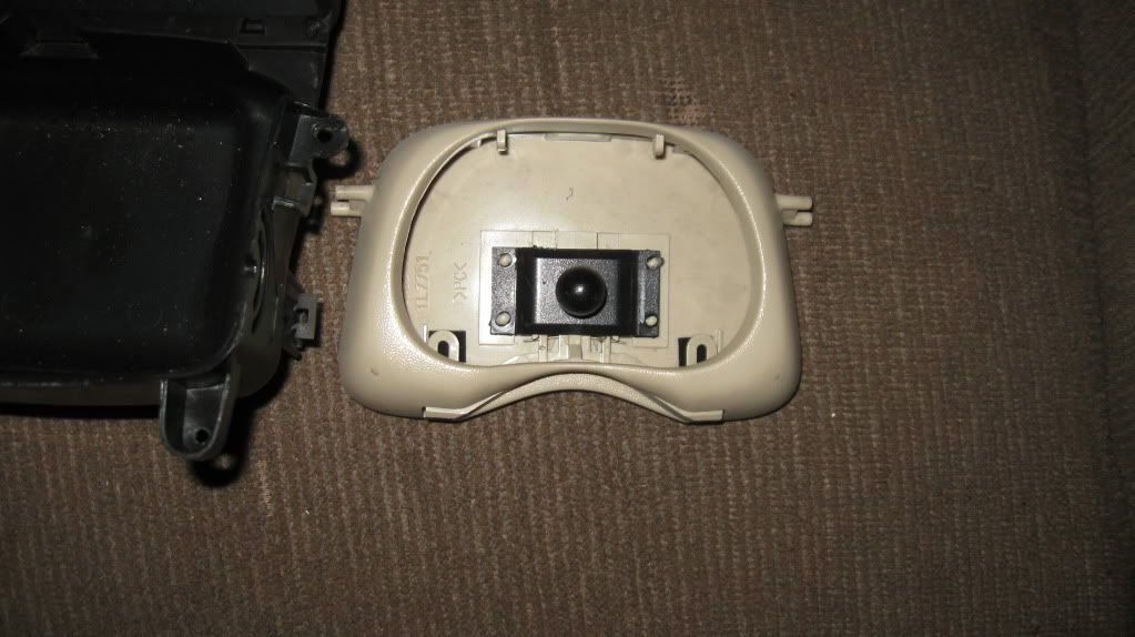

    the first thing I did was remove the compartment with the child surveillance mirror, the mirror itself snaps off, then you are left with the mirror mounting
    it's a simple matter of grinding off the melted plastic rivets and removing the mount

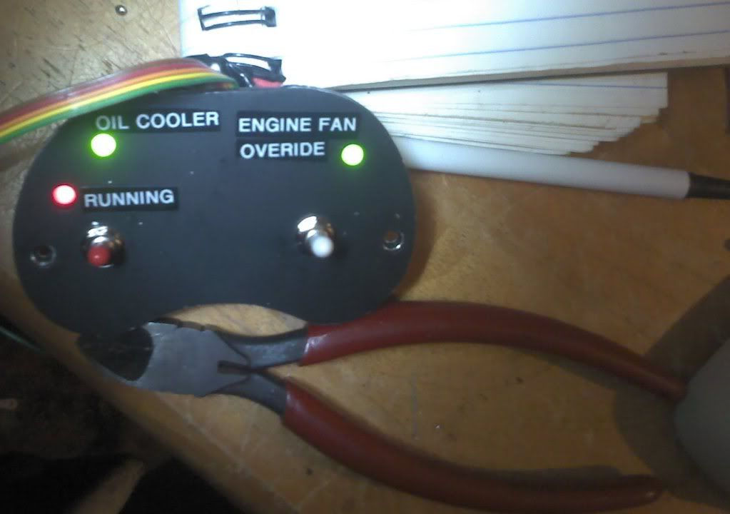

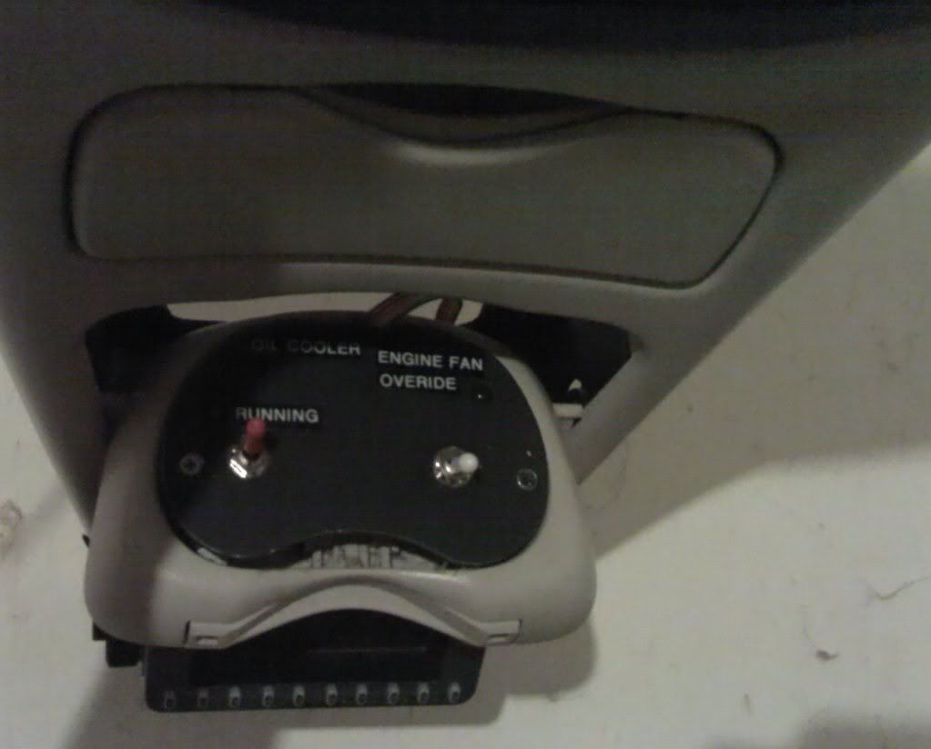

    this compartment will be used to hold my switches for the manual fan override and the oil cooler override
    the only issues I had with clearance were with the top of this compartment,so I gave it a shave
    I'll fit a piece of plastic in there later

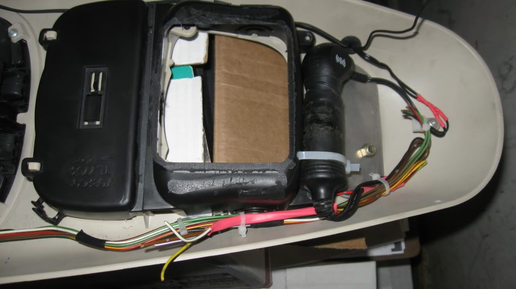

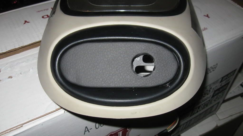

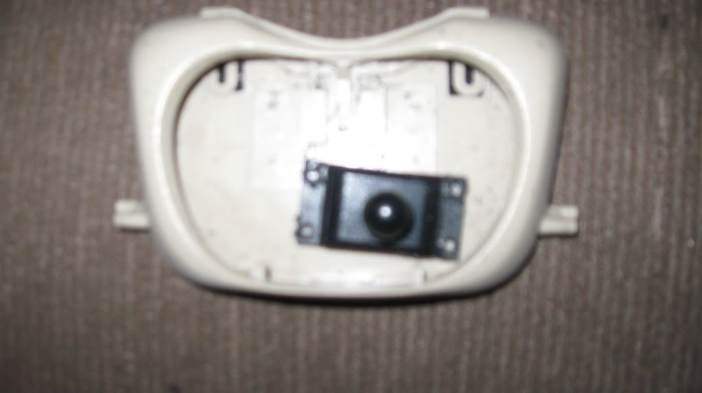

    I had no use for the sliding door switch or the rear radio controls,so out came the switch and the radio circuit board

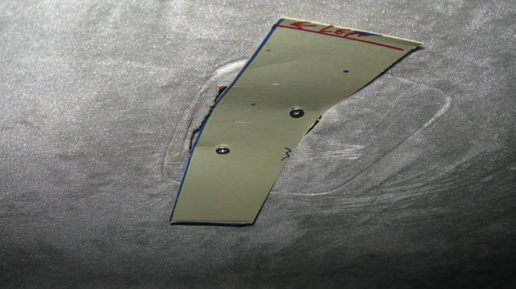

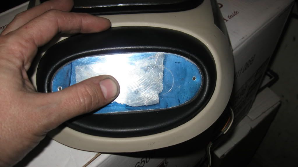

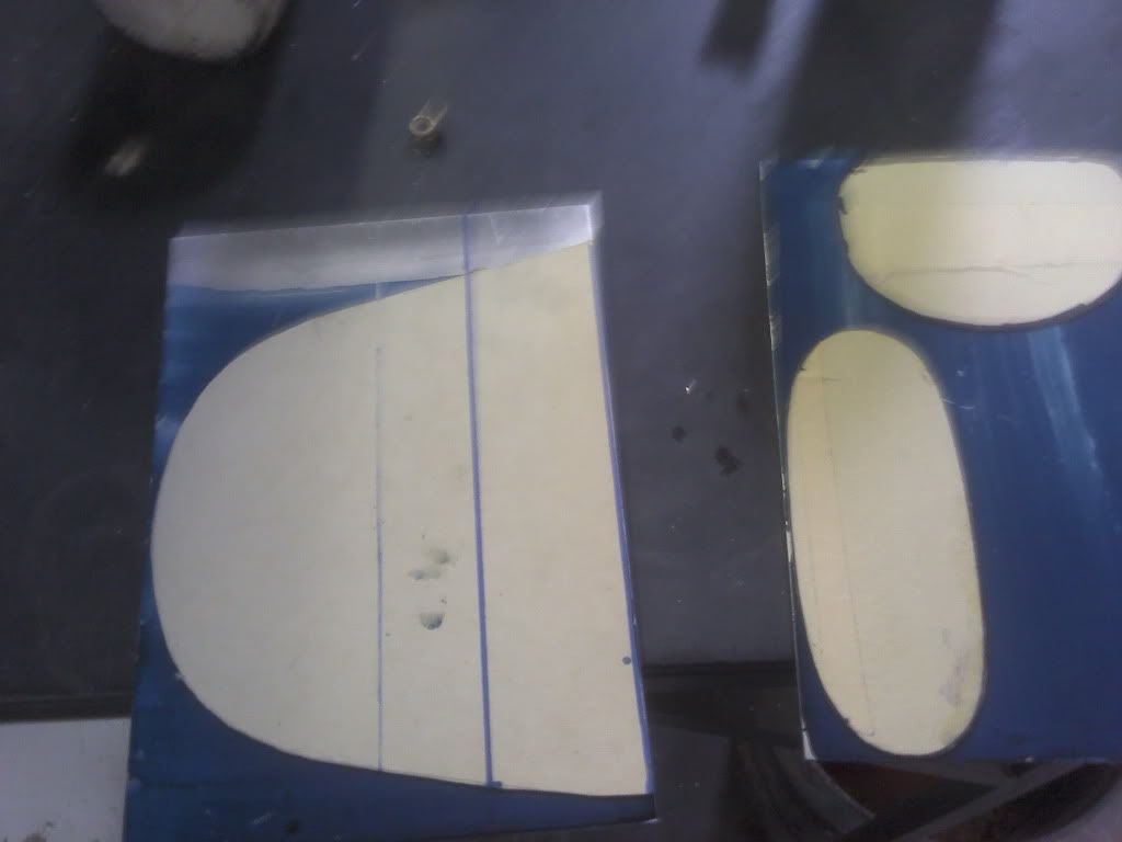

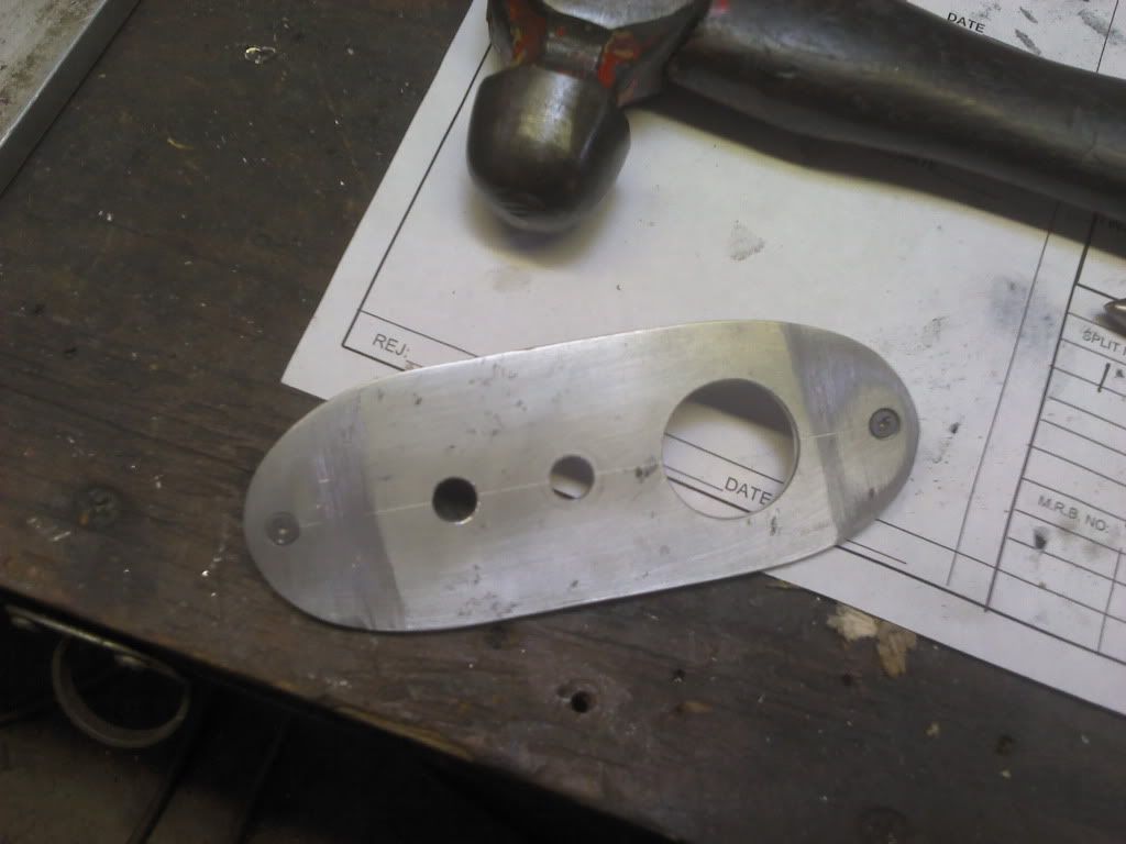

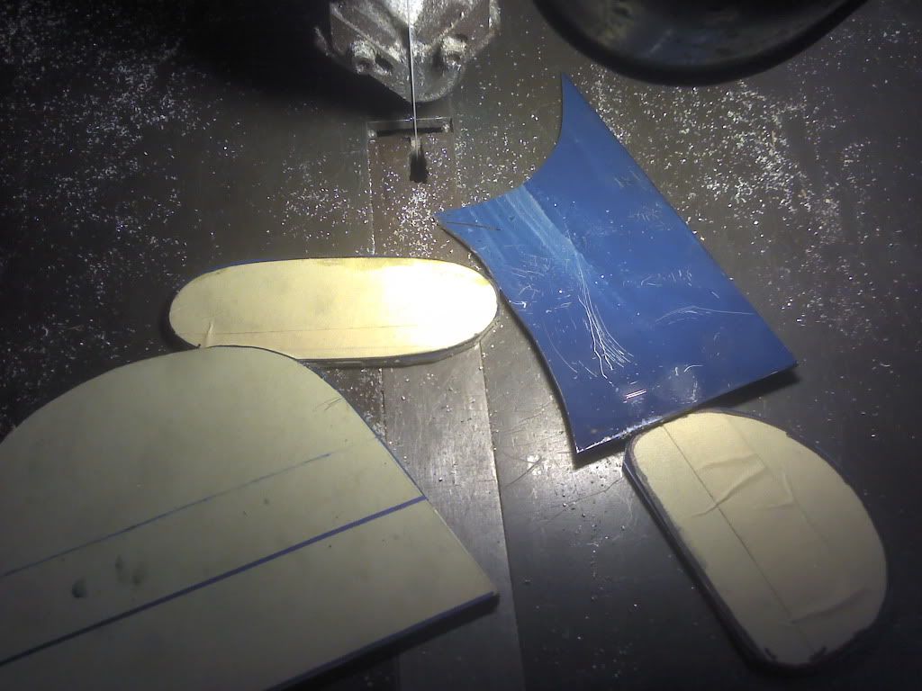

    This is cutting the 1/8 aluminum plate to make the filler panels for those two items, the XM radio box will go where the sliding door switch was,this is also the front mounting bracket plate

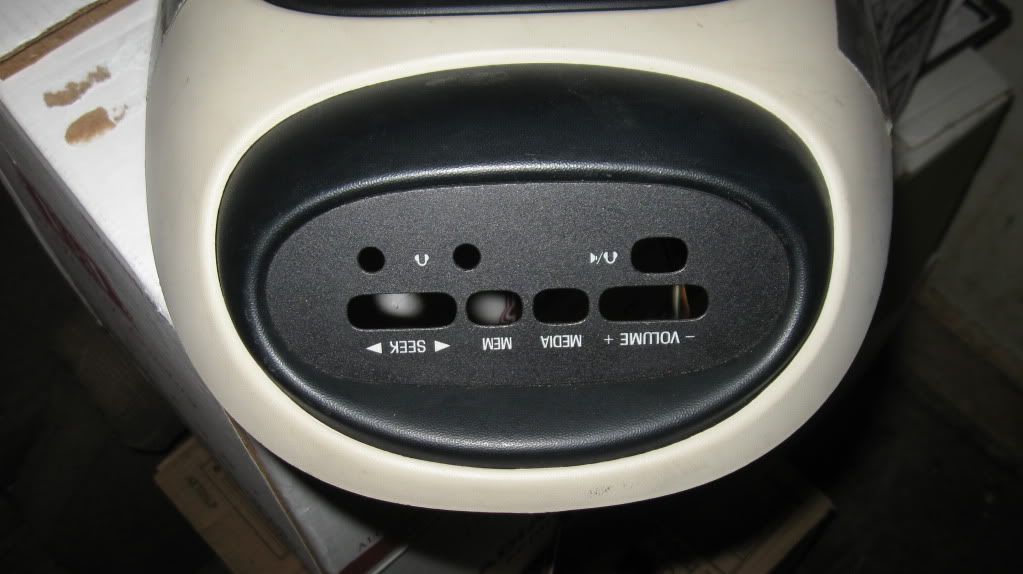

    this is the template used for drilling the holes for the filler panel for the radio controls
    the dremel will soon take care of the pesky radio controls face

    There are two extra 5/16 holes behind the material in case I ever need them for anything

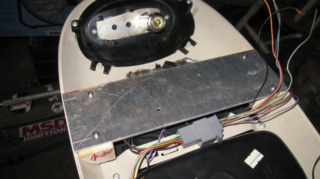

    This is the front mounting bracket
    ignore the wires everywhere,once everything fits, those will be fixed
    making the pattern for the back bracket, I will be making this tomorrow

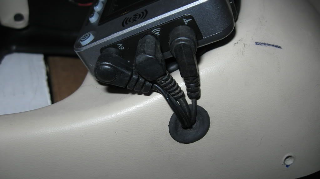

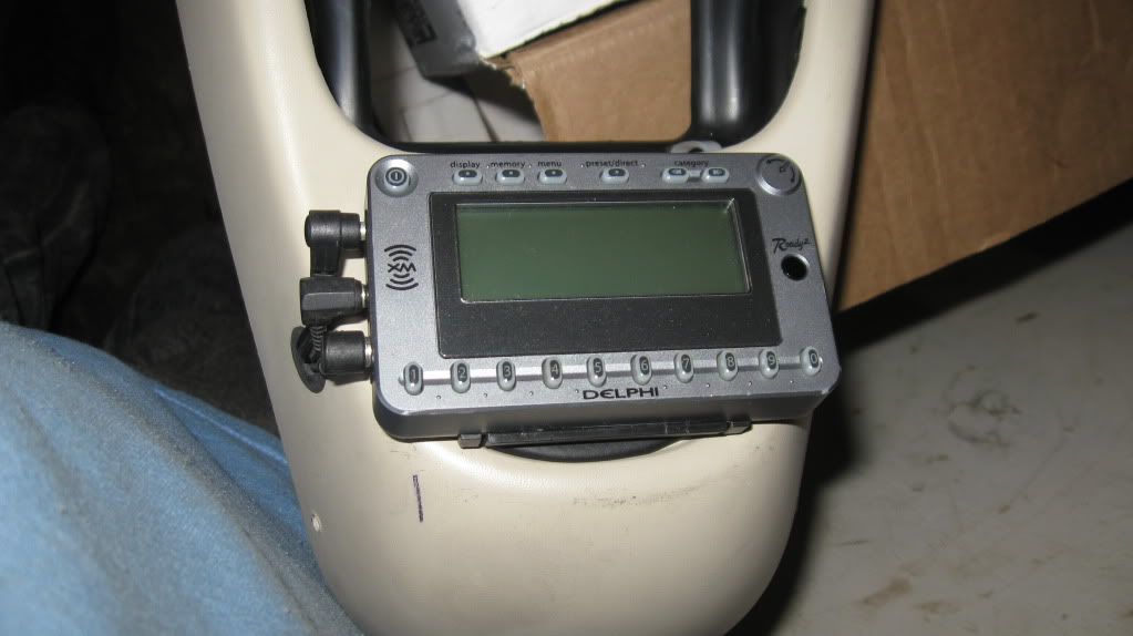

    the XM radio is installed, I got some of the wiring laid out, I still need to figure out the switches and put a plug on for the auto dimming mirror, I'll just run a grommet and run the wires to the mirror.

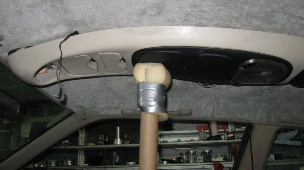

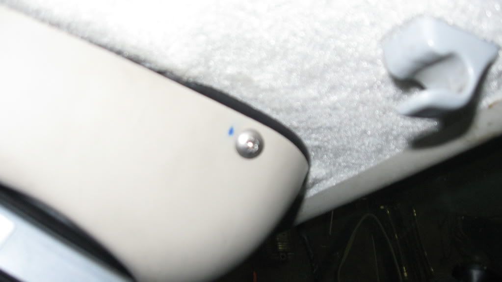

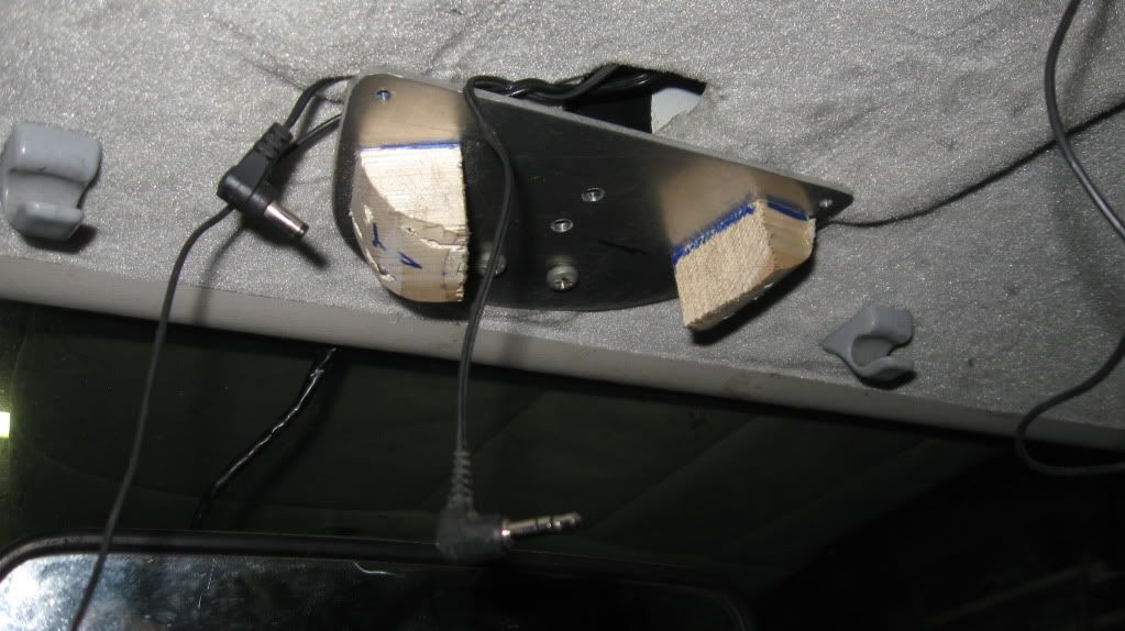

    I had to fix a minor issue, the rear mounting bracket was sitting over the edge of the console, so it was visible, I had to mill the wooden blocks down about 1/8 of an inch, then shear some material off of the aluminum plate on both ends, then the plate hit the lights, so it required cutting some material off of the plate. It sounds simple, but it involved a lot of running between the shear, the belt sander, the mill, and screwing in and removing the screws over and over. now the front bracket is off a bit, but I'm working on it.
    this is the bracket before

    Legit as fuck. The curvature of the roof worked with the curvature of the unit?

    I have an LX-i without a sunroof.

    it's very very close, the small gaps can be fixed by simply putting some foam under the area of the console, I don't know if the roof on an lxi is the same, the hatch roof is different then the other models, except maby the coupe, I know they share the same floor pans, but I'm not sure about the roof

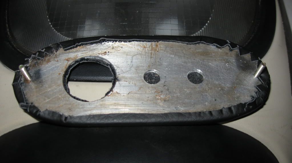

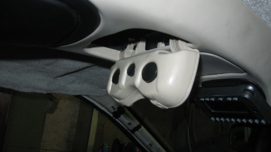

    I ended up upholstering the front bracket, since it's visible, the wood blocks didn't hold up being removed about 20 times, so I made aluminum blocks with threaded holes.
    I think the small gaps on the sides may be parts of the console pushing the headliner up, i need to mask around it and trim the headliner under the console. the other areas just need a little foam under the headliner

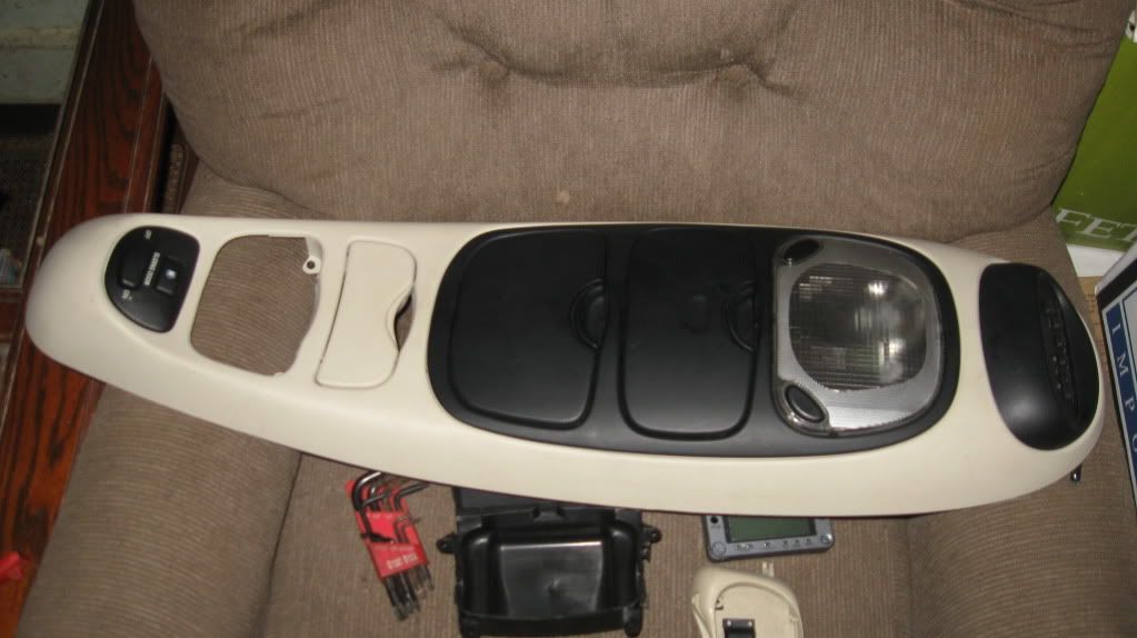

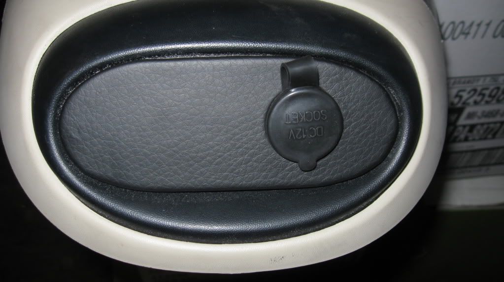

    sunglasses holder
    change holder
    empty compartment, this is where I'm thinking of putting a fuse block

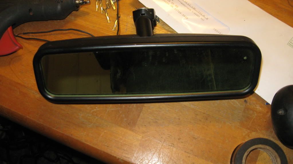

    this is the gentex photo chromatic mirror thats going in
    console harness

    I have two brackets, one attaches to the threaded holes for the OEM light, the front bracket uses the threaded holes for the original mirror, the rear one have wood blocks, that I shaped to match the sides of the console, they screw to the plate that is attached to the original mounting points. self tapping screws attach the sides of the console to the blocks, just like in a conversion van. the front is aluminum pieces that are tapped for machine screws

    thats the front before I changed to aluminum blocks, the edge of the plate was visible so I wrapped it in black imitation leather, there was a very slight gap near the front so i added a little padding behind the headliner to fill it in
