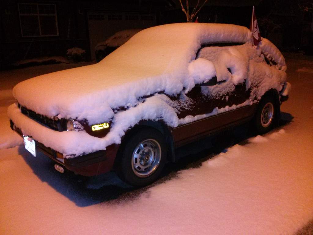

    Minus 5 Celcius in Abbotsford BC last Christmas.... Goes great in the snow... almost too much fun

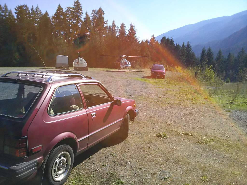

    Plus 35 Celcius at work north of Hope, BC = Boston Bar, BC ... Didn't like the heat as much as the cold!

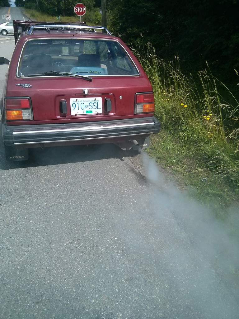

    blowing steam out the back side! yikes... need gasket... but where??

    Don't quote me on this but I am going to guess that it is a head gasket. It could be something else though. What does that smoke smell like, burning oil/coolant?
    Aug 2014
    18
    Re: new here!
    Head gasket checked and done. Smells of coolant. definitely steam.
