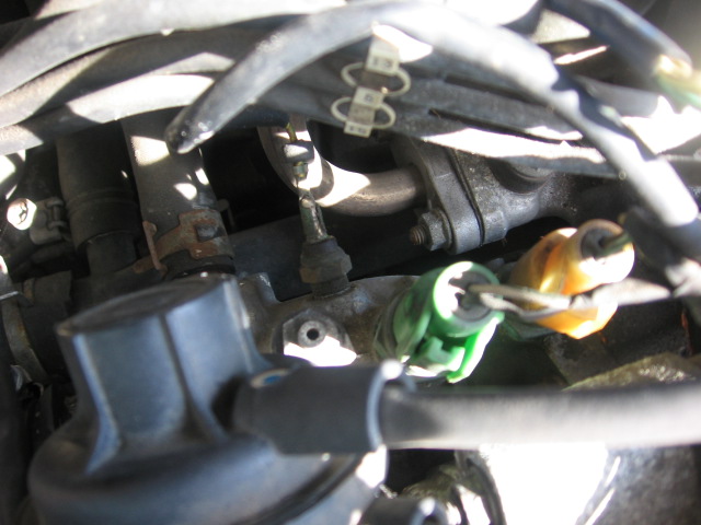

    This is interesting, I was reading the engine code check post in the How-To section and noticed that not all 3Geez are the same. https://www.3geez.com/forum/how/81283...odes-pics.html. 89 LXi has a different TW Sensor. Check the pic attached to the Code #6 section taken by ShyBoyCA6. I think that's an 89 in the picture.
    So here's mine: 87 LXi - I've never messed with these before but maybe a previous owner had?

    Well ok here is mine. 1988 3 door accord lxi. its a J code car build date 1987.
    Looks opposite?

    It looks like the tabs on your sensors are both on the same side. Can you confirm that? I am starting to think it might be a pre/post-facelift thing.

    Quote Originally Posted by niles View Post
    I think it is. The early FI cars where a little different than the later ones.
    I would go by the wiring. I see 2 wires on my plug on the left.
    Ill get some pics tomorrow I am a bit down on a sore neck and just come from the chiropractor.

    Thanks for your help oldblue. I was able to at least confirm which is which. Only one sensor will trigger the code 6, and for me its the SU410 sensor.
    My sensor wire colors:
    TW Sensor: green/white stripe and yellow/green stripe
    Cooling Fan Sensor: white/green stripe and black
