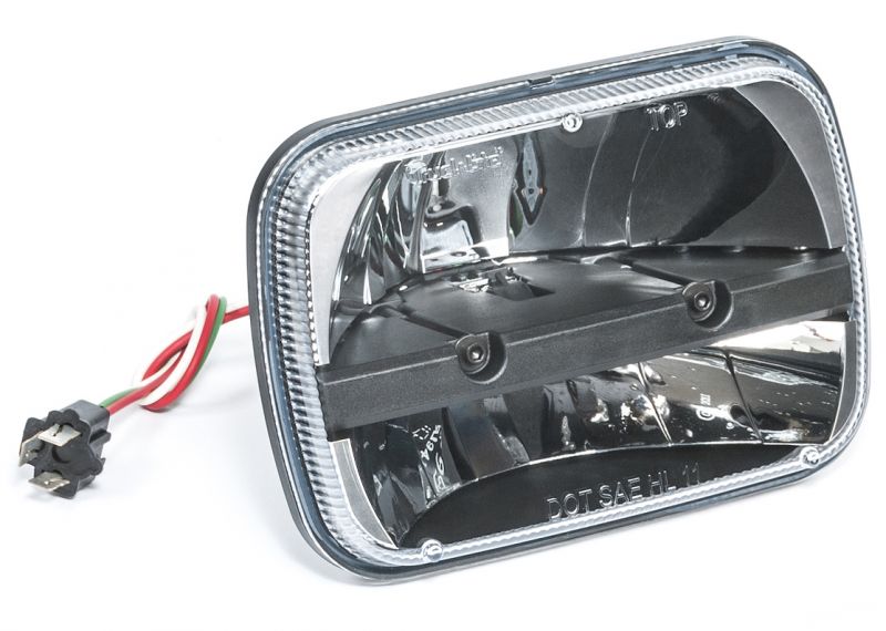

    Holy Shnikeys! Someone other than me finally found them. I was literally fixing to start a post about them! You beat me by 3 days!
    I've been eyeballing JW Speakers LED headlights since last tax return. They're nearly twice the price of the Truck-Lite headlights...and look alittle uglier...
    JW Speaker Part 0550071 - Evolution 8900 LED Headlight - Fits 1987 to 1995 YJ Wrangler - 4 Wheel Drive
    Anyone running a set yet?

    There is also a GE Nighthawk product that comes in a 6054 LED format and it looks exactly like the Trucklite model. I think there may be some re-branding involved, and if so - then we should be able to find them cheaper from the source (probably Chinese).
    LED Headlights | LED Headlamps | Nighthawk LED | GE Lighting North America

    Since these cars do not have advanced lighting systems, how do you know the electrical system can produce the correct amount of power for the LED's to shine at the correct intensity? Consistency?

    Re: LED headlight drop ins
    I'm sure these lights have built in drivers powering the LED. Its not going to be directly powered by the charging system like a headlight.

    here are the watson streetworks ones, they got good reviews LED Headlights

    The Watson Lights are just an Autopal brand housing with a LED H4 retrofit installed. I'm sure the light pattern isn't that great with those.
