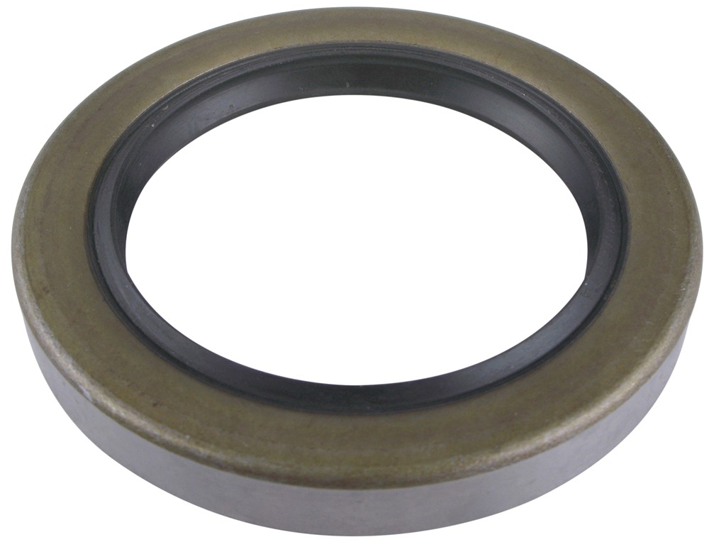

    Re: power steering pump seal not available
    I wouldn't worry too much about the aftermarket seal. If the old and new look the same, you'll be fine.
    I had Napa try to give me some really squirrelly seals once. They looked like this:
    When Honda's seals looked like this:
    I gave the counter guy the stink eye and he sheepishly replaced them with the proper seals.
