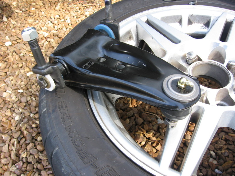

    I have not had any luck with boots either. Like you said they split within a year or less. I have been changing them out with the HELP section ones but I don't think they last either.I tried the Honda factory ones as well. Now on my IH scout I prolly got grease boots on there from the 70's. So go figure.
    You might want to try tapping the joint for a grease fitting. Its pretty easy and beats changing the joint every year. I have a couple years on mine already and they pass my spring ops checks a few weeks ago.
