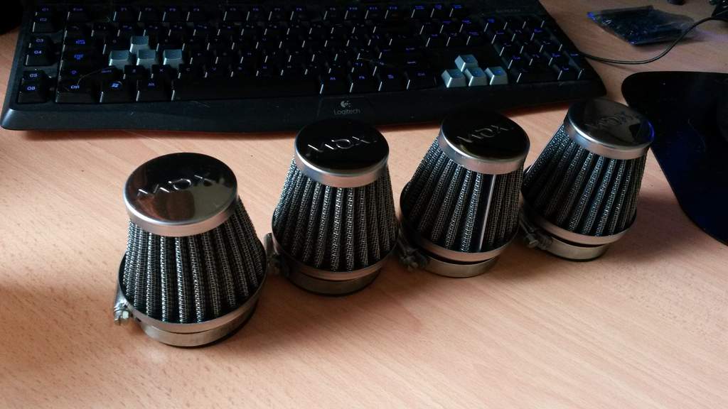

    Filters were here last week and I've spent countless amount of time figuring out why it's acting like it's lean on WOT near the redline
    Searching around and I found mixed opinion about pod filters and CV carbs not liking them and how they would never run right with them. Except why would mine be running fine without them and starts leaning out and spitting through the carbs near redline with the filters on???

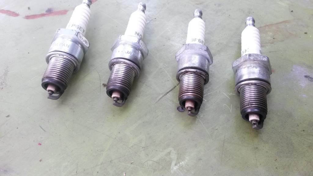

    My plugs look good though. #4 on the far right is a bit lean but I blame my vacuum taps. I'll get that sorted out too. Can't run on WOT long enough to see what's the WOT mixture looks like
