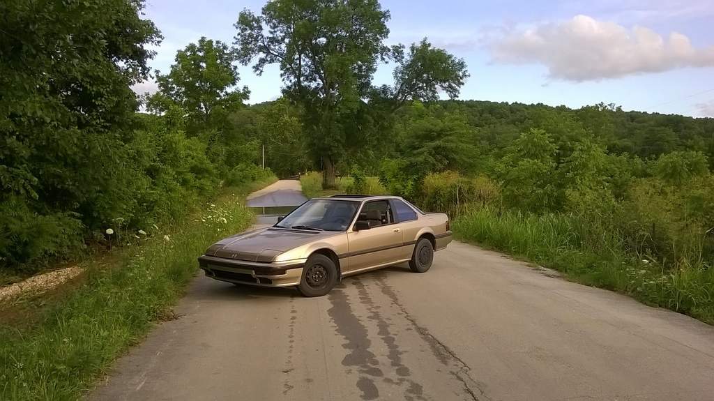

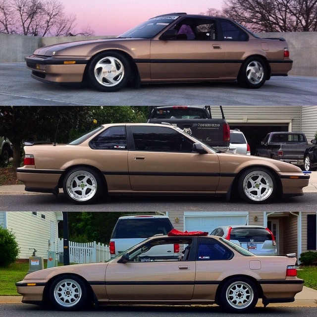

ID:	7053 here it is!
    This is what I'm going forClick image for larger version.
