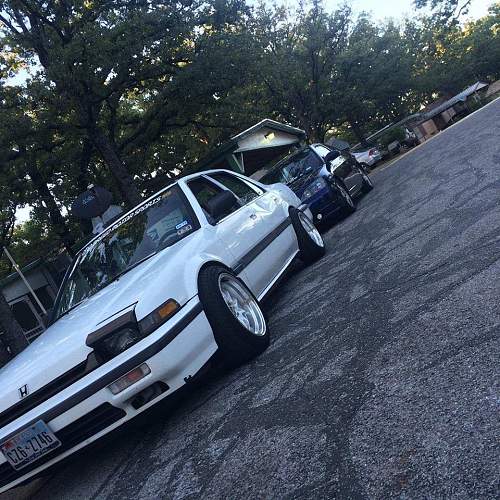

    I was thinking about getting them (and replacing the struts back to the original ones) because I just picked this 1988 accord lx sedan and its got eg rear struts in it now with ebay coil sleeves and chopped front springs... Not a fan of the ride quality right now...Click image for larger version.
