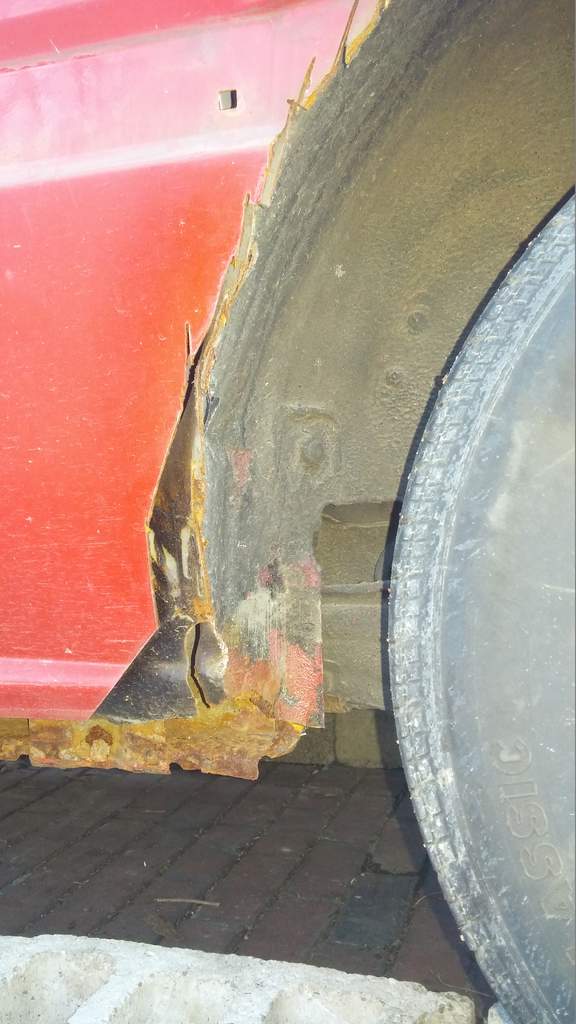

    Re: rocker & quarter repair
    Here are a couple pics of the car as it sits now in my back alley.
    In looking for parts recently I came across talk of both "outer" and "inner" rocker panels. I didn't know they existed separately; however in the third pic I think I can see them (two separate sheets of metal, both outboard of the jack support). So when folks talk of replacing "rocker panels", what is generally meant by that - just the outer, or both?
    (I've also asked more about this in an earlier post.)
    Any further insight from experienced body folks will be appreciated!
    oo yah thats gonna need some time with the saw and grinder. I have those patch panels from mill supply, they appear to be decent gauge metal and all. They were available many years ago when i worked on my gold hatch. They are better now with the ordering system, just check the tins when they arrive for any damage. Your going to need to find a donor for a bunch of the metal to make life a bit easier.
    in regards to the 1/4 panel, usually when people talk about replacing a 1/4 it means the outer shell unless the inner 1/4 or inner structure needs replacement as well. The arch patch panel will be an easier job than the rocker as it looks pretty corroded.
    As Snooz mentioned, welding is the way to go on this, rivits will hold but not all that long. Many guys that do not have access to a pinch welder also use plug welds as an acceptable re-work. If access to a welder is out of the question, you may want to see how much a local shop would charge for the metal/ welding work and save money by doing all paint prep work yourself if the overall plan is to get it re-sprayed. You may also want to look into some of the 3M structural adhesives, i do not have personal experience with that material. I have seen it used in newer repairs and the assembly of certian uni-bodies.

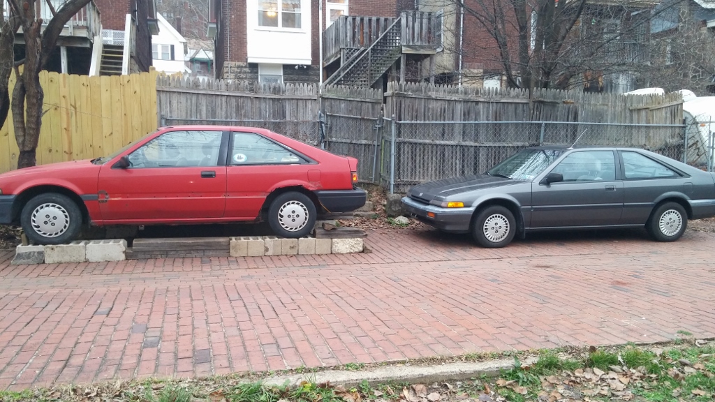

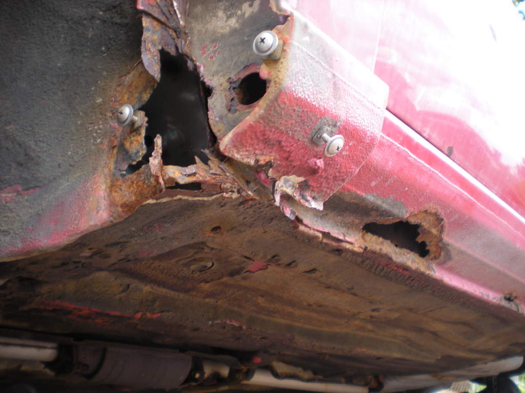

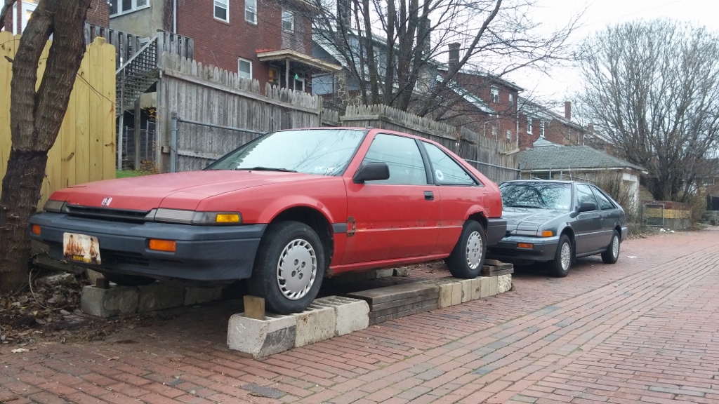

    Here is long-delayed follow-up to my Oct 2 post. A couple general pics showing both cars - the old red '88, which is the reason I started this thread, and the “newer" '87, which I bought from another forum member. That one - the grey 87 - is in great shape and is now my daily driver. The other pics are of the current condition of the ‘88. It no longer passes state inspection. Am almost, but not quite, ready to give up on it. Here’s where I stand now:
    As mentioned in October, I got good replacement rockers and driver's door. However, all but one local body shop said $1000-1200 just to cut & weld on the new metal (with me doing more prep + everything after.) I am inclined to think that's not cost-effective. All are full-service body shops & don’t seem willing to go below insurance-quality, "like new" standards. I'd still be happy to pay somebody more like 500 to do just the actual cutting & welding - somebody who knows what they're doing, but who is willing to do a rougher job on this older vehicle. I know of one such place but they say they’re not interested.
    Other options: 1) keep the 88 just for parts for the other one; 2) fix the '88 with POR-15, lots of filler, maybe some sandblasting; 3) try welding myself (despite previously-described objections).
    This is where you all come in. See pics below and separate posts. Any comments/recommendations? The car has been started & driven occasionally through the winter. Body work remains only obstacle to getting it back on the road. Am interested to hear anything further anyone may have to say. Thanks for reading.

    Here are detailed pics of rocker panel that go along with text posted a few minutes ago.

    If that red car has the black or gray black interior thats a pretty sought after item IMHO. Might be worth something to sell. Very unusually color combo.
    My question is what makes it fail inspection in PA? My guess is rust through make it fail?
    Does the E brake and all the other safety stuff pass as well. All that could add up.
    That being said I really feel older Japan cars are the next hot thing so some investment is not that crazy an idea.

    like snooz said you might want to befriend autobody guys. From the pictures you posted it looks like a decent amount of work there. The arches through mill supply will help out as you posted, I used them for my hatch and they are ok. Rockers your gonna have to dig around, i've seen one or two places that had listed rockers for a coupe and for a sedan, I don"t remember who it was tho. however i'm worried that the inner structure is gone. I really think best bet is either to abandon the chassis, or if willing to go this route, get a donor to cut up.
