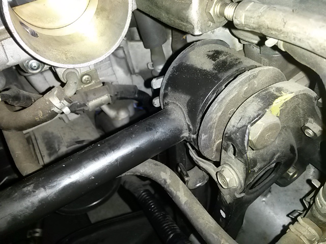

    Got around to replacing the front torque strut bushing on the dog-bone. Photos below. I ended up taking the dog-bone out to replace the one bushing in front (bigger one) after install Torque spec'd both 19mm bolts to 54 ft.lbs. per spec.
    before
    Part number from Oriley's
    Bushing Installed
    Air tube installed
    Air intake reinstalled
