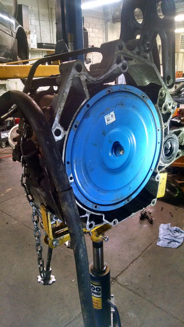

    Sweet Flexplate!
    In all her (500 pound) glory. 10,000 miles on the torque converter and starter

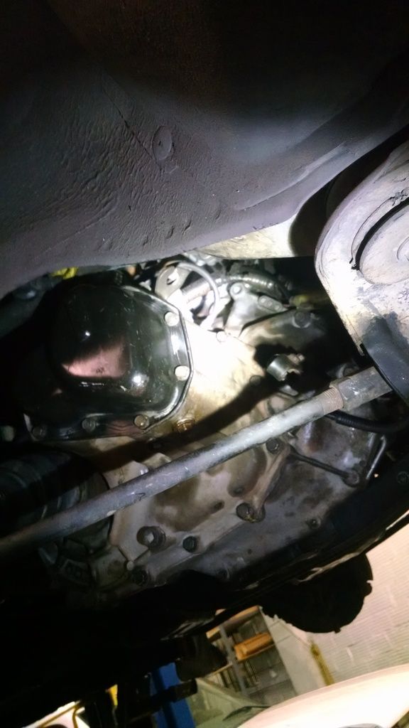

    5 Speed in after re-ground flywheel and clutch kit. So much space! Much lighter too, I can pick that thing up no problem
