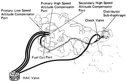

    Some one pointed me in this direction:
    Is this accurate info? Where some models equipped with this unit?
    If it doesn't have the 'ABC' altitude compensator it'll never run right up there. Go pull one from a junk yard. It's a little plastic deal with three adjustments (air leaks) labeled ABC and just plugs into four ports on the car. Easy peasy. Like this but not this.

    Does anyone have instructions for testing the altitude compensator?
    Re: Carb tuning for high altitude.
    Download the manual if you haven't: https://www.dropbox.com/sh/vtyhl48z5...udl0xk_Oa?dl=0
    According to the chart on p. 11-16 of the '89 USDM manual, these cars came with two carbs: California... and everyone else. What you have should be sufficient for where you live, so I'm inclined to believe that you only need to troubleshoot, instead of looking for a different system. The carburetor is discussed in detail in chapter 11 of the manual, so have a look there. There are Symptom-to-System diagnostic charts and extensive troubleshooting flowcharts. You have a myriad of little controls, solenoids, vacuum actuators and the like that combine to make the car run optimally. At this age, they tend to have difficulties, so start by reading up and testing them according to the instructions in the manual. You'll probably be running good in no time.
    Let us know what you learn.
