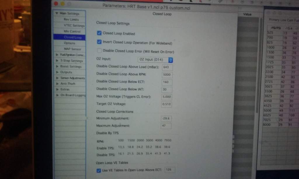

    Here's my O2 settings Neptune don't know if I have them right yet
ID:	8259   Click image for larger version.

    Now that the car is running pretty good but at idle the gauge is everywhere on the air fuel ratio. Any ideas? do I need to change the way it's powered right now it's powered from pin A25 on the obd1 ECU . And the yellow wire hooked up to pin D14
    Are you using the wideband as your only O2 sensor. So your trying to simulate the narrow band output im am guessing?
    Not sure about this the setting have got to be on the internets someplace.
    if your really lean like you showed the AFR will be inaccurate or all over the place. The closer you get to 14.7 steady state the easier it is to tune.
    You got your fuel pressure steady like at 40 psi. Thats a pretty good base pressure on a Honda. Unless you got some kinda crazy injector set up.

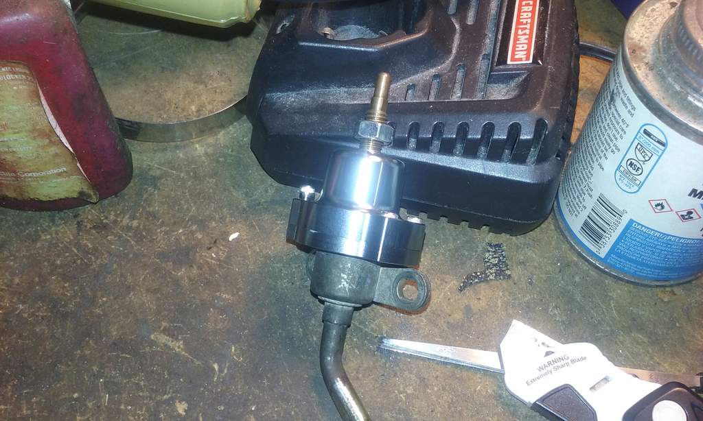

    I installed adjustable fuel pressure regulator. Bumped it up from 38 to 40 the car is running better and better everyday
ID:	8275   Click image for larger version.
    Higher the fuel pressure the better the spray pattern.
