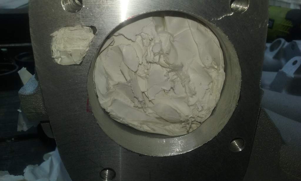

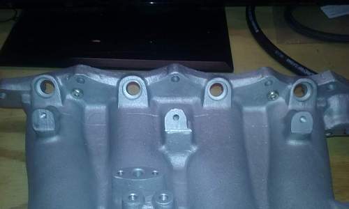

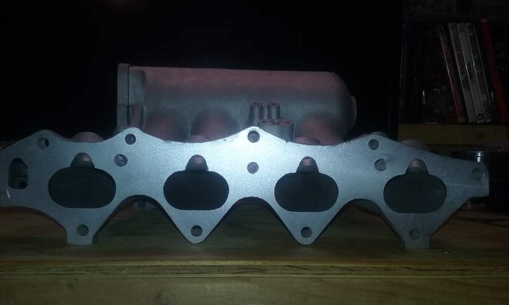

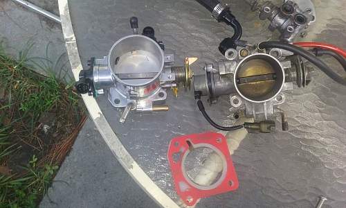

    worked on preparing the intake manifold today.got the throttle body Port matched.two holes drilled ran out of cutting wheels still got a little cleaning up on the flange to do to be continued.Click image for larger version.

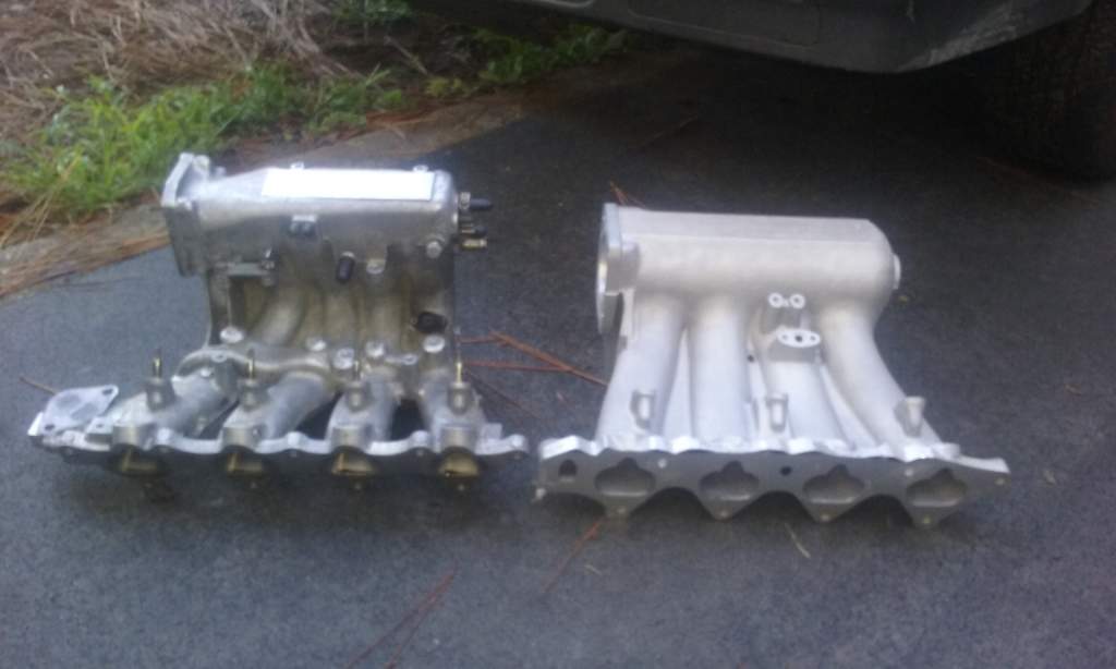

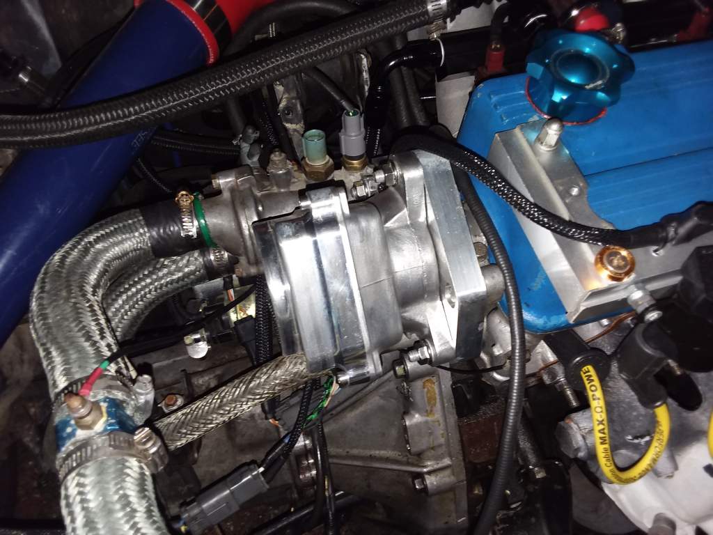

ID:	8932 got the intake manifold installed and it's running I should have did this upgrade a long time ago

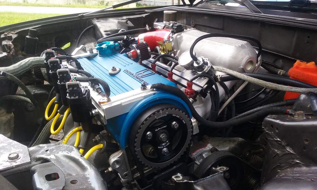

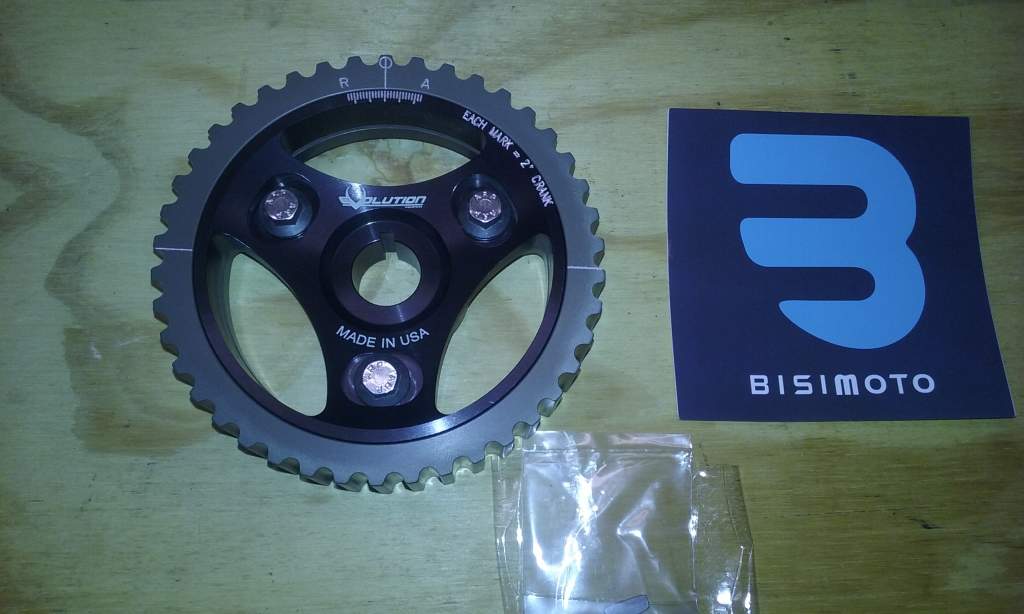

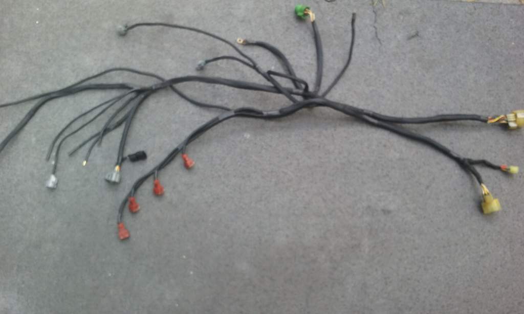

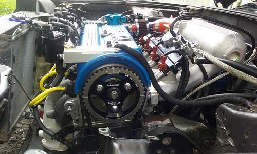

    decided it was time to pull my engine harness and completely rebuild it and my cam gear came in todayClick image for larger version.
ID:	8958Click image for larger version.

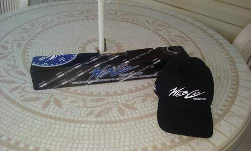

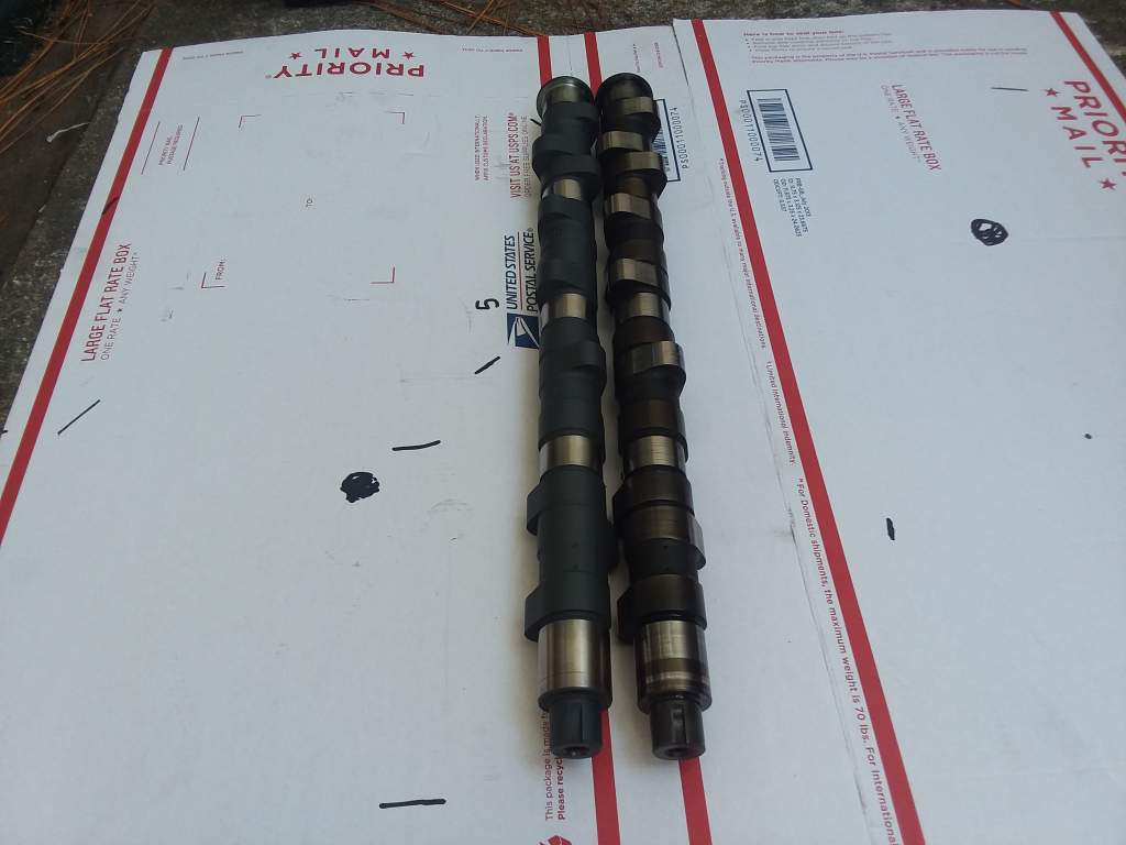

    Received my mild Street turbo cam today. I don't know if anybody knew to check the clearance section and yes I know I could have saved 80 bucks purchasing from Delta but you know oh wellClick image for larger version.

    Is that what that was? the girl on the phone couldn't give me any real info. just duration and cam lift without rocker ratio and I've not been able to be 100% sure what that is so i can compare cams.
    Why are all these camshaft people's website such ass :/
    Can you post the spec sheet for it?
  13. #388
    SEi User Shane86's Avatar
    Feb 2016
    Florida
    1,016
    Quote Originally Posted by night View Post
    they had two different ones to pick from and the one I got was recommended for Mild Street or Turbo application. I requested a timing card but never received one the way they were keeping it secret makes me think it might be a bisimoto 1.2 turbo cam. We will see. they couldn't give me too much information on it either other that it's like a stock cam but .020 more lift on the intake side with 6 degrees duration and .029 more lift and 10 degrees on the exhaust side.
  14. #389
    5,323
    You can get a degree wheel and run it around and plot it your self. Just needs to be installed. I m sure there some vids on "how to degree in a cam" or find the center line.
  15. #390
    '85 lude
    houston
    524
    These are the numbers she gave me on those 2 cams a month ago..
    277in / 290ex - 226/240 dur
    277in / 277ex - 240/240 dur
    Except my stock cam i measured at 269 lift so i didn't see the point.

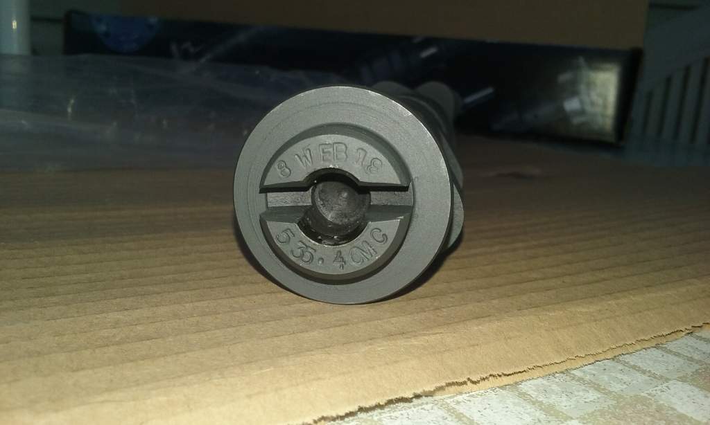

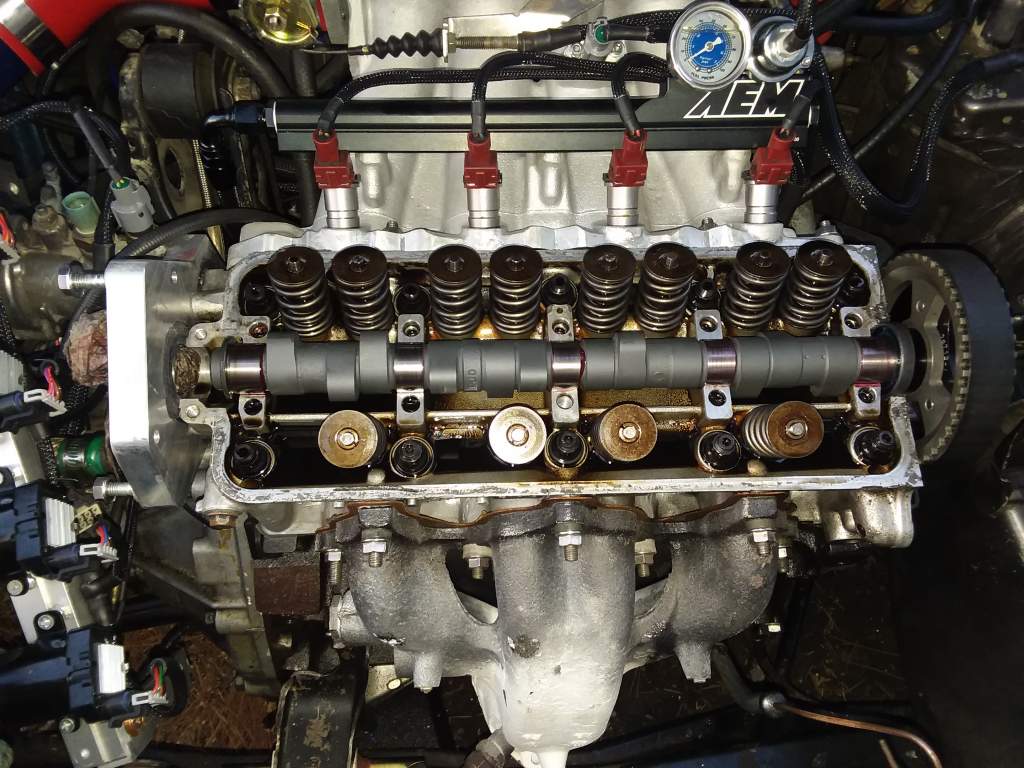

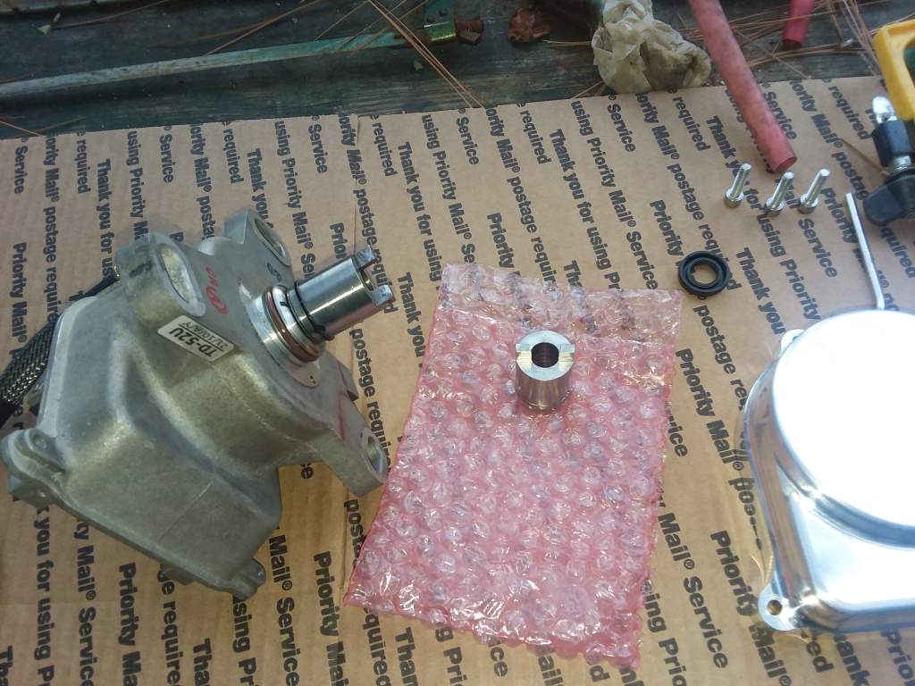

    Swapped in the new cam got my distributor key replacement and replace the distributor o-ring and cleaned it up a little bitClick image for larger version.
ID:	9042Click image for larger version.
ID:	9043Click image for larger version.
ID:	9044Click image for larger version.
ID:	9045Click image for larger version.

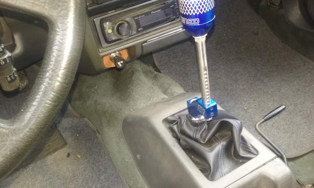

    Finally received my Cheddars Auto shifter bushings and Birdcage bushing. And it sure does make a big difference replacing them old wore-out bushings.https://m.imgur.com/a/5ISeWtz

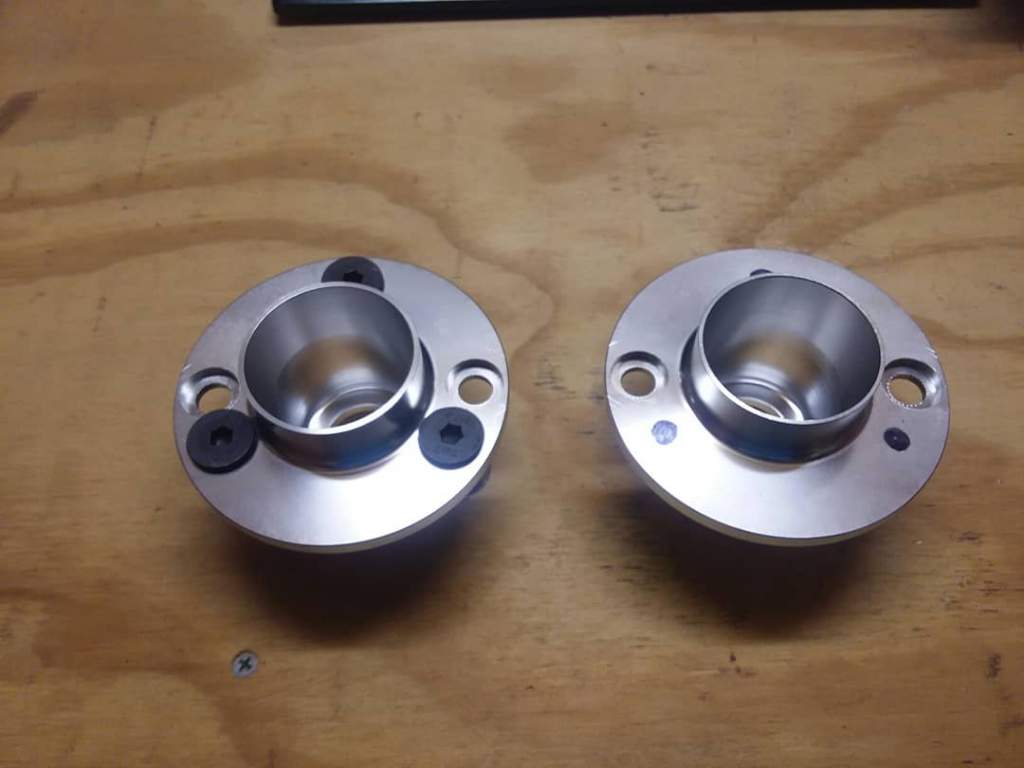

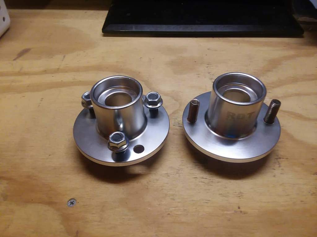

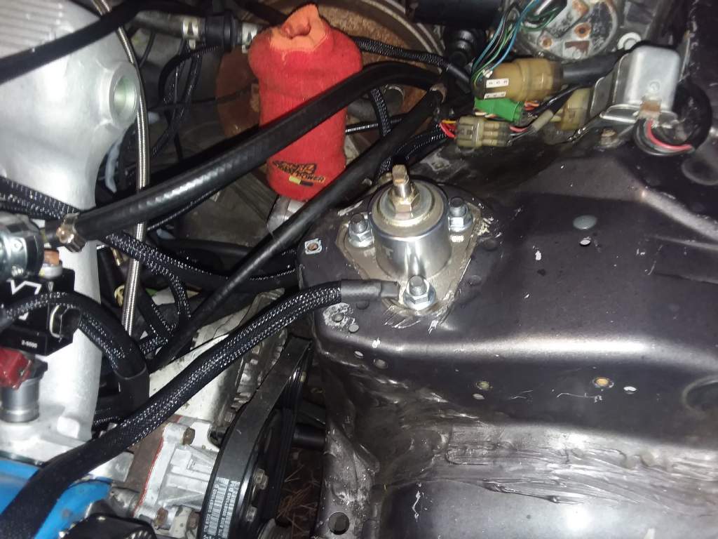

    Starting to work on the suspension went ahead and modify these Honda Civic top hats added grade 12.5 studs and redrilled Click image for larger version.
ID:	9125 Click image for larger version.
ID:	9126 Click image for larger version.
    Niiiiiiiiiiiiiiiice, saving that tip for later!

    Quote Originally Posted by B0CKS View Post
    Yeah man for 42 bucks for everything. I'm pretty happy how they turned out Click image for larger version.

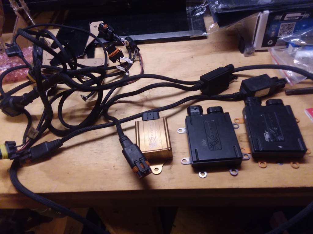

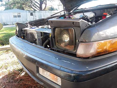

    Retrofit lights Click image for larger version.
ID:	9153 Click image for larger version.
ID:	9154 Click image for larger version.
ID:	9155 Click image for larger version.

    how low is your car that you need top hats
  25. #400
    Feb 2016
    Florida
    1,016
    Only a couple inches the top hats save the shocks by preventing them from bottoming out allowing the shock body to travel inside the top hat
