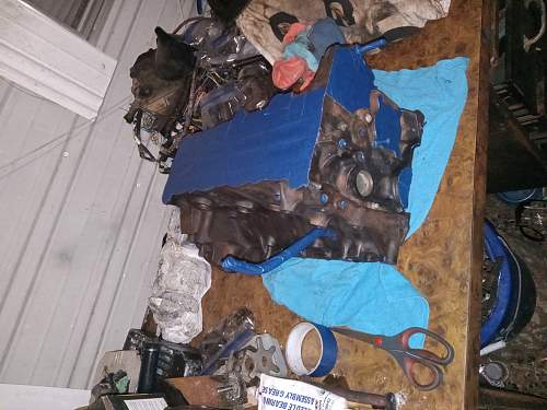

    Decrease the block honed the cylinders prepped ready for primer and paint.

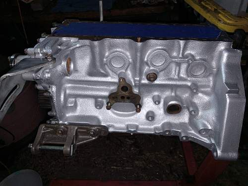

    Blocks painted starting to reassemble

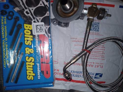

    Turbo feed and oil pan prepped. Getting closer and closer
    And Copperhead gasket

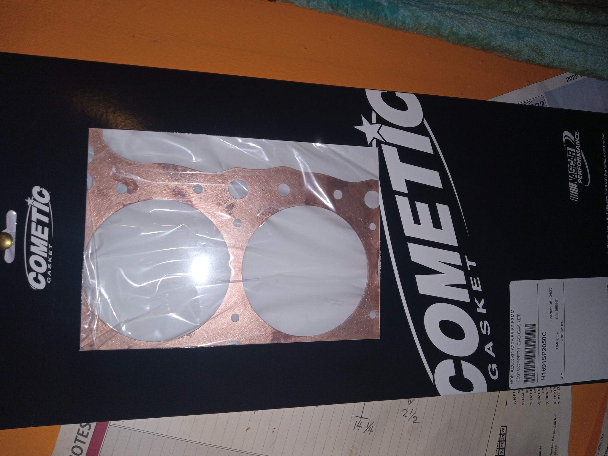

    And here's my YouTube channel if you haven't already subscribed.
    https://youtu.be/z3HLrjR_NsA
    Last edited by Oldblueaccord; 04-30-2023 at 06:39 PM. Reason: imbedded video make it pro like
  10. #560
    5,315

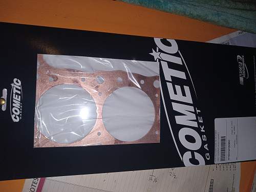

    A20 copper head gasket? NAW NAW....when this come out?
  11. #561
    SEi User Shane86's Avatar
    Feb 2016
    Florida
    1,016
    You can go to the website and search a20a3 and it's in there you can order them

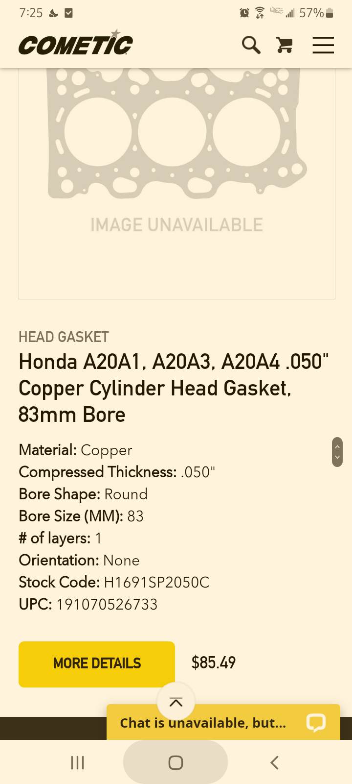

  13. #563
    5,315
    Some one with a turbo needs one I cant remember at this point...I didnt think they would make them.
  14. #564
    SEi User obd0driver's Avatar
    Feb 2012
    89/accord/lxi
    1,046
    That's was me or t89. The problem we have is the bore size. They didn't make 84mm ones a while ago and a MLS is what I was after.
    Sent from my SM-N986U using Tapatalk
  15. #565
    5,315
    Ah ok there you go...understood.
