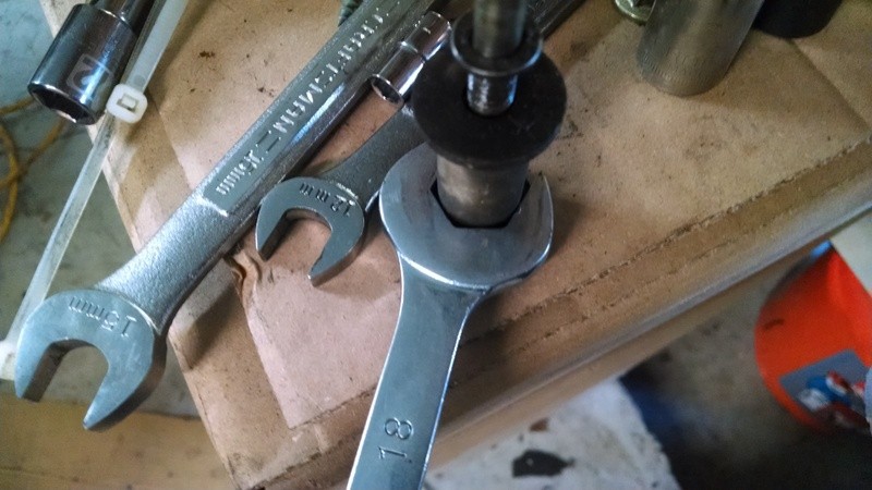

    Pretty sure this is the one he means. I just made one out of nylon. Tighter fit than the Honda original.

    Yes sir. Thats what I'm after. I'll probably just make my own nylon ones too. Cheaper and easier.

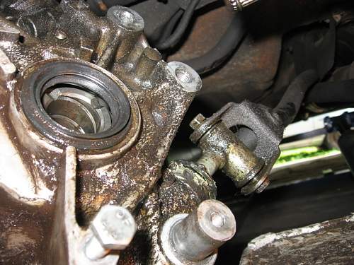

    2 more pics might help. Sorry my digital mics are out of commission i lost the battery cover somehow.
    Diameter needs to be close its just under 18mm. and a tight hole for the 6 mm? 8mm? bolt.

    Thank you kindly sir! Very good referencing info

    I realized the reason I made it that way....one piece and a little top part like a washer....... was because you have to install it from the bottom. I think if you make it two equal pieces you cant get the one in from the top the case is in the way.I revisited it last night. I prolly made that more than 10 years ago.
    Any one with a decent lathe can make you one I just don't have access to one atm. You can buy the nylon stock thru usplastics.
    the original bushing has the same issue. I had to put the trans in 3rd pull the shifter rod out from the transmission) on both my 86 and my 89 to get the original bushing out and back in.
