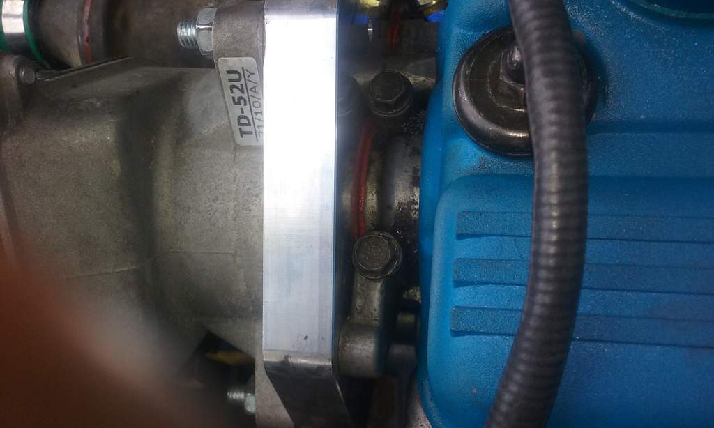

    Dizzy is the slang word for distributor. Post some pictures of your distributor and head so we can see if a distributor adapter plate will fit. Have you thought about just putting a nos kit on it

    Now you know about the two mounting-legs,how about that adaptorplate ?

    I'm actually using a carbureted piece that holds the distributor cuz the original one broke. One of the mounting holes is off with the adapter plate.3 out of 5 holes line up
