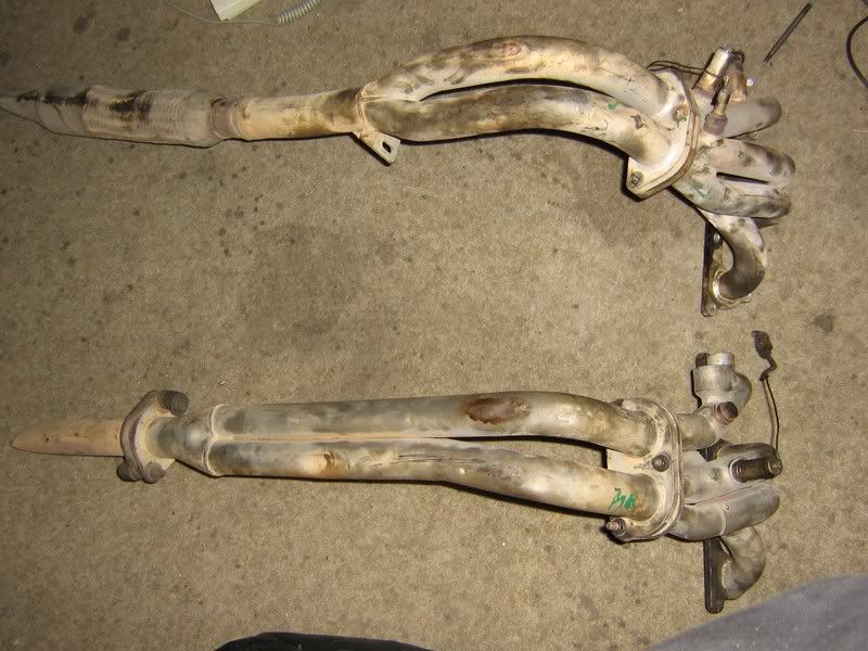

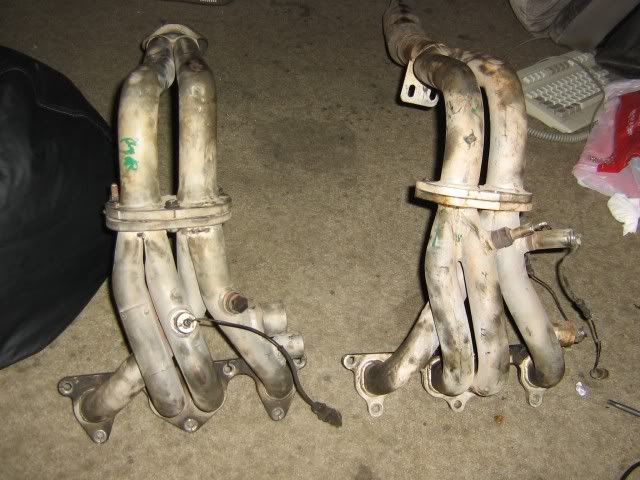

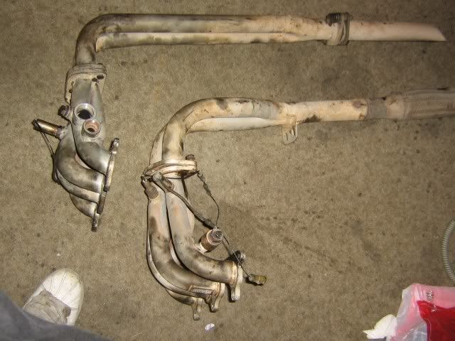

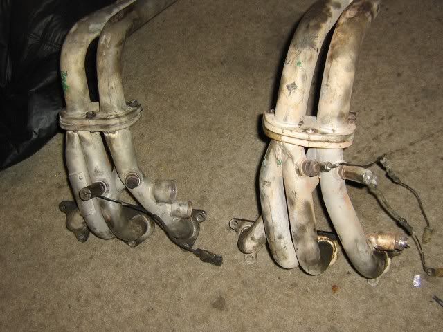

    Left: Lightspeed Right: DC
    Top: DC Bottom: Lightspeed

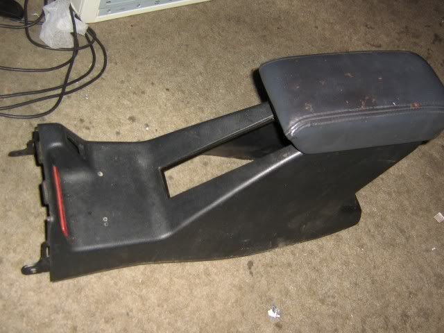

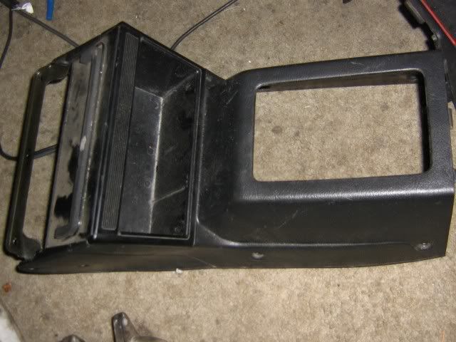

    And the SE-i console:
    (the cupholders were gone, so I just took a sweet cassette holder from another accord...)

    I havn't decided which ones to keep yet...
    The DC's look like they're alot better made, but the Lightspeed are made to fit that damn pipe.
    Has anyone heard anything good/bad about either?
