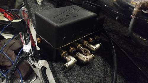

    So here's management up on it's arrival, note those dual compressors!
    I don't know what it's like on a Sedan or hatch, but on the coupe there's a perfect amount of room behind the spare tire that fits both compressors beautifully.

    So with all the fun crap behind the tank done, it was time to wrap up the trunk, which meant spray adhesive-ing the carpet down, or at least a good bit of it, and the result is stellar! I haven't ever seen a 3gee trunk carpet so smooth!

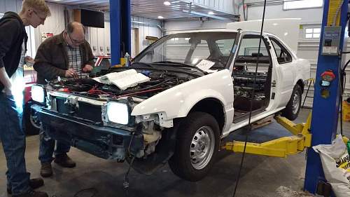

    But with all the wiring done, tank hooked up, and struts in, it was time to give it a shot!
    And, as expected, there were a few initial leaks and problems we had to sort out, but within seemingly no time at all, the car was lowering in a mere few seconds and raising even faster!
