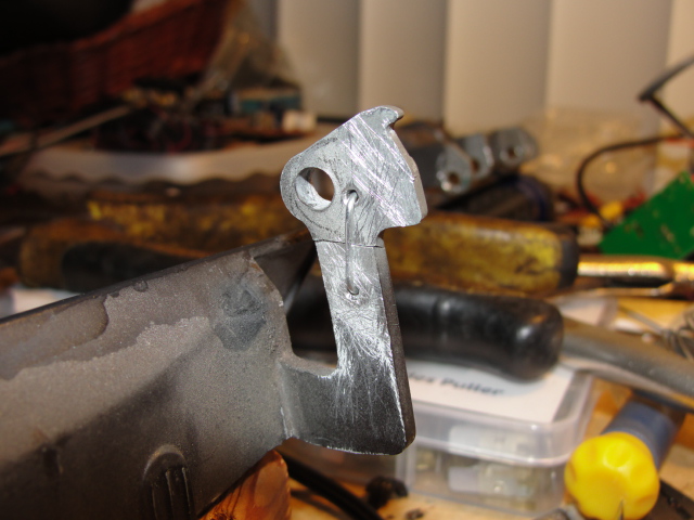

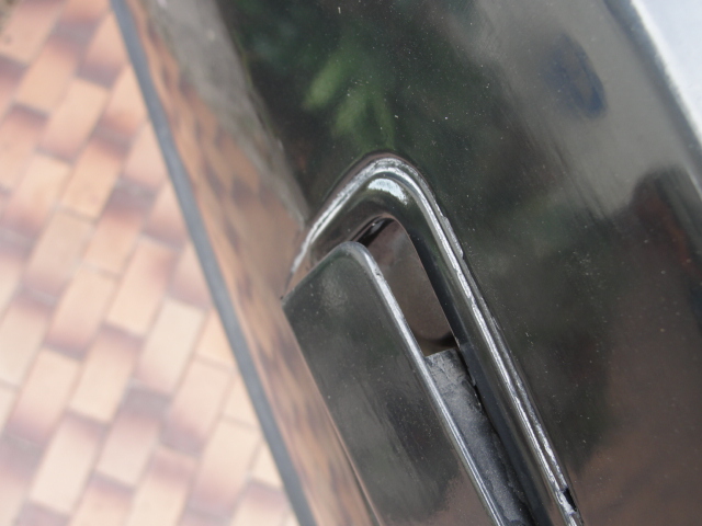

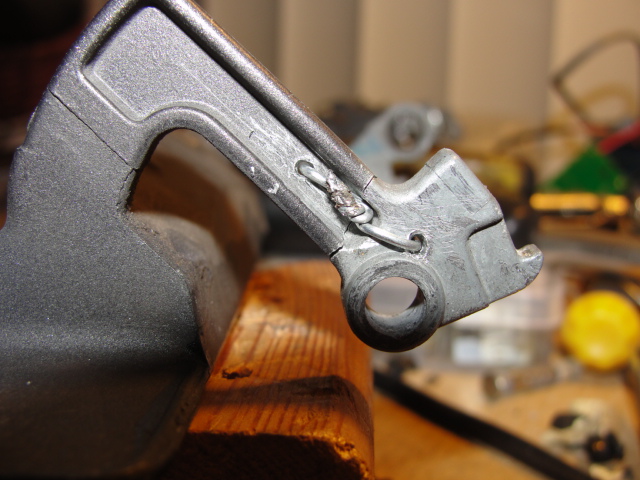

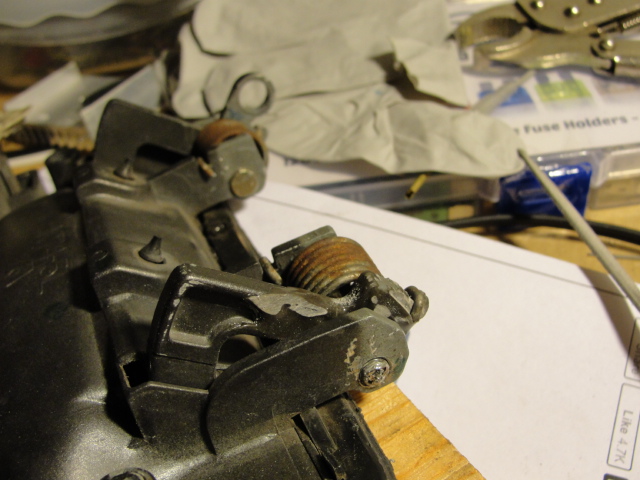

    It broke after 31 years of repeatedly opening and closing.... The hinge near the front broke off.
    After researching into flea bay and other sources, I know this is a high failure item. I decided to fix it myself. Luckily it didn't break at the pivot joint.
    I drilled holes so I could use wire to reattach/reinforce the broken parts, then JB weld to the rescue. After putting everything back together, it works perfectly fine.
