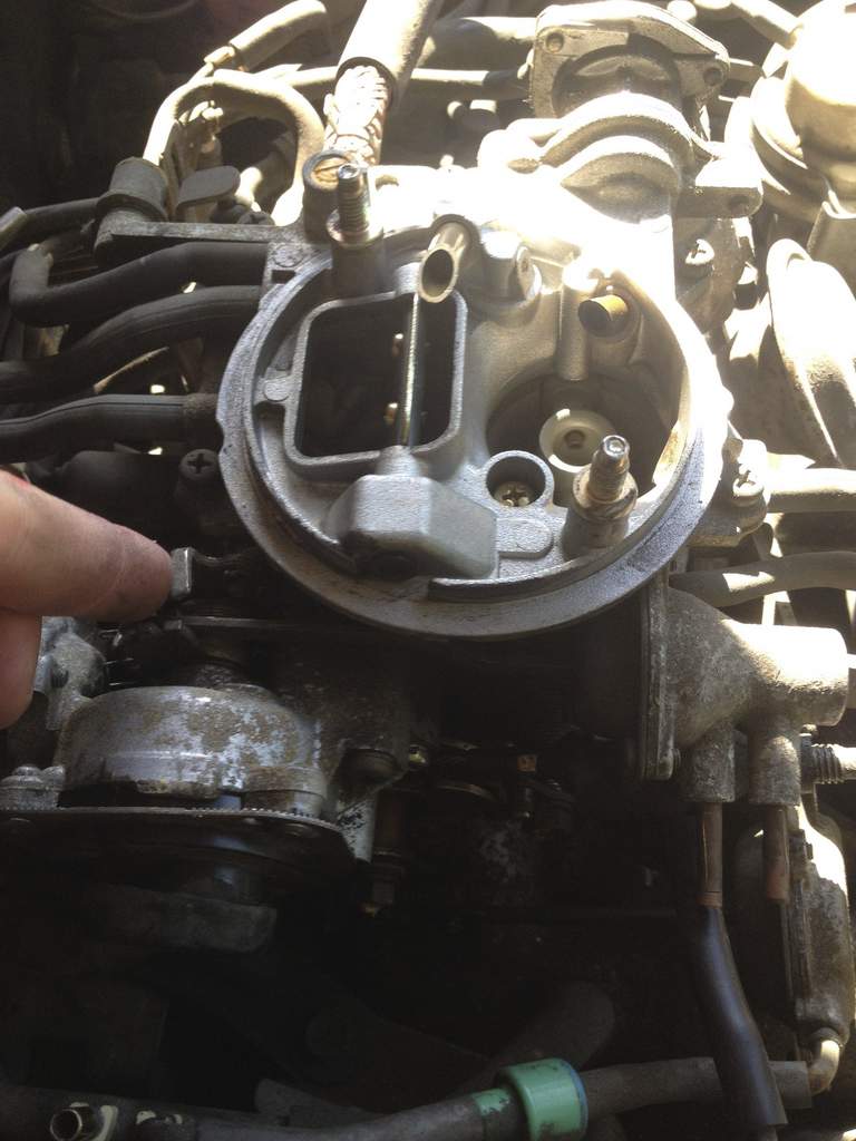

    I noticed the choke wasn't closing up. I think I read elsewhere that it should close up entirely. It doesn't. Here are some photos. Obviously you can smell a lot of unburnt gas in the exhaust.
    This is the carburetor right after the engine has been started with rpm 1900

    Your choke is not opening. It should be fully vertical after 15 minute warmup. Download the Honda Service manual available on this site. (Chilton's & Haynes are useless). For starts, just grab the choke opener puller and open the choke. Could be the vac leak is in the choke opener, causing the failure to open and high idle to hang.

    It's clear from your pics that you have an automatic choke opener, so that is first suspect for the problem. You can cap off the 2 vac ports on the choke opener... and if the choke doesn't open, that is strong evidence that the opener diaphragm has a leak. ( you can also put your vac gauge on the port for 'cranking leak solenoid' while running and measure for vac here. Also, you can use the carb cleaner as Dr Snooz suggested, and spray just a tiny bit around the diaphragm where the puller arm enters the choke opener. This will feed right into the carb. Check a few of the other posts here about high idle problems,,, I have described my experience with troubleshooting many times here,.... But it sure sounds like you need a new choke opener. (that was my problem as well a few years ago)

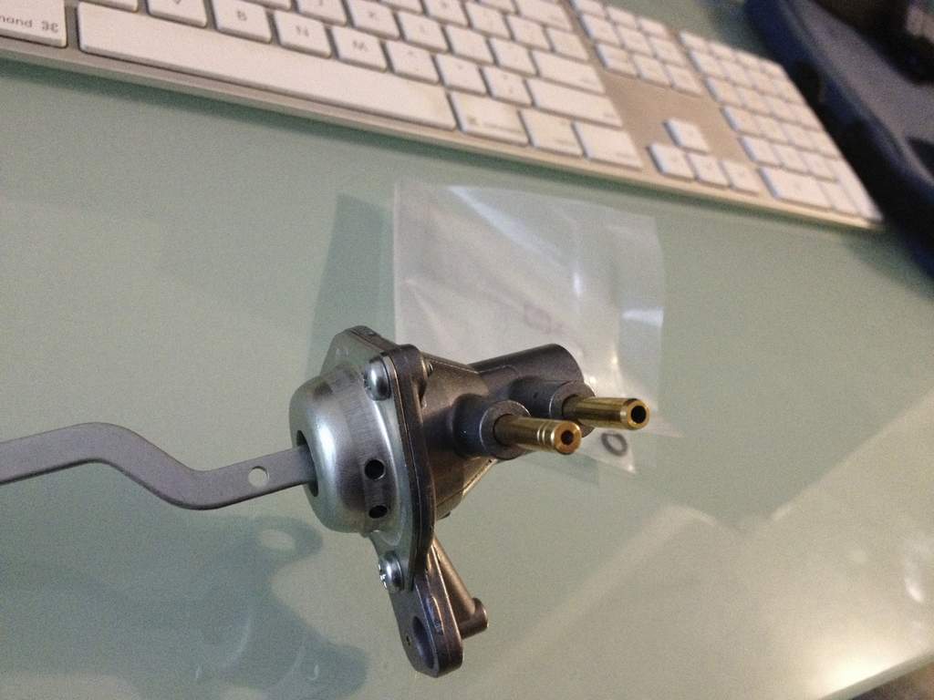

    I found a choke opener from Auto Parts Warehouse. They didn't call it an Automatic Choke Opener. They called it a choke diaphragm. It is the same part though. Click image for larger version.

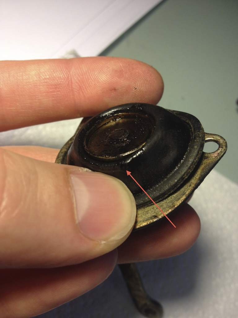

    I pumped down line 18 and didn't see any drop in RPM. I decided to replace the automatic choke opener anyway and I while I was tinkering I noticed that line #4 had was torn. I replaced it along with a bunch of other lines. Probably about 4 feet of tubing all together combined with the lines I replaced earlier.
    It is a good thing, because as expected, the automatic choke opener diaphragm had failed:

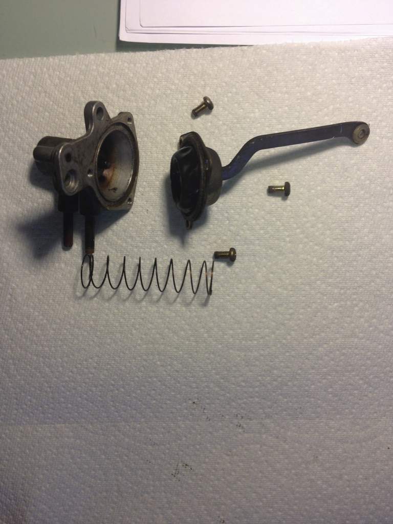

    Here is the opener broken down:
Name:	disassembled choke opener.jpg

    Here is a picture of the new choke opener installed and a bunch of the replaced tubes, some of the old tubes and the old gas pedal rubber cover that I replaced with a newer one from the pick and pull:
Name:	New Choke Opener & Tubes.jpg

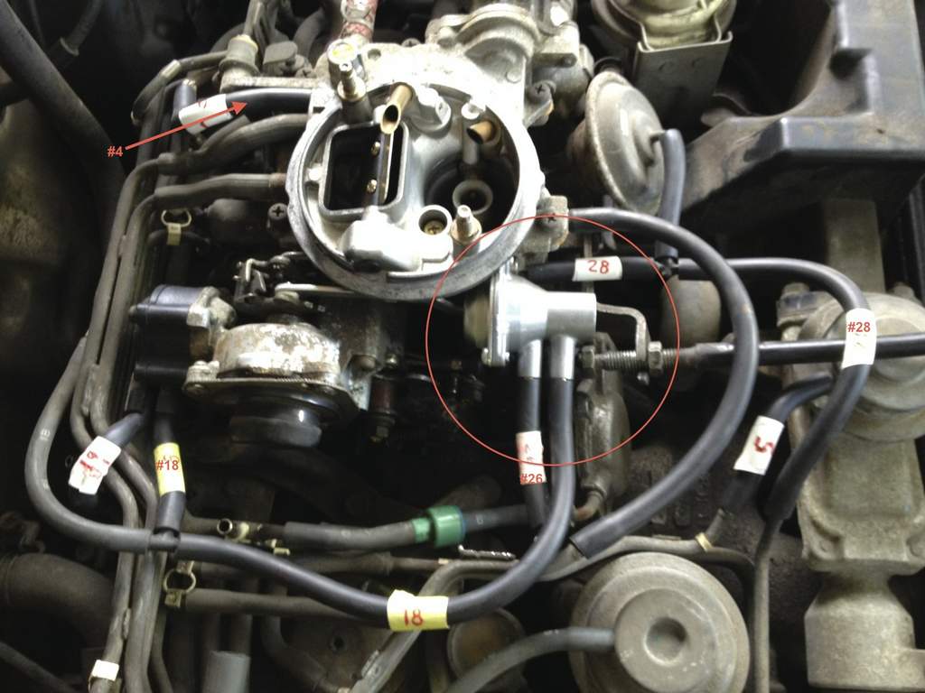

    Seems I was a bit premature, with the onset of cold weather I continue to struggle with the idle on my Honda. My previous repair was not fully understood. It seems that when the engine is completely warmed up it will idle smoothly at 1100 RPM. Previously, I thought this idle was all the time, because during the summer I seldom used the car and usually took it straight to the freeway for longer drives and when I parked it due to the air temperature (the coolant, maybe?) would stay warm. When I fixed it the engine had been running in the summer heat for more than an hour, so it looked really good.
    Now, due to the cold weather, I am taking it for shorter drives or if I leave it parked somewhere for awhile I've noticed the idle is still malfunctioning. The engine will idle at just about 2000 RPM until the engine warms up. Then usually the idle will drop back down to 1100 and hold until I let the engine get cold again. Sometimes though, when I am coming to a stop and the car is out of gear I will see the RPMs rise and fall between 1500 and 2000 rapidly (this only occurs when the car has been driving for awhile, but maybe isn't fully warmed up).
    Please recall that before I replaced the choke opener I pumped line 18 and did not see a drop in RPM. Does this mean that thermovalve A/B? or the fast idle unloader needs to be replaced? I've inspected the tubes very carefully for leaks and am as confident as possible they have not failed, although I could be missing something.
    I'm digging around in old posts and on youtube for answers, but any ideas or locations to look would be very appreciated. Feel free to educate me too. Thanks

    Re: Throttle/idle Issues on 1987 Honda Accord LX
    That sounds like a leakng vacuum advance diaphragm or vac hose collapsed or leaking slightley.
    A good spray down with choke cleaner all inside the top hat is a good winter prep though.

    Thanks for the information. I finally had the opportunity to get back into this project and I think a solution is close!
    Upon locating and inspecting thermovalve A I found that that the line 18 nipple is broken off. The line 18 vacuum tube is not connected, just dangling with the broken nipple still attached (sorry, couldn't manage decent photo). I think this means that line 18 never provides the vacuum needed to engage the automatic choke opener, creating a constant fast idle.
    Apparently, once the engine gets to temperature another system must be activated and engage the automatic choke opener. Is this line 26, line 19 or something else?
    Occasionally when the engine is at temperature the fast idle will return (RPM ~2500), but tapping the throttle will return the idle to 1000 RPM. I read one of POS carbs old posts which said that if line 19 has vacuum it will release the fast idle cam. I suspect this is what is going on.
    I've tried searching, but I cannot figure out the purpose of line 26. The stage 1 vacuum line removal guide (see here: https://www.3geez.com/forum/how/11067...tml#post470501 ) shows it plugged. I am wondering can I simply pipe vacuum from another line and give constant vacuum to the choke?
    I inspected the nipples and vacuum tubes on lines 17 and 19 and they appear intact. I think they are functioning.
    I've attached the image below for easy reference:

    Line 26 is the 'cranking leak solenoid' line. It makes sure your choke stays closed while cranking the engine to start. It goes right to the black box. You can test it's function with a vac gauge. It should hold a vac (to the black box) unless you are cranking the starter.
    If Port 18 nipple is broken on thermovalve A, I would suggest you bypass the thermovalve altogether: just connect 19 and 18 together at this point. Line 17 is the 'vent' line so you can just cap it to avoid getting dirt into the vac system.
    It's summer now so bypassing thermovalve A should be OK. It may take a bit of feathering the gas pedal when you first cold start, but only will be a problem when winter comes.
