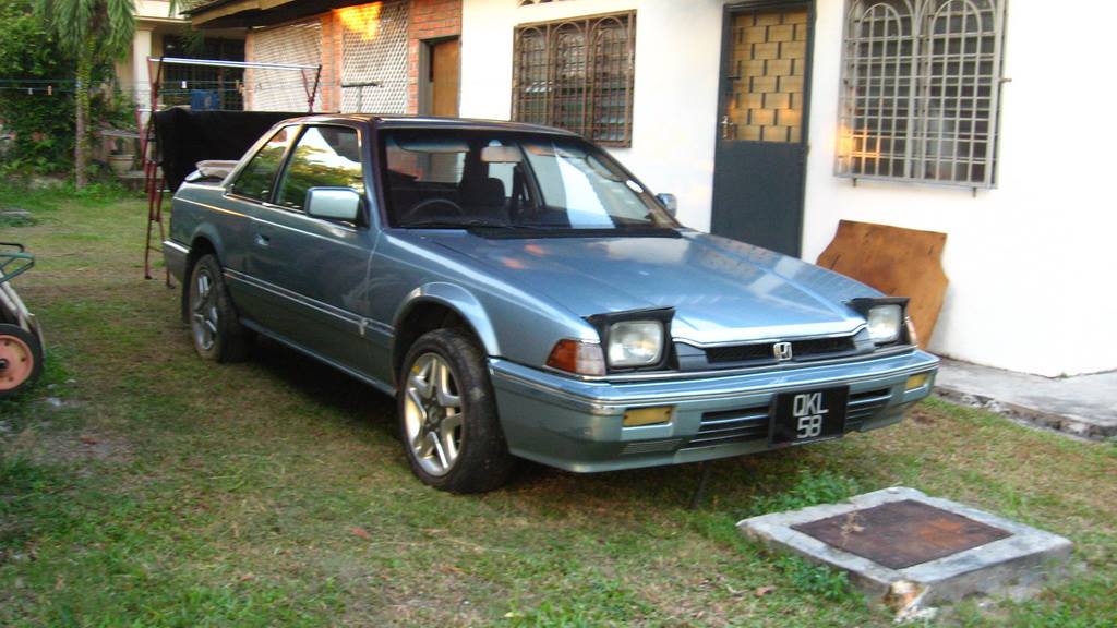

    Yes I have a Prelude. I already told some of you guys but heres some background story: My uncle offered me a free car months back and me being me, I said yes without knowing wtf the car was and little did I know its a friggen 2g Prelude - something I always wanted for years! Fast forward a few months he had it delivered to me and actually paid for the tow and stuff (thank you sir ) so I ended up with a totally free car! The catch is the motor is blown. And its an automatic. But hey its free?!
    He gave the car to this guy years back and they drove it till it died and he had the car checked by a mechanic and they said theres water in the engine oil. Not sure how it got there in the first place, probably driven through flood or maybe blown headgasket since they said it ran rough before it died? He didn't want to fix it and ended up with the car in the storage for years before he offered me it since he knew I love old Hondas so much
    I'll get more pics and I'll see whats up with the engine tomorrow. I'm gonna get a mechanic friend of mine to help since I'm basically clueless with building a motor LOL.
    Enough talking, PICS TIME!

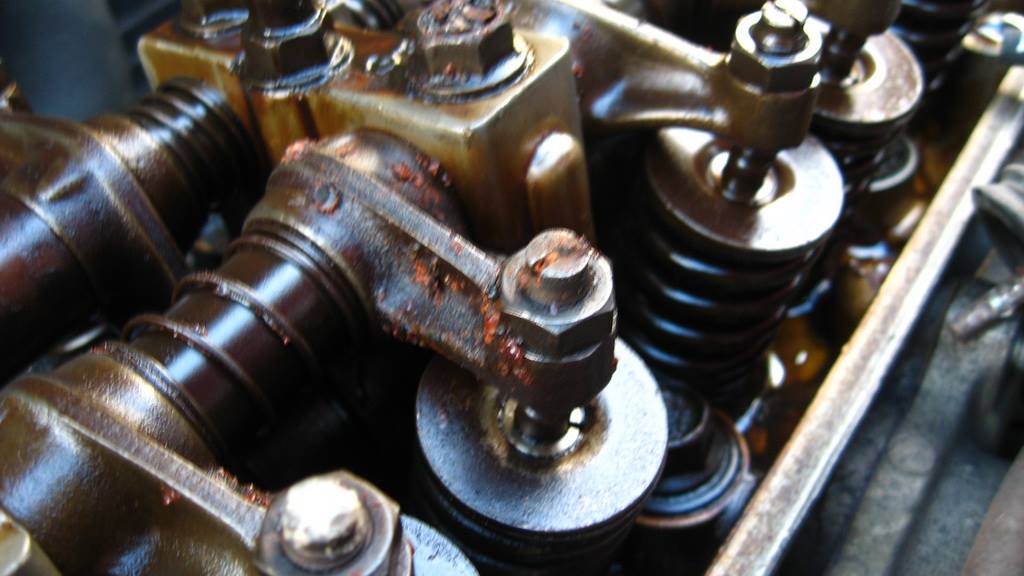

    Yes that would be rust. Is that bad?

    Looks like a clean ride! Not sure what's up with that rust. Can't tell, but is there any on the cam surfaces? Might wanna pull that engine and tear it down and look at things before you try starting it. Or at least drop the oil pan or something.

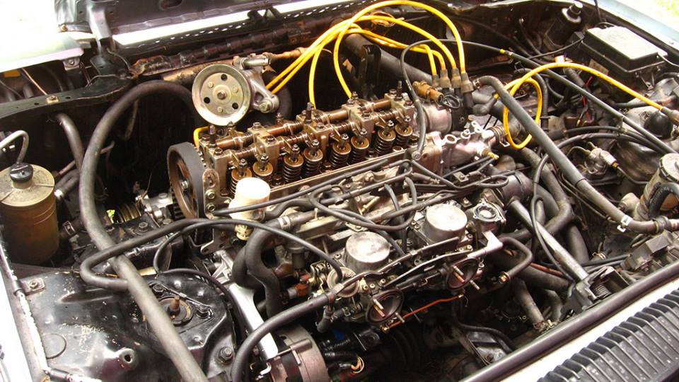

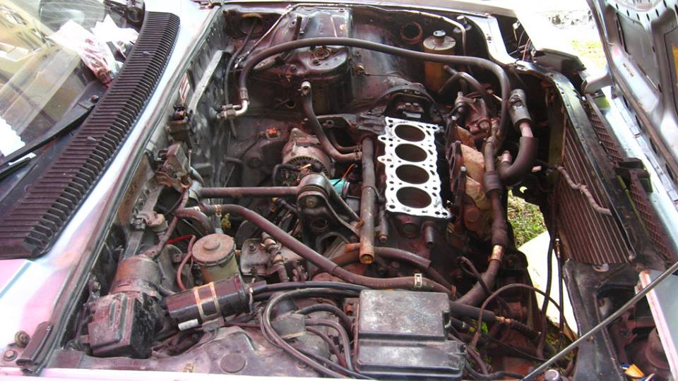

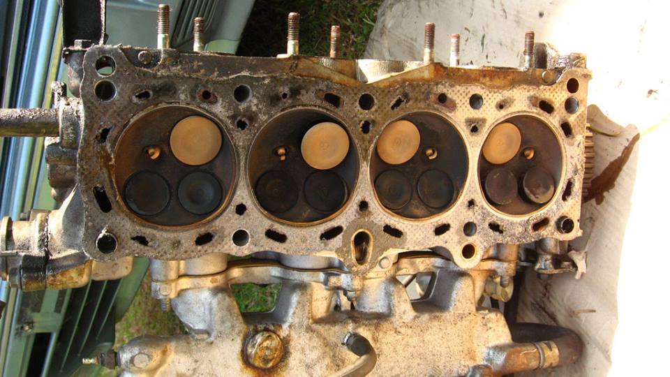

    So I've got the head off
    Click image for larger version.
    I could see a spot where the headgasket is blown I think? That explains the milkshake and how he described the car running rough and eventually died.
    Is this bad?
    Other than that spot, all cylinders are fairly clean and even the factory cross hatch is still there but then I'm clueless about building an engine LOL.
    I don't know exactly whats wrong with the engine. I swear he told me he had a mechanic pulled the head off and found there are some rust on the pistons/cylinders. But then the exhaust nuts and head bolts are really tight still so I assume they never had it off before?
    I'm guessing the headgasket blew and thats all? Unless I'm missing something else hahah!

    If the oil got water in it you need to pull the crank and check the bearings. It's a good bet the bearings are shot. If the crank journals are ok and the cylinders aren't out of spec, you could just do the rings and bearings on the bottom end. The head might be ok if the cam and rockers aren't abnormally worn. Really it's sort of a crap shoot with something that's been sitting around a long time like that.
    If it were me, I would probably go with a full engine rebuild. Or if you just want a beater engine to drive around slap on a new head gasket and run it until it dies.

    i say if your not looking foward in rebuilding it slap a hg in and do a oil flush. meaning run fresh oil without starting (priming) drop oil then inspect to see if there is fine shaving an so forth. you might just get lucky.

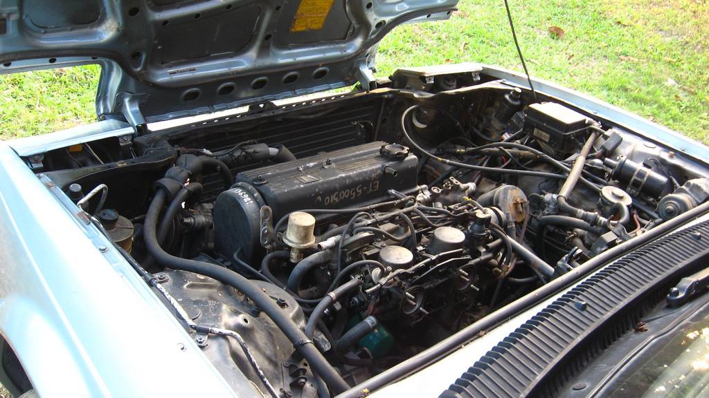

    OMG GUISE IT LIVES! I didn't bother dropping the pan, just slapped a new headgasket, get the head machined, replaced some misc seals and gasket while I'm at it, new timing belt, done!
    I did not get PICS of everything back on but I'll post some tomorrow along with vids! This is actually my first time doing a major engine work lmao and it won't be possible if it wasn't for my buddies help and CAH (Y) And 2ndGenGuy too (Y) Did I mention that i was struggling to get the timing belt on? And them have them 2 tooth off and the motor won't even run and would backfire instantly LOL what a noob.
    Anyway now I do have an issue with it not wanting to idle. Getting the rpm up won't do it anyway, in fact it would only stay alive if I keep playing with the gas pedal. What could be the issue here? I'm gonna pull the carbs off again and clean them again as well as checking all the adjustments once again. AND replacing my fuel filter lol but I did bypass the filter earlier and still no change. And yes I did drain the old gas off. Poured few gallons of fresh gas into the tank so I don't think bad gas is the issue here. I have new plugs, thats about it. I reused the old dizzy cap, rotor and wires. But I'm getting strong spark so I can't be too sure ahh

    It idles now but only if the chokes are closed so I'm thinking it has to be running so lean that it needs the choke so it would run somewhat rich? Exhaust doesn't smell rich either even with the chokes are closed. It would die as soon as the chokes are open.
    VIDZ of poolude idling
    Any idea why it would die if I get the chokes to open? None of the vacuum lines are hooked up since whoever took the intake off before didn't bother labelling shit and they took everything out (N) And yes I did plug all the vacuum lines. I'm thinking theres a vacuum leak somewhere since it would run only when the choke is closed. I'd rather not mess with the carb settings yet.
    I need to get new alternator/water pump belt as it was screeching like mad. And a couple cans of carb cleaner to check for vac leaks and probably would shoot the carbs with it just in case.

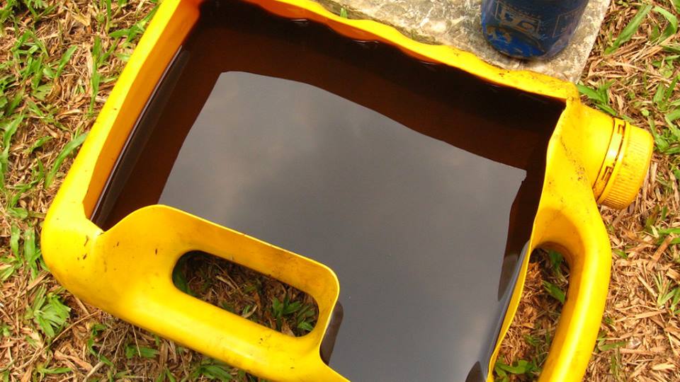

    Oh the joys of bring back piece of shit back to life.. I just found out that my oil turned into milkshake again and it can't be the old stuff since I had the oil drained the other day and it was as clear as it can be with no traces of coolant whatsoever. And the squealing alternator is back even when the alternator checked out okay and I even replaced the bearings and brushes while I'm at it and checked everything just to be sure and they all seemed okay. I'll see if changing the oil and do another flush would help else I'd say fuck it.

    Well, oil in water is probably a cracked block. What happens is people get a blown headgasket, engine burns off the water in the cyclinder and gets hot and then block cracks and then they get water in the pan and blame the head gasket. Common mistake. Suck to hear that after all the work you put into it.
    I wish i would have seen this earlier, by what you described with the radiator having that much pressure is sign that you still probably had a head gasket issue or cracked head.

    Definitely not leftover stuff from the old oil (N)
    Getting the head out today and have everything checked including the block. Kinda hard to do it myself now working with just one hand lolol so I gotta wait for my buddy to help me undo the exhaust bolts

    Had the head back from a different machine shop yesterday. The head was warped and I honestly have no idea if the head was warped before I put it back together the last time or it warped after I ran it too hot from having all the bubbles in the cooling system but seeing how the first guy left some corrosion near the coolant passage on the head, I would say they probably screwed it up the first time. Second guy did it right this time and confirmed the head was warped hah!
    Installed the head last night with the help of my buddy and the car was running this morning. I also had the radiator flushed and leak tested so its pretty much brand new. Ran the car for 5 mins, drained the oil and saw some white stuff again ha! Refilled with fresh oil, ran for another 5 mins, checked the dipstick, its all good except for some slight white stuff on it. Oil cap has a bunch of milkshake oil though, I assume it would be caused by the moisture in the engine or the PCV isn't hooked up properly?
    Took the car for a drive around the neighborhood, stalled once while in gear. I still gotta get the carb rebuild kit since its not 100% right yet but it idles alright. Checked the oil again and its slightly cloudy but not as bad as before. It was foamy white milkshake like vs now being slightly cloudy. I will do another flush and hopefully it would clear up this time!
    Temperature is fine now it would barely went over 1/2 and cooling fans are working as it should. Cycled on/off a couple of times while I let it idle for a few mins.
