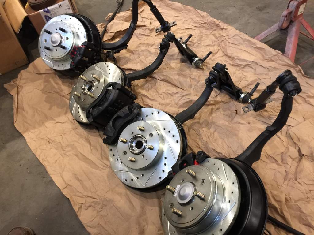

    Suspension:
    -SEI Full Disc Brake Conversion (Including Prop Valve and Master Cylinder)
    -Steel Braided Brake Lines
    -Wilwood 4 Piston Front Calipers
    -Prelude Front Upper Adjustable Control Arms
    -Slotted and Drilled Power Stop Rotors Front and Rear
    -Rear Upper Adjustable Control Arms
    -Cheddas Front Traction Bar
    -OEM optional Rear Sway Bar
    -D2 Racing Bags
    -1984 JDM 15x6.5 +16 Manaray Turbinas
    -Backup set of 1985 Mitsubishi "Cowbell" wheels 15x6.5 +18 wrapped in 195/50/r15 Toyo Proxes R888, filled redrilled and restored to OEM gray
    -Wrapped in 195/45r15 Toyo Tires
    -Polyurethane Sway Bar Links

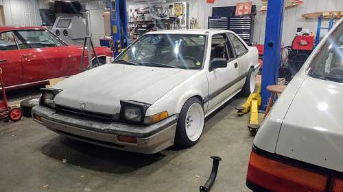

    So with that said, here's my car as it started life in my ownership!
    I had no idea about the rollercoaster to come, or the people on these forums and stories skills I'd learn when I bought this humble car, but I couldn't ask for anything more, it's been an incredible experience, and I can't wait to have this build completed!

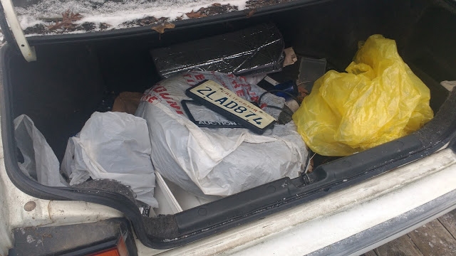

    I bought this car on July 4th 2016, and it was my first car, the only real knowledge I had of cars was from watching over my Dad's shoulder and every now and then removing a part or two, so I didn't have much experience. But in about a month of my onwership, the clutch on this DX started to fail, and after realizing "it was only 3 pages in the shop manual" and having no idea how tough it could be, I decided that I should try and save money and do it myself. My life hasn't been the same since! So the car went up onto the lift, and after driving hours in between work days I got the job done in about three weeks, with this being my first big encounter with working on cars myself.
    We did-in fact- manage to get it out, which was an incredible high the first time!

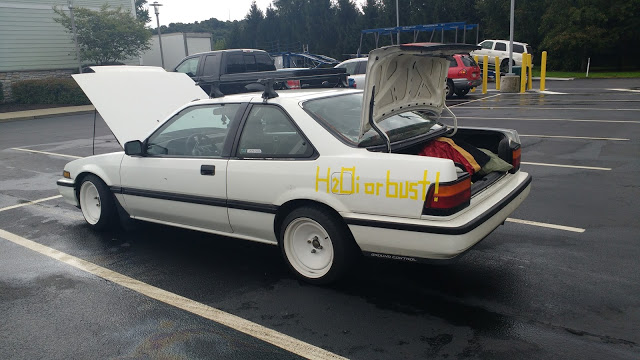

    But, everything good must come to end it seems like, so after attending H20i (a 2000 mile drive, which the car did flawlessly);

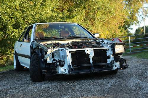

    ...I drove it into a tree. That split second stupid decision is what changed everything for this car, and these years until now, as I had only had the car how I liked it for around a month, and decided that I wouldn't be done with it so soon.

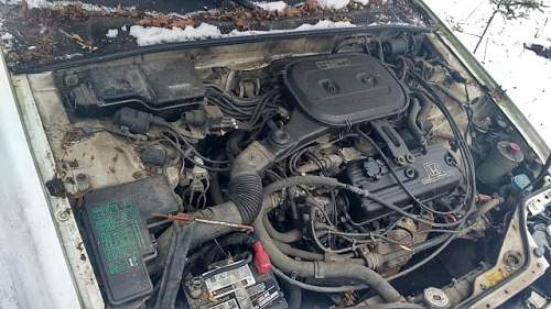

    And so, enter donor car No. I (formally known as B0CKS II)
    In the state that I got it:

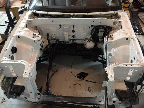

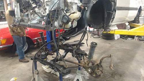

    This turned my mission from a front end swap into a frame off, as every good part needed to go onto the good car, and everything else could simply be trashed or installed onto the other vehicle, so we got right into it!
    And between the two cars, one had around 100k less on the clock, so we decided we need to take that out of one car, and install it on the other, along with a cradle swap! So, out with the first engine;
    ...and cradle;
    And then the other cars engine and cradle;
    And, to paraphrase, the lower mileage engine was rebuilt head up, all new gaskets, new pumps and pulleys, belts, a good first engine build, you know? And was then installed into the straight frame:
    And that was much of the initial plan for the mechanical end of my goals for this car, of which I am still pretty proud of!

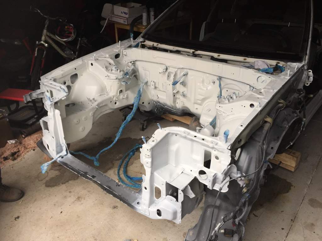

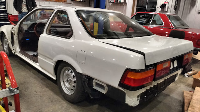

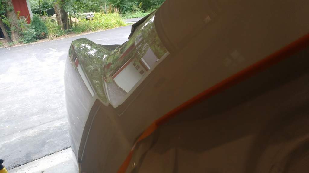

    And every good rebuild needs a good paint job, so here's my first go at painting a car! Let's just have a quick three months of work happen reaaaal quick:
    ...and done! That's 4 coats of primer and 3 coats of SINGLE stage paint, if I chose double, I probably would actually be done by now- I still have to paint the hood and doors of this car! Oh well Maybe on the next resto!

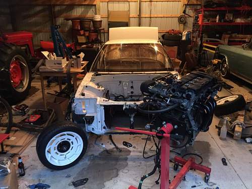

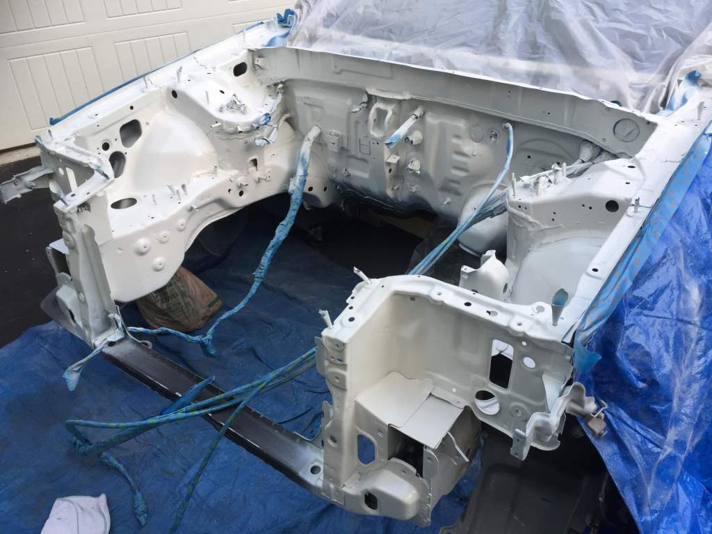

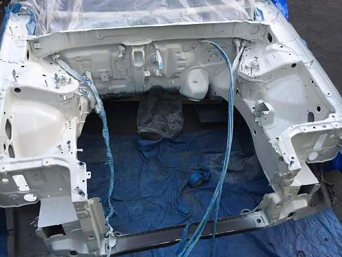

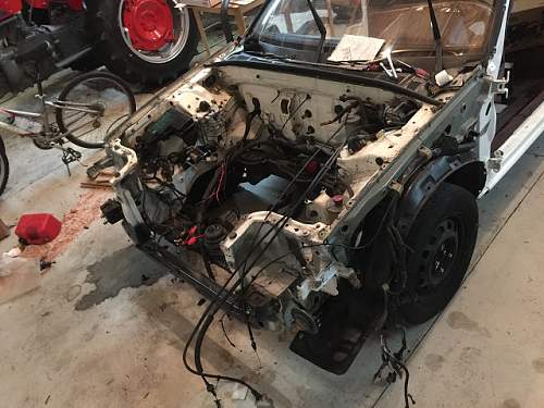

    And so, being bored with painting and sanding, I decided I would pull the frame myself on my wrecked car and rebuild it for fun with spare parts we had lying around. So we did. (just want to say again, this is very paraphrased.)

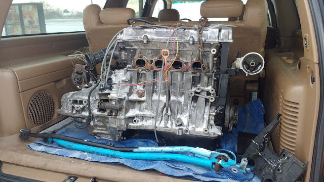

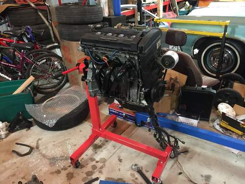

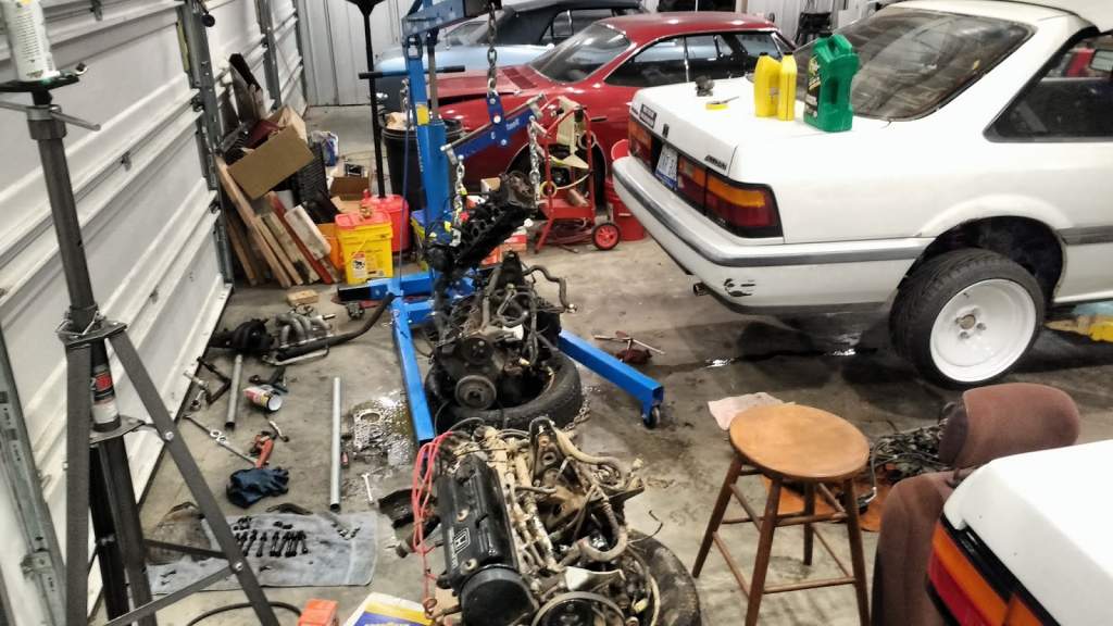

    Then found it needed an engine, so I bought a racecar for the engine which led to this photo:

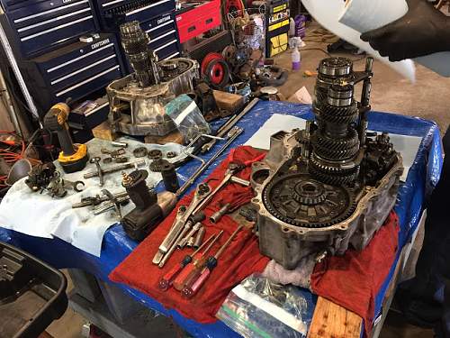

    tore the spare engine and racecar engine apart and rebuilt them over a weekend;
    ...and it still doesn't work, but that's for another thread.

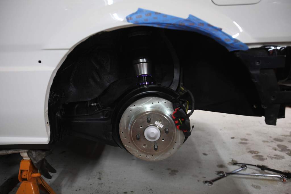

    Now all the backstory is out of the way- it's time to get to the good stuff.
    During my hours of sanding I got fixated on the concept of airride, and how stupidly cool it would be to bag this car, and so I pinched my pennies until I could afford it;
    An Airlift box containing a 34" 7 port tank, two air compressors, and all the wiring necessary. It was unreal finally opening those packages!

    And so, with a drastic change of goals around the start of the new year, I went down to south bend Indiana and bought...

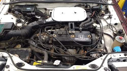

    A B18B1 engine. Basically, a member from the Facebook page had a good deal on Webers, and no one makes a good intake manifold that I could get a hold of for the A20 for Webers, but I found a B18 intake manifold, that could be used on the A20... or a B18... and I went down the rabbit hole, and came out with these:

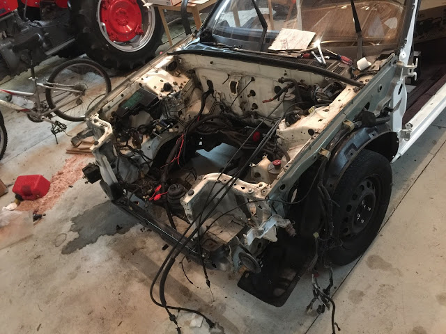

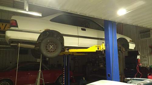

    And at this point, it was time to pull the A20 I had rebuilt (and also never turned key on) to make room for the B18.
    ...And not to brag, but it took me and two friends one literal hour to pull that engine. Boo. Yah.

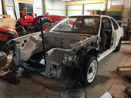

    And while it's out, why not tear the engine bay all the way down and repaint it? Okay.
    It's getting another coat this weekend, but I'm guessing you can see what it looks like!

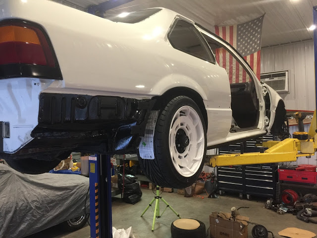

    And we're nearly caught up! Paint isn't the only thing on the docket for work this weekend, but wheel wells too! Another member of the Facebook group was selling discs brakes, and I was fortunate enough to score those, so here they are!:
    ...and after last weekends scrubbing and spraybombing, here's a start for the rears:
    Which will all be hiding behind slotted and drilled disc brakes as well these wheels!:

    And that basically brings us to today, where I'll be rebuilding those front knuckles! Awesome! Feel free to stay tuned!
    And I forgot to mention it, but we rebuilt transmissions too! My bad!

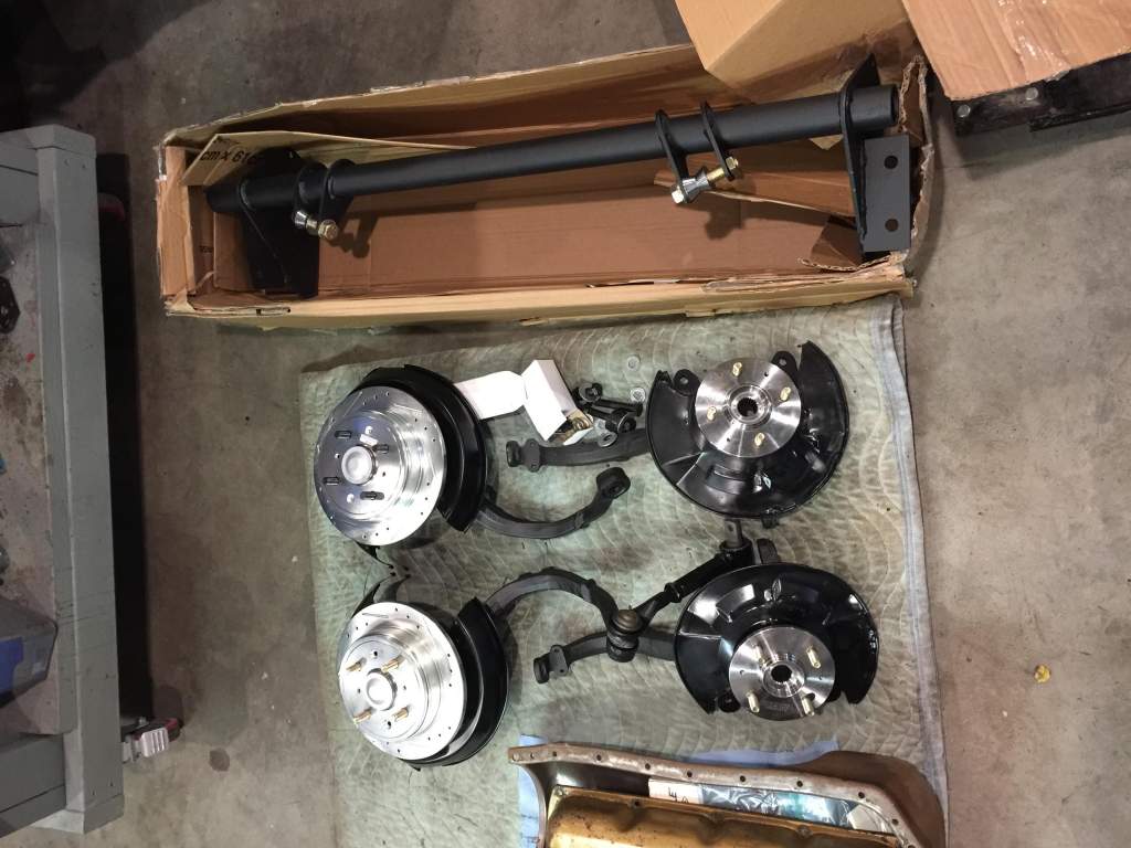

    I picked up some suppper rad prelude seats, they're in good shape and everything is all there! I'll be having them reupholstered to be our good 'ol factory brown(red? Still can't tell honestly) which will make them very unique to our group, but to the regular onlooker, they'll be nothing out of the ordinary, which is perfect!

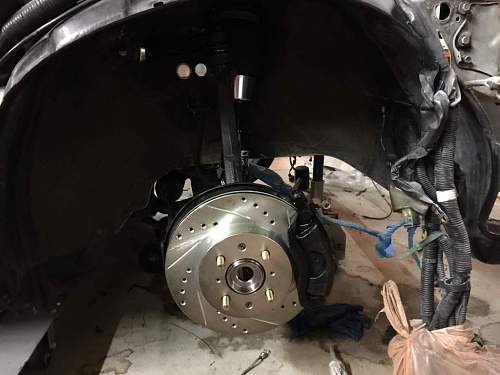

    And I went home and got my front knuckles picked up from having the hubs removed, so now they're also catching a nice new coat of undercoating and top coat! Looking good!
    So on the docket for this weekend:
    Get all the hubs fully assembled and ready to be installed (all the fun brake parts should be in by next week!)
    Engine bay gets another coat of paint
    Do some work on the B18, since it just kinda' needs work.
    We'll see what actually happens!

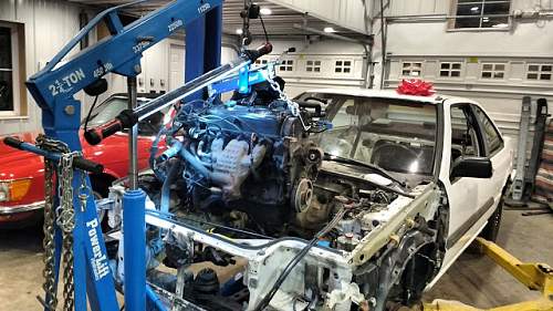

    And you might say "Hey, he didn't get much done". I was busy pulling out this engine:

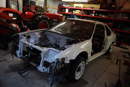

    Here's a little more of the same, but we're finally at the stage of install! The Knuckles are pretty much wrapped up, the fronts need lower joints and then we're good to drop them into the car! And the engine bay received it's final coat of paint, so it's all uphill from here, engine install is officially good to start!!

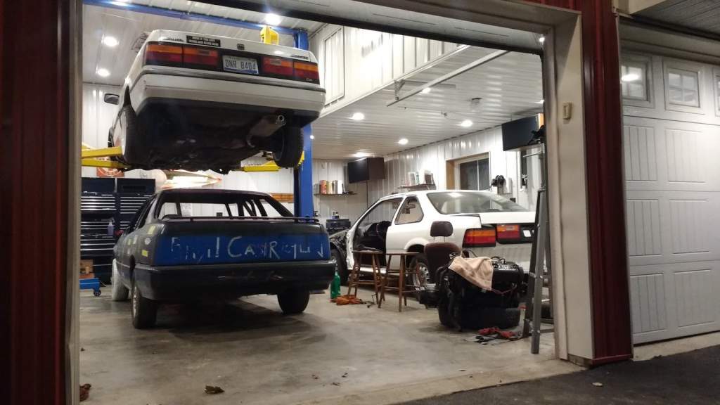

    So, the car is hasn't changed much between all the other crazy happenings at our barn (transmissions blowing up, 85 Fiero's and 68' Lemans being purchased, gaskets dying and the sort) but the Accord(s) are in fact in making progress! It's just a few strides but it's all good! The front knuckles & cradle are bolted in (and still need to be torqued) but look fantastic!

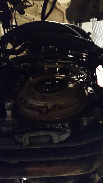

    The B18 is finallly moving forward. Got it off it's tire, a few questions answered and also torqued down a few things, and found out that I have no clue where my new valve cover gasket went! Maybe I should start being a little more organized!
    And the engine bay is starting to come back together! A few bits around the bay, such as the Cheddas Traction Bar, repainted brake booster with an SE-i swapped master cylinder were installed as well as some odds and ends.

    Which looks pretty good, IMO:
    Which led to a rather major issue, that being fitment. The Manarays do NOT clear the inner lip, and my goal is to slam this thing to the earth (whether we like it or not) so I need to figure how to dodge that lip.
