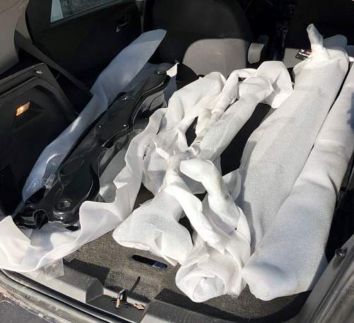

    And, since Sawzall is just the go to tool on the B-Cord, there was one more keepsake I wanted to pull off the car before it goes to the great beyond- so after almost one minute of BRRRRRRT, here’s what will be an eternal keepsake of my first car.

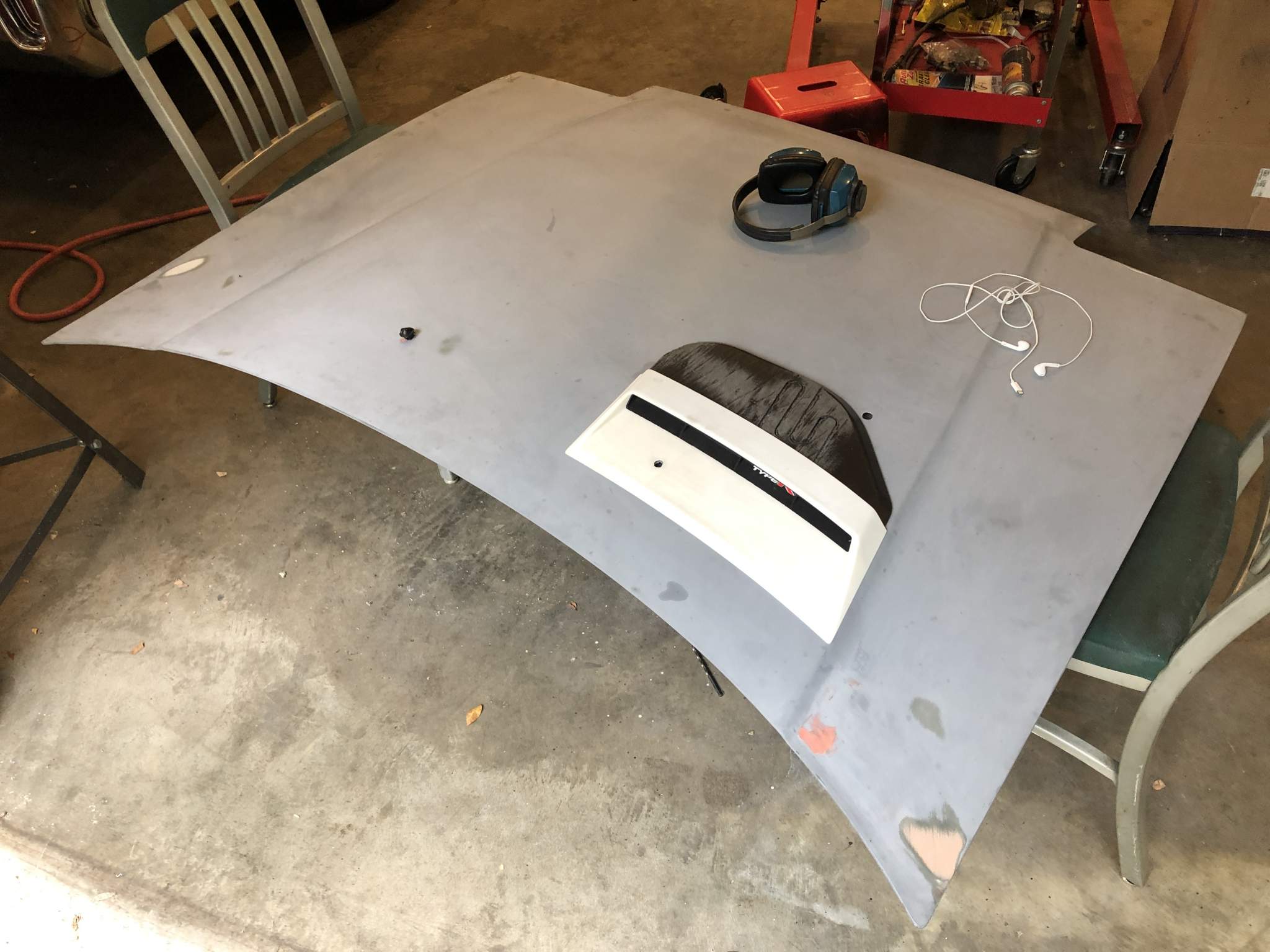

    And one more thing scoop related- I got to throw down some paint on the grill dividing the inlet and duct, and it looks sharp. I’m still coming around on the badge, but it does kinda glimmer in there. Not bad if I say so myself.

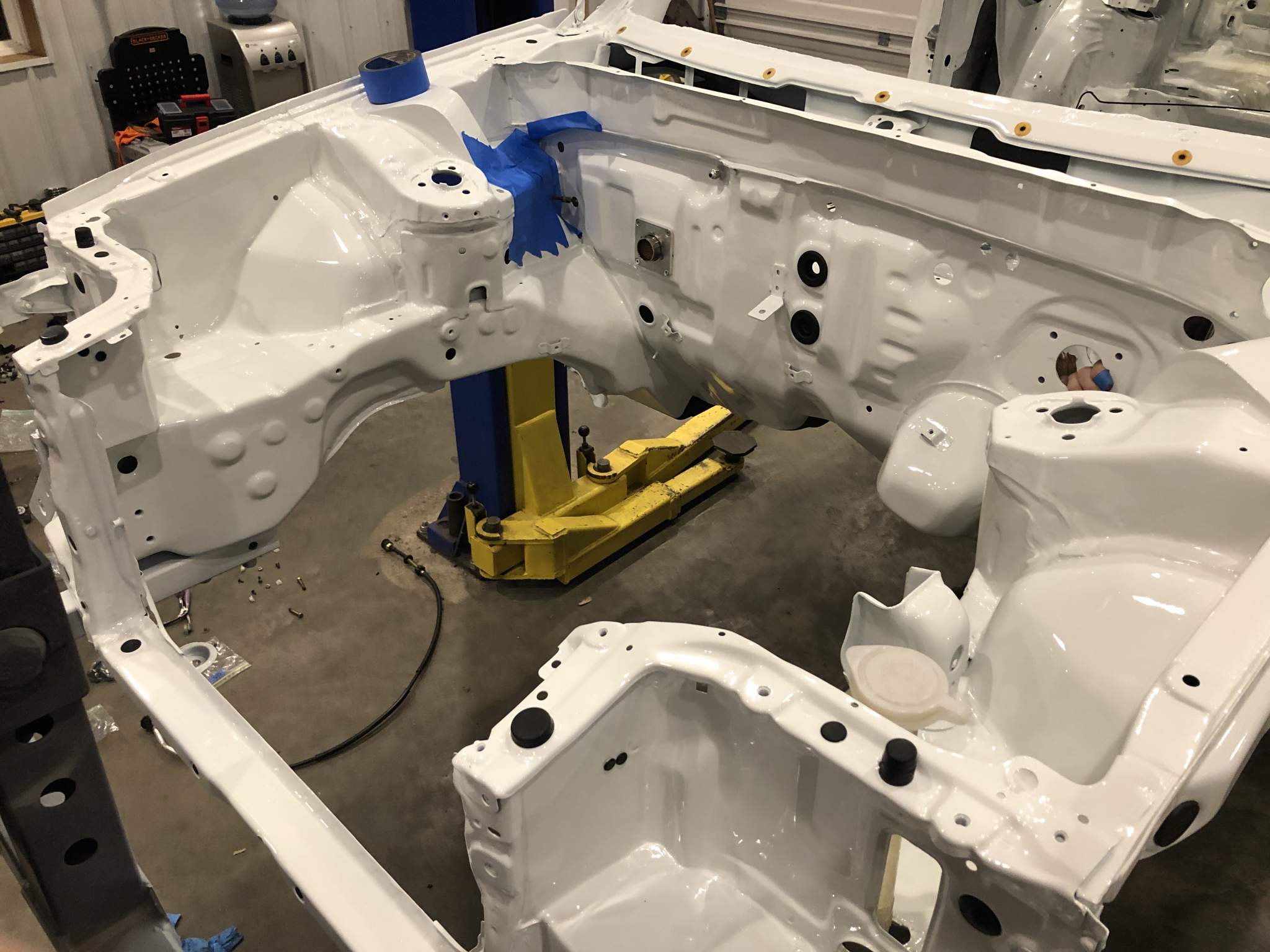

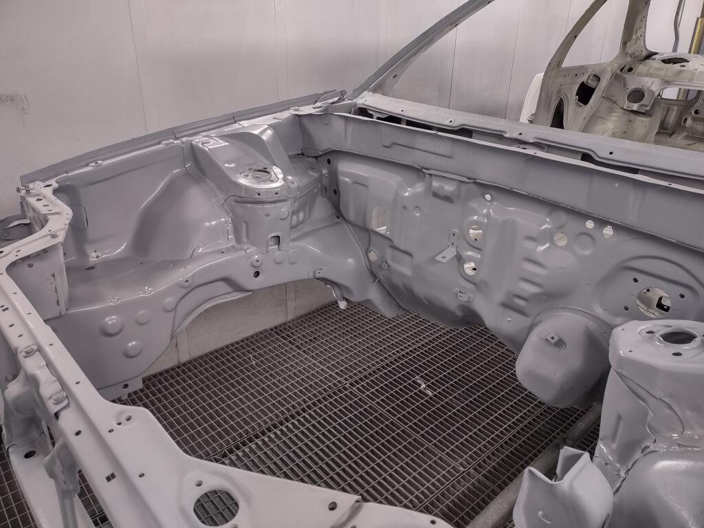

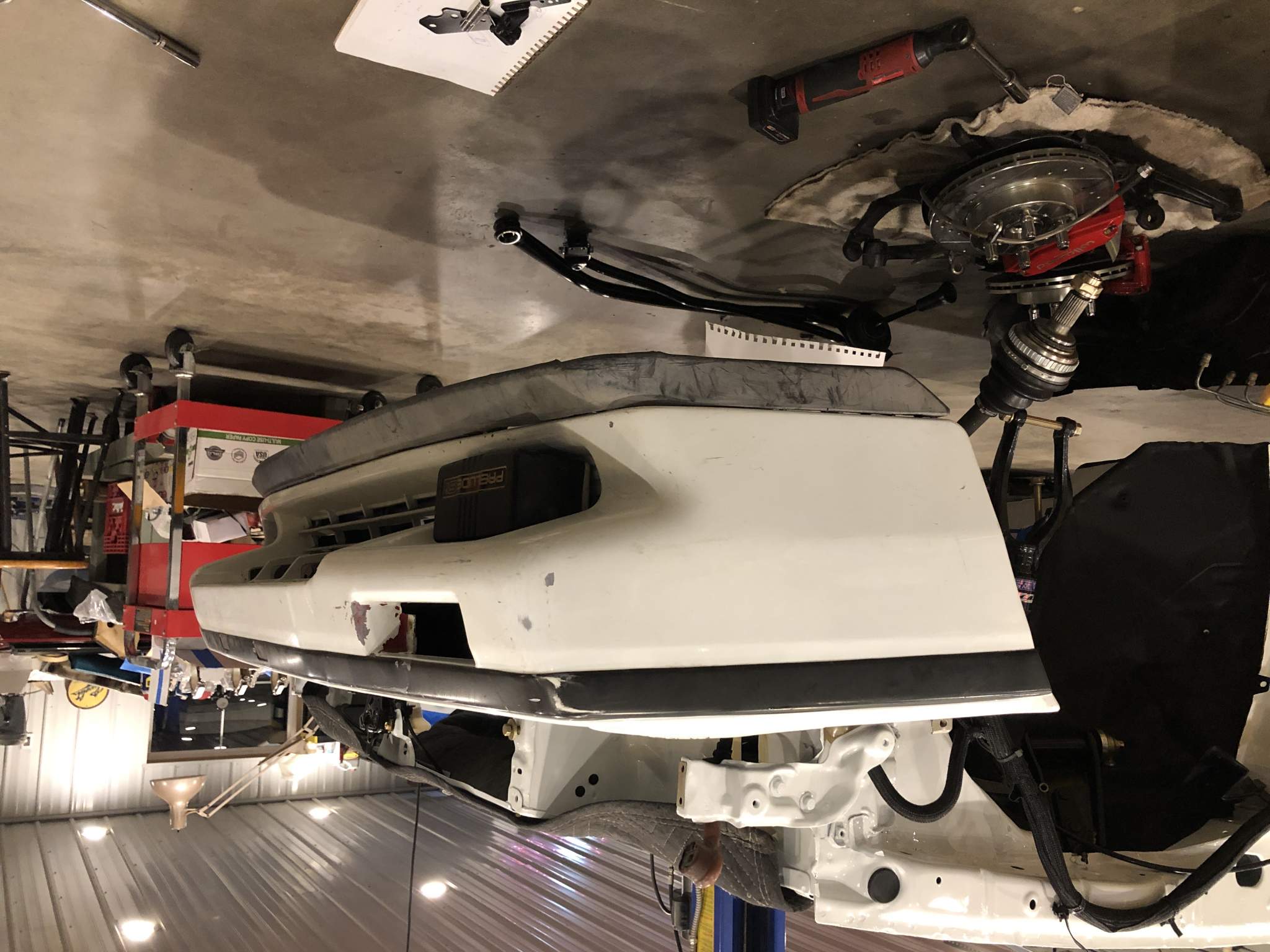

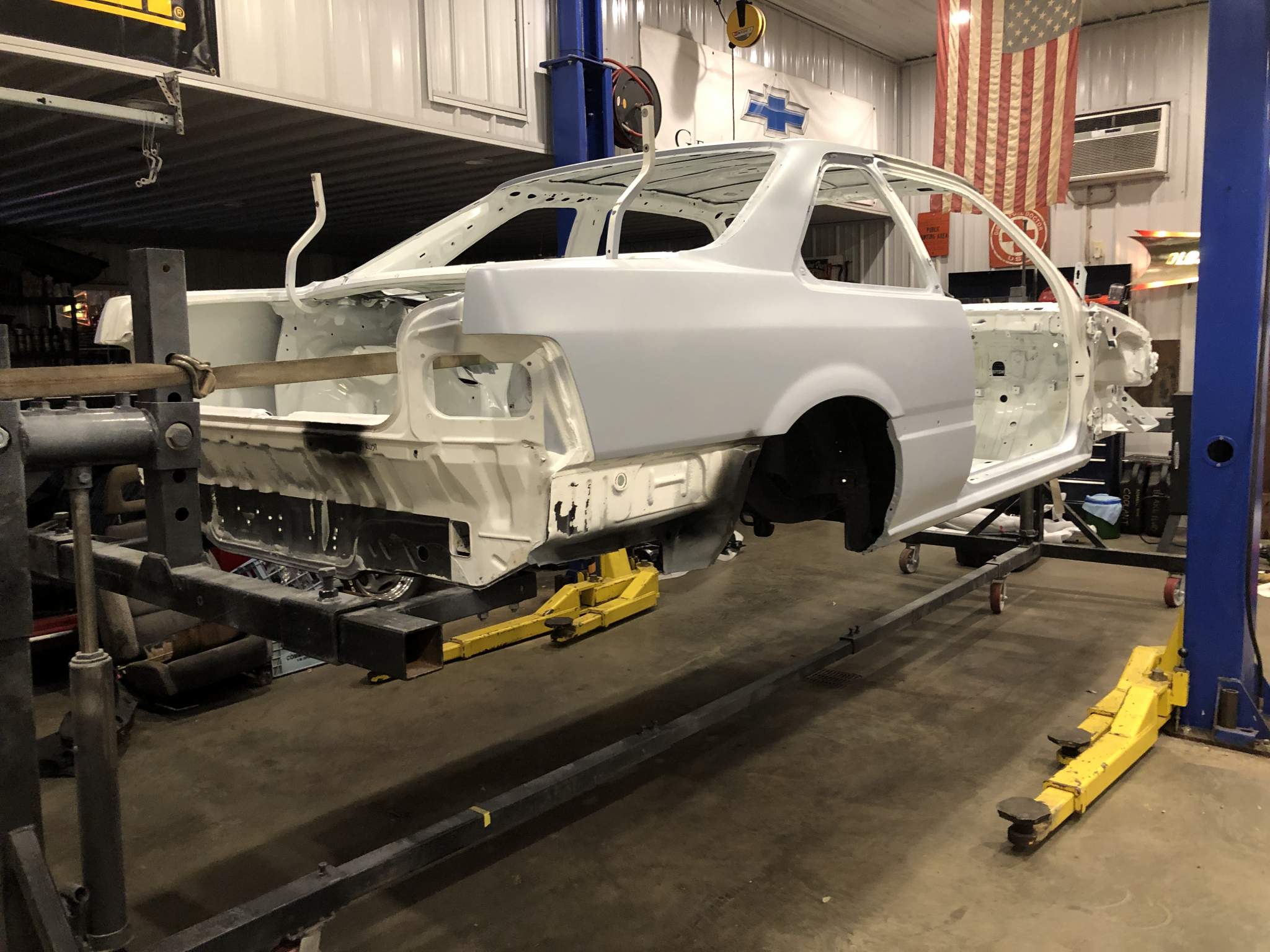

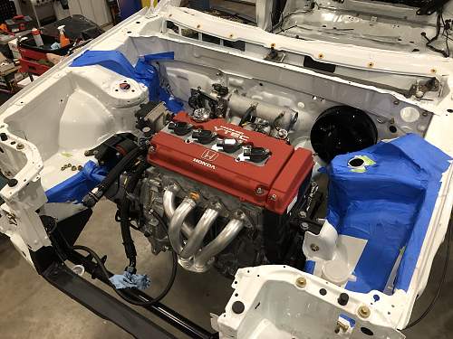

    Okay, so let’s FINALLY talk about what’s been going on at the body shop for the car I’ve been doing all this for. The car has really moved along since I dropped it off and it has been super exciting. Let’s start at the engine bay and keep moving. The bay has been fully welded up as necessary and smoothed, and there’s a pretty large number of clean delete plates in welded in, plugged holes, and check out the added humps that give us a ton more clearance for the upper control arms. Flipping sweeeet.

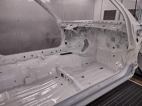

    Then, final paint was laid down in the engine bay, and this photo doesn’t do it NEARLY enough justice as to how smooth and shiny everything is.

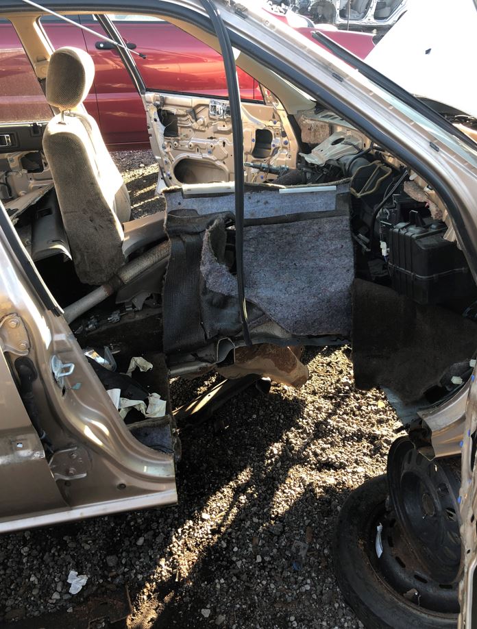

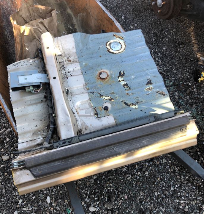

    Oh, and here’s an odd aside- I went junkyarding! Turns out there was rust on my floorpan that needed to be fixed, and it’d be better to just find a clean OE section over having it fabbed- so guess what- BRRRRRT and the poor sedan in Ann Arbor got blitzed.
    See, CHUNK. The rust I had was right in front of that seat reinforcement frame rail, and amazingly, this sedan has absolutely NOTHING left from rust in the rocker, but floorpan was immaculate.

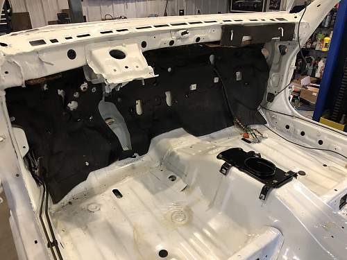

    And lastly, paint was thrown down in the trunk after a quick scuff, and while most of this will be met with sound deadening, feels very nice to have this all as a single color.

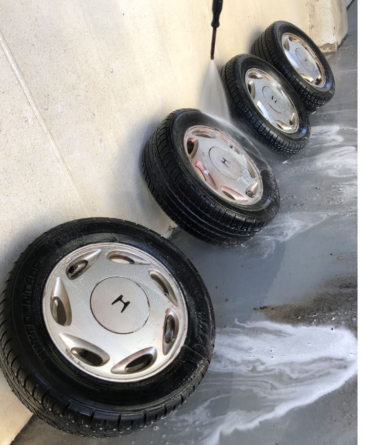

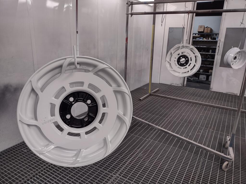

    Carrying on in Polar White, I also removed the tires and fully sandblasted all four of the turbinas- why? While the paint on them was all fresh (which made stripping them down EONS easier), it was just a few shades off- and frankly, might as well do it right, I can do 90% of the work in house, so- might as well just do it and make the car that much more complete.

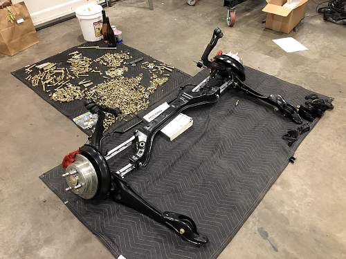

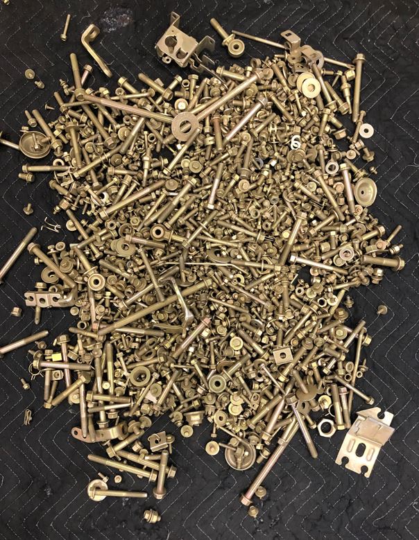

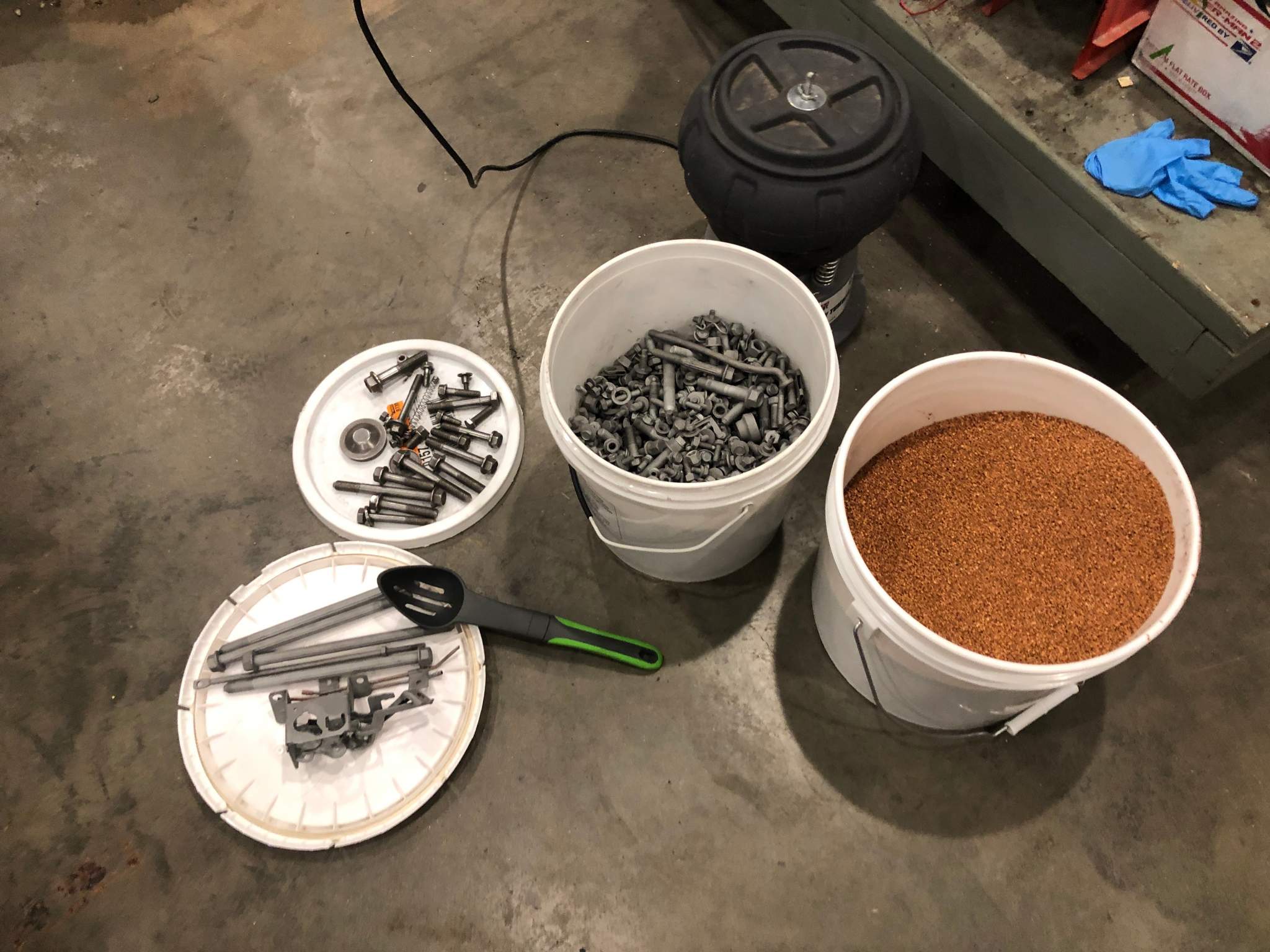

    And carrying on, Lets start with hardware- the corn cob media worked wonders on the hardware, and has just been dropped off to get plated today! Here’s the setup- bolts coming out of the sandblaster, thrown in the polisher, then vetted out after a day of polishing and hand cleaned and tapped all individually then they’re ready to go.
    Here's a photo showing just how much a difference the polisher makes, literally takes these from a true matte to a nice sheen! It’s awesome! And, I just finished all the polishing and cleaning at 2am last night, and dropped off the parts to get plated this morning! Hoooopefully they’ll be done before Christmas and I can spend the break ASSEMBLING.
    And so- I’ve got the Accord back, but no real hardware to assemble it with. I bought a couple hundred plated 10mms a while ago, so I’ve been able to install a lot of small stuff, a lot of small powdercoated brackets and the sort. And all the GROMMETS. I can’t express how fulfilling it was to be installing brand new grommets on such a clean chassis, the high is UNREAL. Worth pointing out- the washer tank had some grime and undercoating on it from its days on the road, and some steel wool really, really cleaned it up. Still has some yellowing, but considering you can’t get these new, I’m pretty pleased with how this came out.

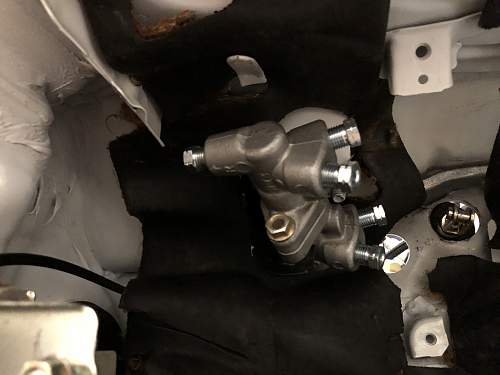

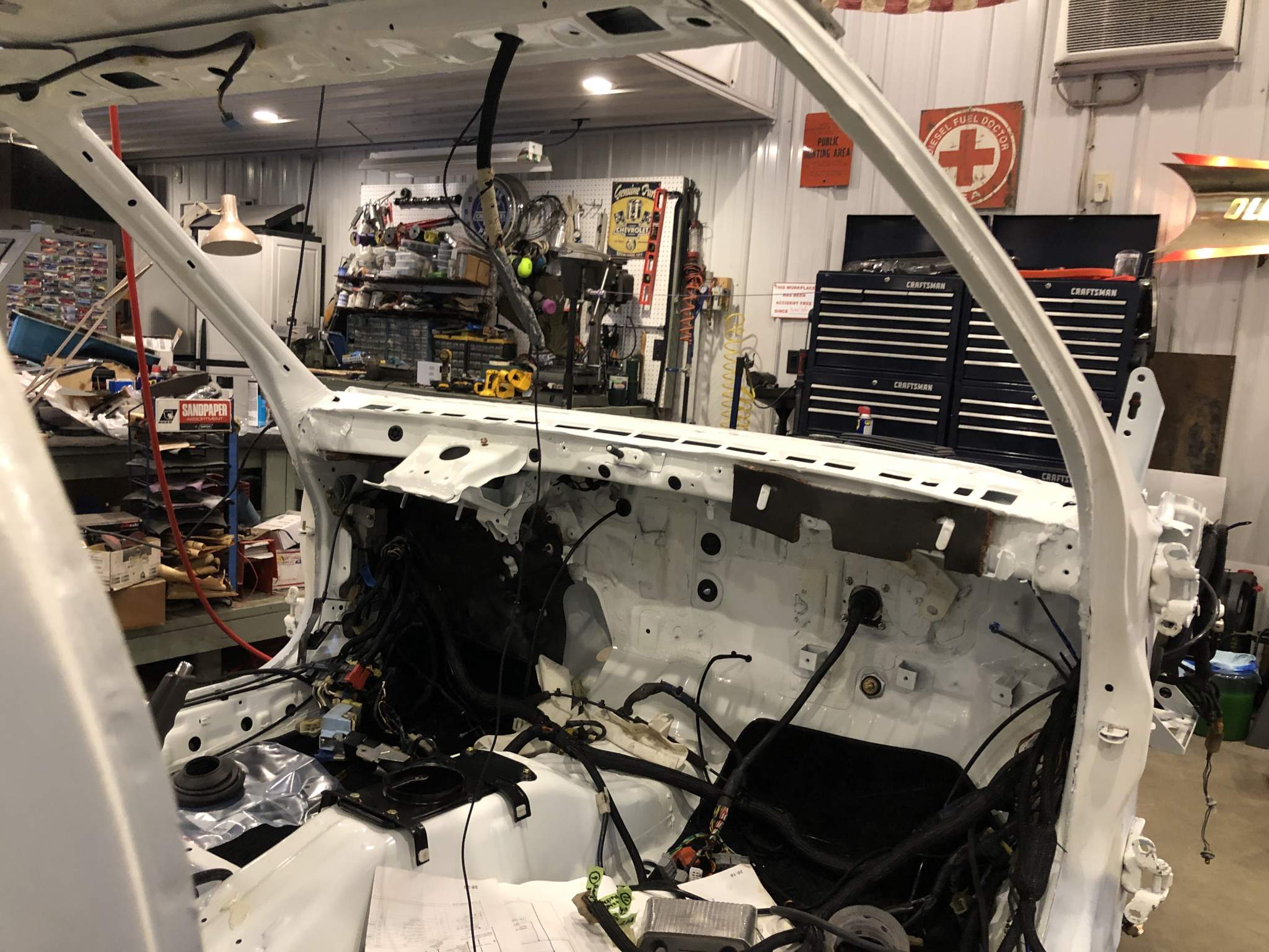

    The lil black grommets really pop in the engine bay, and installing the rywire bulkhead nearly made me ruin a set of pants, everything just looks SO GOOD. Can’t WAIT to get hardware back and put the motor in place.

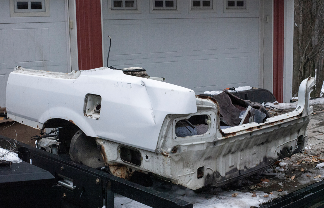

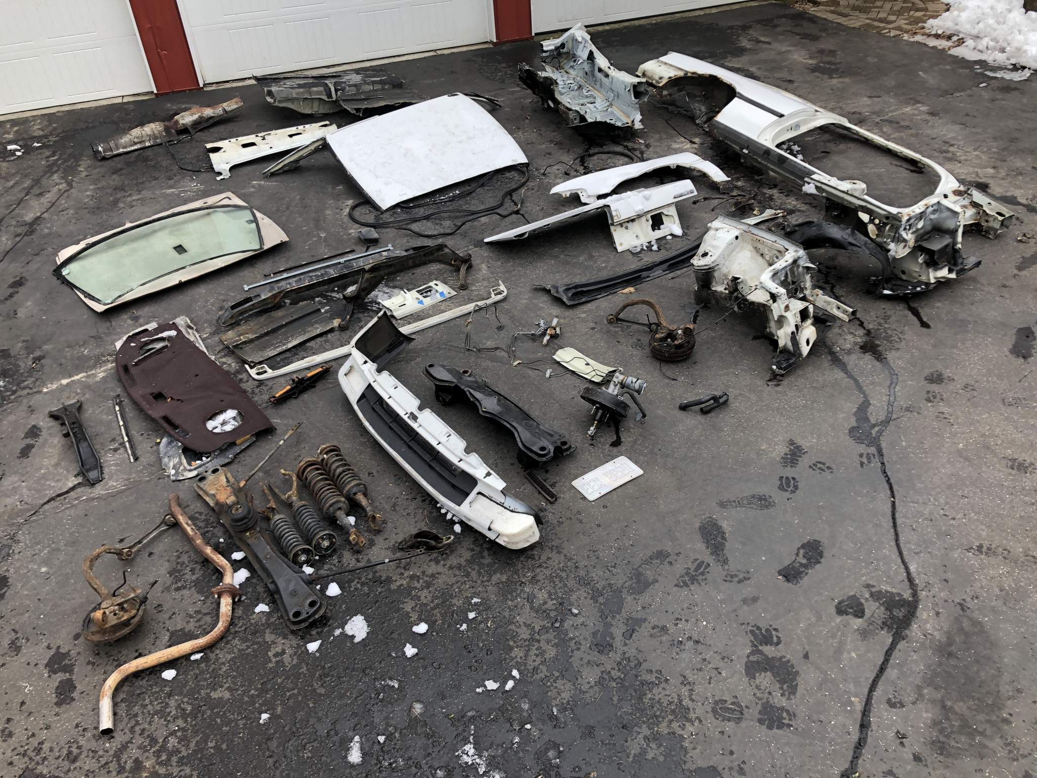

    And, so we dropped off those chunks at our metal recyecling plant and made a healthy 80 dollars (woah), and there ends the epic saga of my first car.

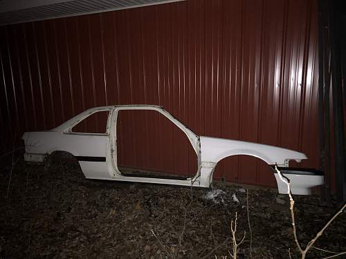

    Orrrrrrr did it? Thought had crossed my mind to maaaaaybe keep some barn art around and sneak a chunk of the car away from the scrap yard (well, along with the firewall with the VIN on it). And so here's a fun piece of quarterpanel! Don't really have a plan for it, might hang it up in a friends barn or something! And to answer your question, yes I still have both doors for it! Could definitely donate one to the cause.

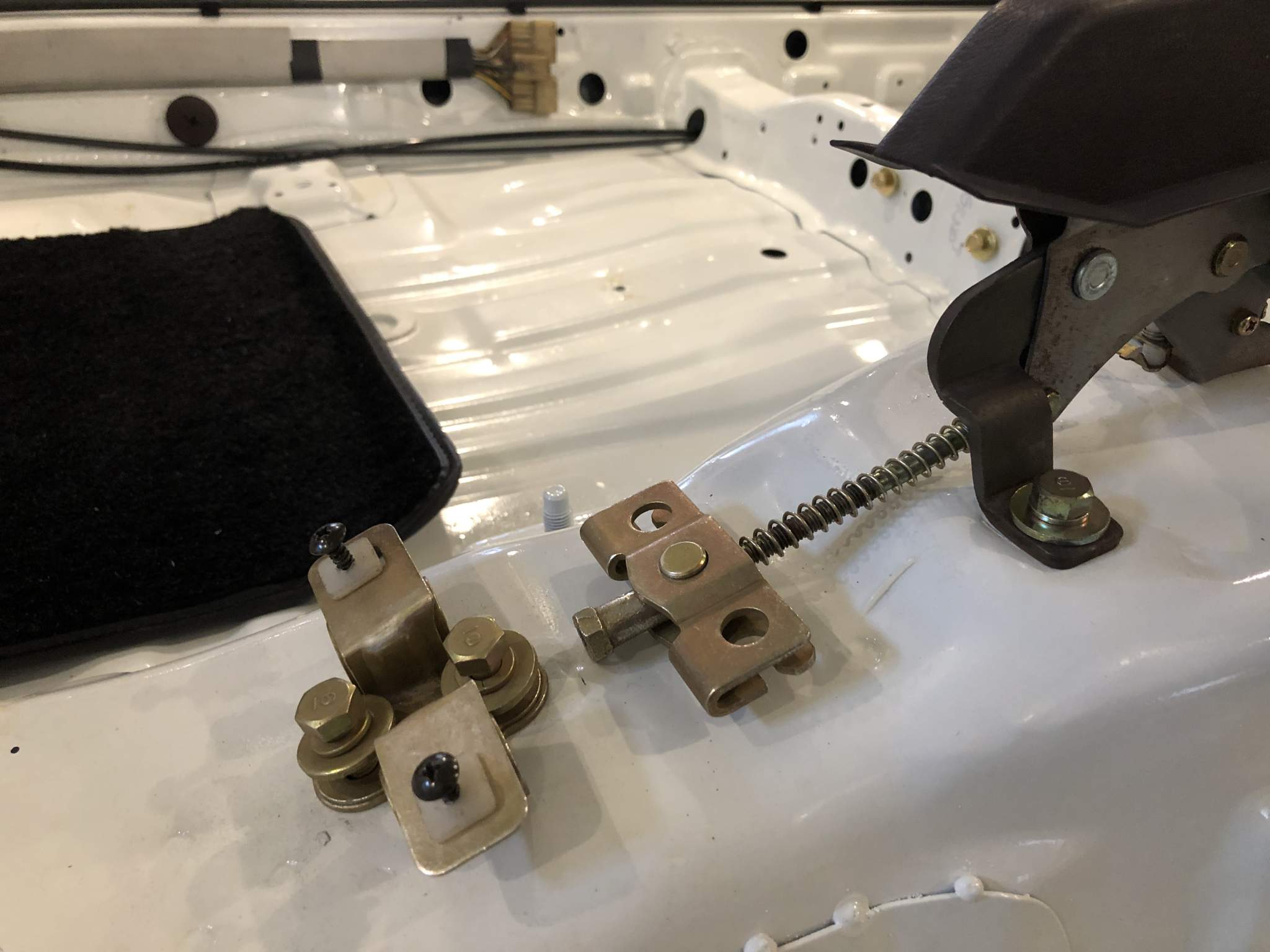

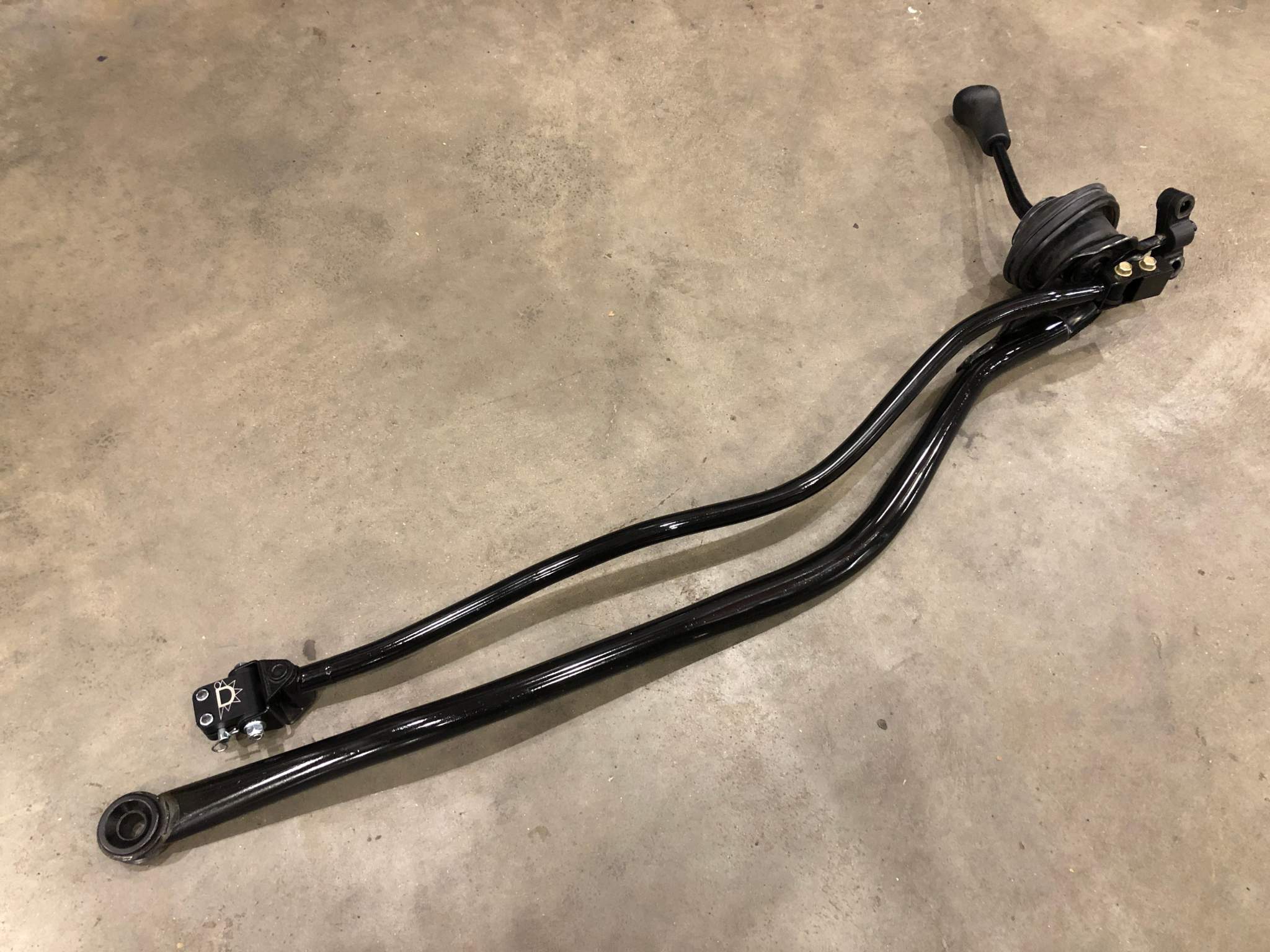

    First thing I sifted out was the e-brake linkage, which for some reason has been something that has enraptured my brain for no real reason- but I LOVE the way this looks (Still gotta tighten those bolts, I know!)

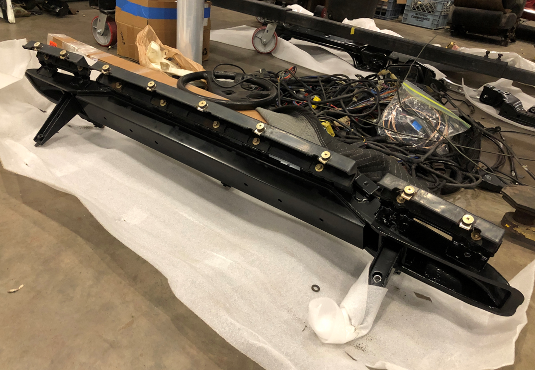

    Another part that is now adorned in gold, is the rear bumper support! I honestly can't believe I had just enough screws (considering the way they love to rust and freeze into place) to fully load the part. Fortunately the front end has a unique set of hardware, so I don't need to worry about that bumper.

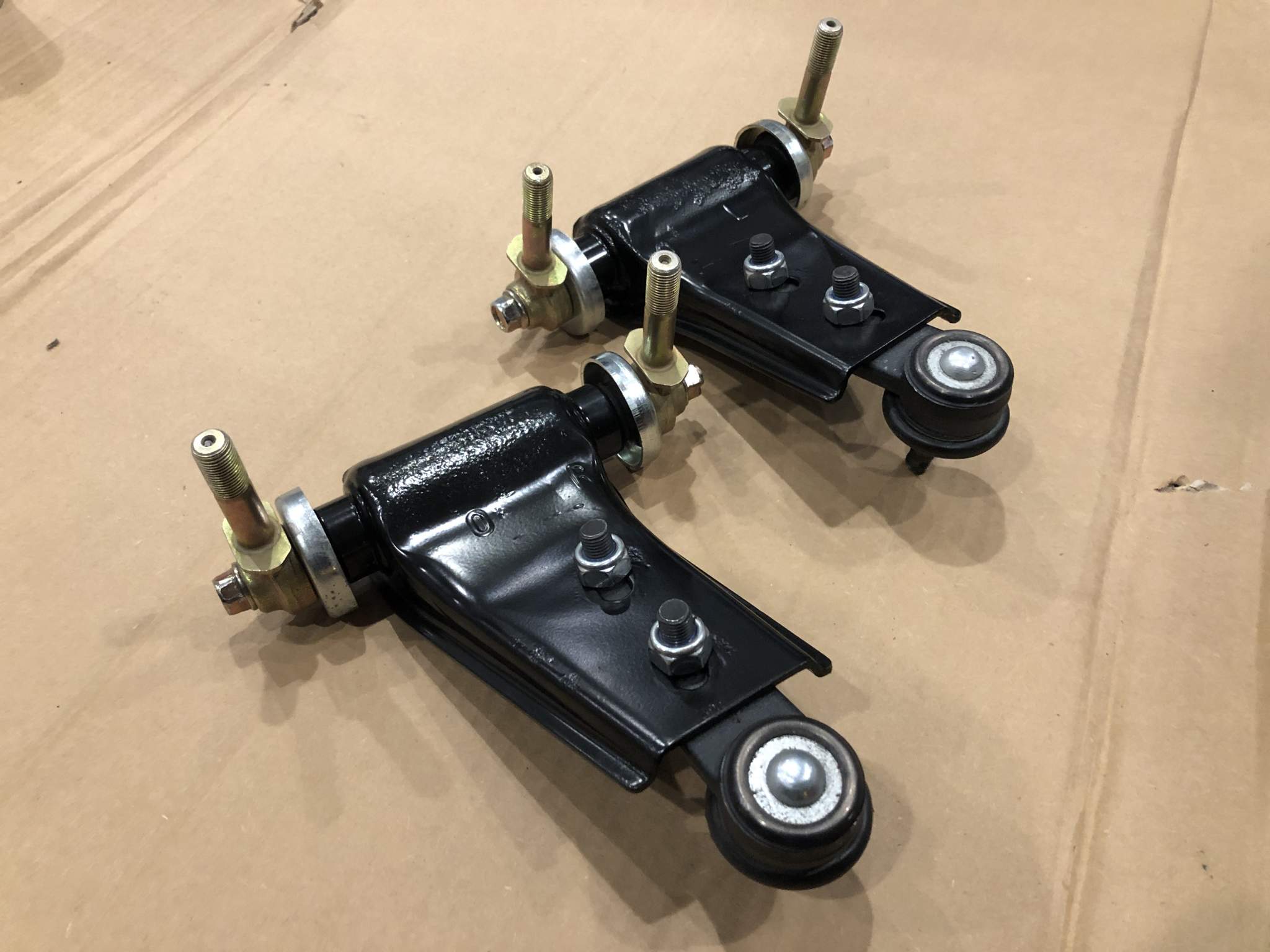

    The front 2G prelude arms also got a refresh- I had sandblasted and only spraypainted the bodies, so those went through the powdercoating process, and I grabbed the cast banjo bolts (?) that capture the arm from the B-Cord and had those plated, and BOY do these look good. I don't have enough images to show the way these package into the clearance bumps that the shop made, but I can assure you, it is more than enough, another project, done to completion!

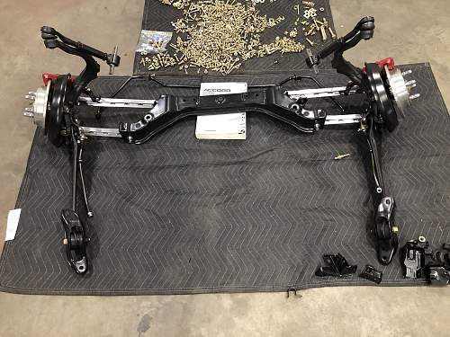

    And speaking of suspension, the cheddas arms finally showed up, which, along with the hardware means the rear suspension can be fully assembled! I resprayed the rear calipers red to match the front Wilwoods (which I personally think looks a bit flashy with all the gold and silver, but I'm not complaining. A lot of powdercoated parts also found their homes with this assembly, which is great! Love seeing this come together.

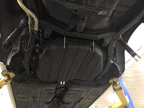

    Now hopping onto the chassis, the gas tank received a clean then a new layer of undercoating over the old, and was subsequently mounted in the car! Takes a squint, but the plated J hooks and filler neck really pop here! Glad to have it all hooked up!

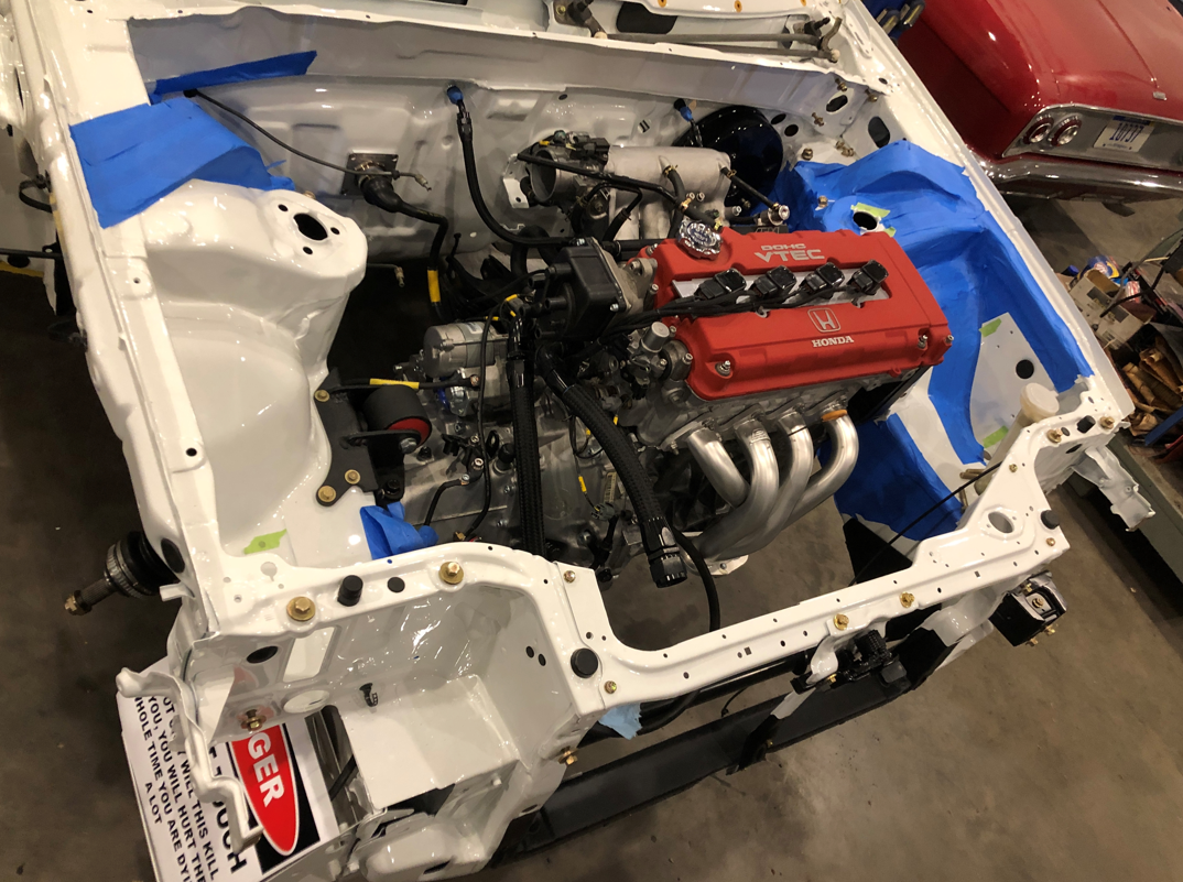

    So, last photo of the night, but here's the engine bay after some more fiddling, some of the larger lines are in place, the wiring harness connected, along with the core support. Frankly, some more suspension, the radiator, a few power motors and the bay should be pretty much fully populated. I'm also going to bring this up here as a prelude to future posts, but we've decided to do a brake line tuck- for those of you who know where this is- there's a power antenna mount that my base model car doesn't put to use allllll the way at the top left corner of the firewall almost behind the brake booster. The plan is to put the prop valve there, then run join the rear lines halfway with some hardlines along the inside of the firewall, and make some slim fronts! Gotta clean it all up! But anyways, here's where we're at for now! Can't wait to PEEL THAT TAPE.
    I want to make a little asterix here, the motor is only held in by two mounts at the moment, the rear T bracket is floating as the rear subframe is still out of the car at the moment. Now, there were plans to adapt the B series power steering pump to all the factory Accord lines, but due to a very surprising turn of events, A 3Gee Facebook member from Canada very recently reached out to me with a special thing from his parts car- and gave me a lead on a manual steering rack! For those of you who don't know, Canada got a now very rare, very base form of the 3Gee without power steering, and every car in the US came with power steering along with practically all of the Canadian models as well, so I think it's easy to imagine how tough this part is to come across. Naturally I enjoy the perks of a power rack, but would love to empty out the engine bay further, and a manual rack is a great silver bullet for keeping things functional while still emptying out the bay! From my understanding there's some custom bracketry that needs to be done to adapt it to a power steering subframe, but that's right up my alley. I figure with an alloy block instead of a cast iron one (and a general de-cluttering of the bay) there'll be a bit less weight over the front axles which should also alleviate some of the discomfort that comes with a manual rack. So we'll see if that comes through- I, for one, am quite looking forward to it if it all works out, and I'd also love to make that mod NOW, before I've got a huge install I need to deal with.

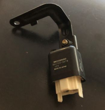

    How come this guy isn't plugging all of us on manual racks??
    What is the difference with the reverse switches?
    Also, nice danger sign for the battery.
    I'll be honest- I have no idea how I won the crown to be gifted with such a gem as a manual rack- I mean this 100% that the guy came out of the wood work on one of my older facebook posts and says he enjoys the build and has a car that should have one. Sounds like one is all we got, and there's DEFINITELY people I'd assume he'd have gone to first!
    To answer the question on reverse switches: Both the older DA integra and newer DC2 use the same two wires coming from the switch going into the trans. The only difference is the connector- the DA has two induvial circle connectors- one for each wire. A lot like those crimp on style ones you can get in off the shelf connector kits. The DC2 uses an actual injection molded plug to house both wires (and therefore, unique pins from the DA, so there's no moving the DC2 style plug onto the DA) and so does the Rywire harness. Since I have a cable trans, it came with the DA switch. Everything's a science!
    And haaaa, thanks! Christmas gift I still need to find a home for. Definitely sticking there for now!

    The driver’s side harness is so much less to manage, and received the same lift around the arch, so I’ll use this photo to show off the front crash bar and fog light brackets (which admittedly are super hard to see at this point) but I gotta say, fresh powdercoat sure rubs me the right way, really geeked to see it in place. You can also see both fog lights pointing down from the their zip-tied positions on the mounting brackets, definitely useful for keeping them where I want them. The headlight buckets are going to be out of the car for quite some time, shop has the main connecting brackets to paint white, so no eyeballs until the shop gets to it.

    Looking rearward, there’s a new harness in town, and that’s the combination of the subwoofer and air ride harness! You’d have to go way back in this thread to see the bundle of wires that lived there originally, but let’s just say it was a bit of a mess getting the air ride harness to package proper, like it fit the space, just looked awful. But now, after rewrapping everything, that harness fits the place perfectly, the relays in each corner of the wheel liner stamping fit well, and the main bundle tucks between the brake line and seat support perfect! Very clean and tidy, just how I like it! There’s still a couple sub-harness’ left I still need to sort, but that was a big one!

    So something much simpler that’s been moving along is the shift linkage, which caught a massive upgrade due to the generosity from my Dad over Christmas. For those of you who don’t know- this is a Dyno Designs Tyrannosaur Tightener (which I think is a very weird motif to have for your company, but who I am I to judge), a moderately expensive- but HIGHLY worthwhile mod. This removes the part commonly known as the bitch pin and replaces it with an easy to use coder pin, along with a milled aluminum housing over the factory casting, with improved bushings. We also did this upgrade to the 87 Civic a while back- and turned the car from nearly literally undrivable to an absolute pleasure! I’ve gone through and rebuilt the main ball of the shifter, along with new rubber bushings front and rear, and the shift rods have just finished absorbing a simple coat of black paint and clear- while it’s not the same powdercoated perfection that most of the other parts received, the linkage was in good shape, the original coating solid, but just kinda scuffed up. But- between new paint, some cad plated hardware, fresh bushings, new shift linkage connector, intact boots, and that quality teg shift knob, I’d say this is pretty much a sorted part!

    Oh! And another thing! Tires are back on the Manarays! They’ll be staying in storage until the car is fully painted, but they’re ready to go, and look STELLAR.

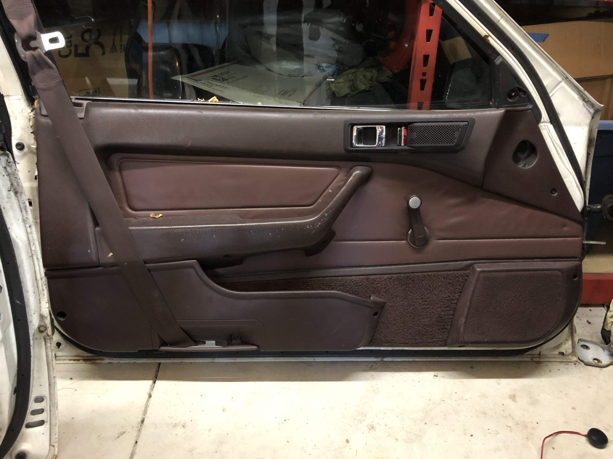

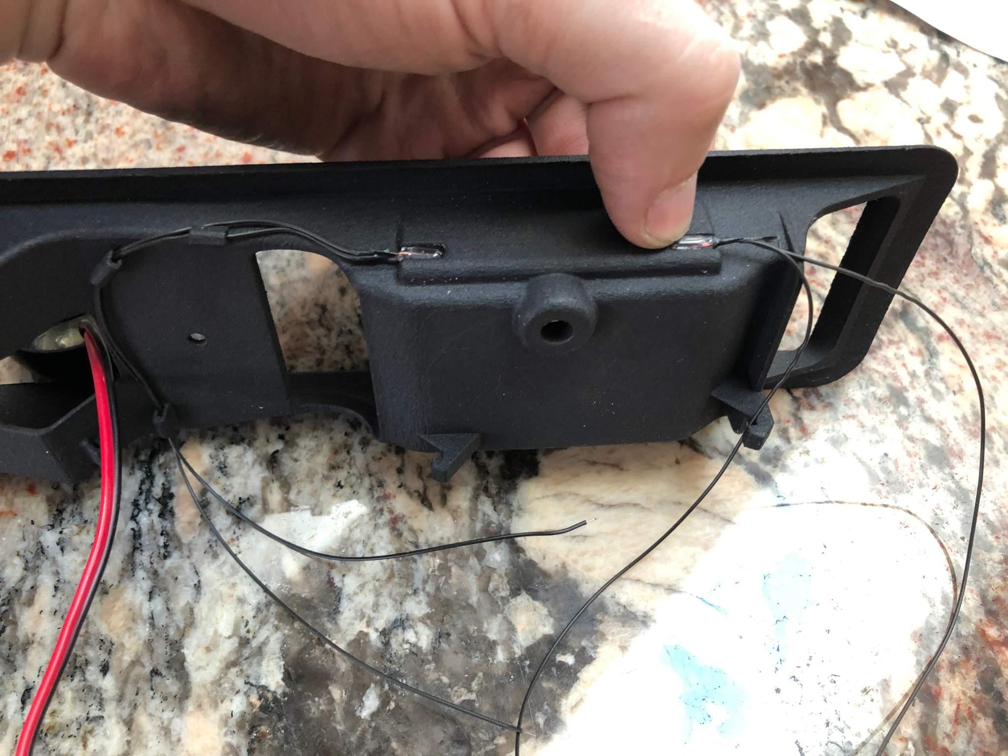

    One of the features I’m excited to be integrating is a way to illuminate the door handle, I’m always worried that lighting can be corny, but I think this is a pretty subtle way to bring make the interior a bit fancier without being too much. I’ve designed these bezels to fit two grain of wheat bulbs which gives it a nice calm glow, but these are rated for 1.5v, and would get incinerated at a steady 12v output, and simplicity is key, I really don’t want to have to add a whole chip, or row of capacitors to try and stunt power. So plan B is grab an LED and center it in the handle. Since it’s much brighter I’m going to be reducing the size of the slit for light to leak through, physically restricting the amount of light that comes through the handle.

    And pardon the potato grade photo, low-light doesn’t play well with my camera, but here’s the jist of the lighting with the twin halogen setup. The LED is a much cooler light, but I think won’t oversaturate the space if I control the slit properly.
    I have more photos I can share, but I’m going to make a series of changes first before this part is seen again, so stay tuned on that front!

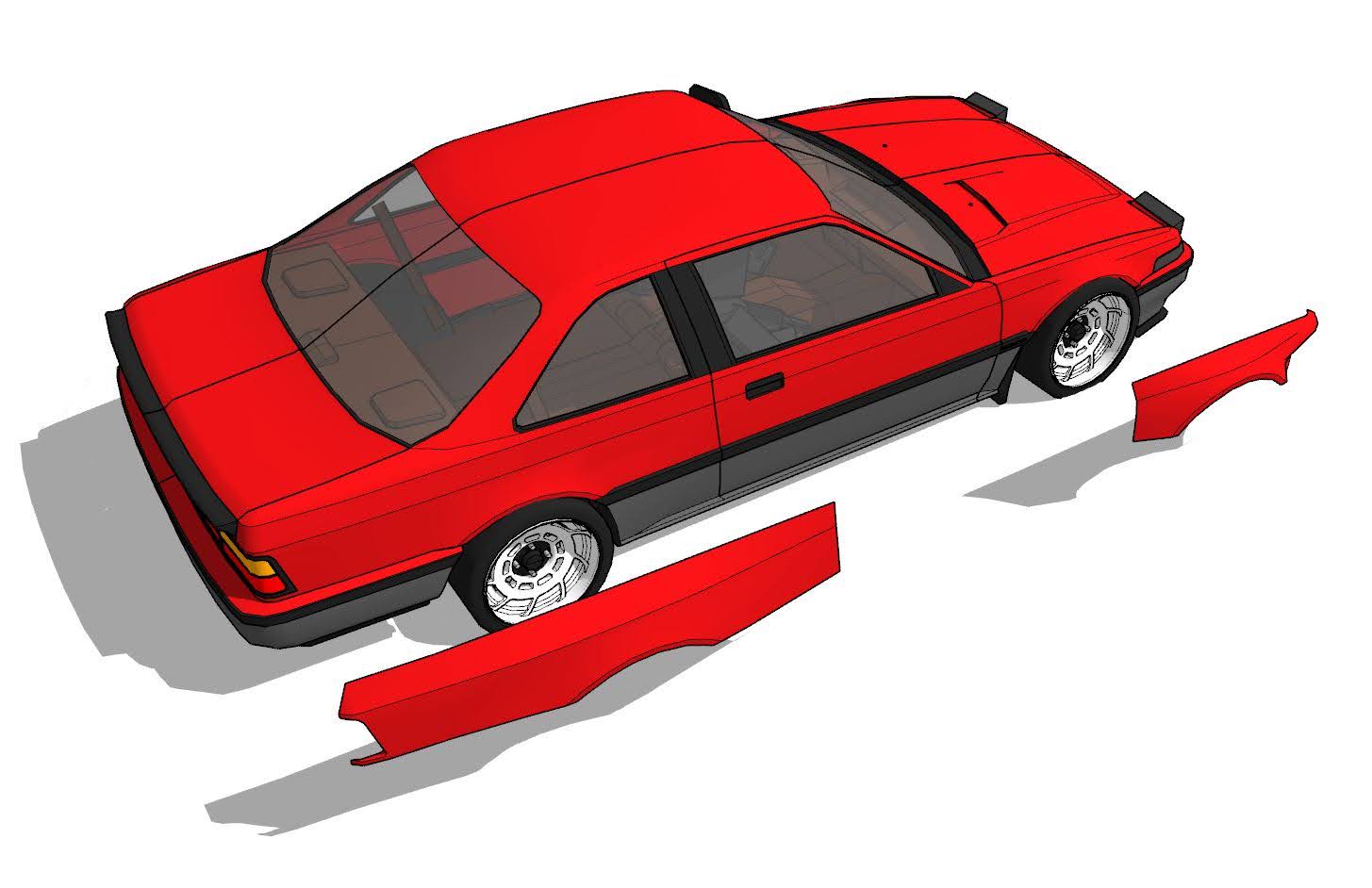

    Also, I hate mission creep! This is how it always goes. I’ve had this little murmer of a thought that’ll pass through my head some 10:30 odd time at night, it’ll rattle around for MONTHS until I somehow find an odd evening to flesh it out a little, and then the next few weeks I’ll be absolutely consumed figuring out how to make whatever part or concept I have come to fruition. And now normally, that’s a good thing! That’s what’s been my driving force for the tweeter project, and so many other odd parts on this vehicle (another example is clear turn signals for the Prelude bumper- it’s lead me down to learning a LOT about mold making and casting, as well as a bunch about resin 3D printing, at the expense of many hours of sleep. But more on that much later). But what if that same process happens on… well- not a bad idea, but something that really should not be a priority at the moment? Like, maybe over-fenders for example? That’s right. I’m not sure when or why I wanted to do this, but I’ve always liked the look of E30’s, or E36’s and some simple overfenders to fit some more tread. So- call it an hour of clicking later to come up with the idea, and MAN- I am ENRAPTURED.
    They wouldn’t be much, just two flares over the belt line on the car, keep it simple. But then, after doodling it, the more I thought about it, I could TOTALLY do that. I could 100% do that. (Not on the A-Cord, that car is far too nice to be chopping out the quarters, and I like the Manarays too much.) But, listen- I have EXACTLY what I’d need for it- I’d need to get a car 3D scanned-specifically a quarter panel and fender, and guess what I have sitting behind a barn, the answer is about halfway up this very forum post. I have the chunks of the B-Cord, a perfect buck to form panels onto. Jeez, lighting strike! There’s two ways I could go about this, I could hand form the kit in foam and have that scanned, or just scan the blank body and build something strictly in data and save myself the mess of foam. THEN, once I’ve got data made, I could probably call up my college and since they’ve got huge mills for milling students car designs, I could probably sneak a way into there and make bucks, then it’s just a problem of laying fiberglass! SEE. This is what happens, brain just starts spooling up and now I want to do this.
    So should this ever become a reality? Nah. But who knows. I could keep it in the back of my mind. If I were to pursue it, I think the build would go like this- I’d love to find an LX-I coupe (probably just a decent shell), cut out the rust, find a pre-built B20 (probably with a turbo), drop that in, gut the interior and just put some MEAT on the wheels. I could let myself cut a lot of corners, and also use a lot of parts I have sitting around to spice it up (carbon fiber hood, Prelude bumpers, spare 3D printed spoiler, you name it!) to make it sweet, and have something I’d be less worried about whipping on a track, and with a decent amount of power. That said, I’m plenty thin on cash, and more than drenched in terms of projects.

  21. #371
    Re: Bagged B18 '88 DX Coupe Build!
    Wide body kit for a 3g Accord? Hmmmmm......
    PS: not really feeling the rear visors. But it's not my car so do what you think is best.
  22. #372
    B0CKS's Avatar
    Jul 2016
    1988 DX Coupe
    Detroit MI
    334
    Nah, I hear you there, in and out of love with them every other day.
    Maybe in some distant different future! Been shopping around a bit, and it'd be really nice to pack some 15x10.5"s wrapped in some 275/35/r15s around a CA, and finally have enough grip for all that A20 power!

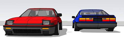

    Alright! Trying to stay up to date on this! Haven’t been near the car much this past week and am only writing short sentences, so forgive the lack of hard and fast “progress”. But, still wanna make a post so I can get a lead on it for next week!
    Fact is, I’ve been crunching numbers and just saving about as much as I can, making as much as I do in a year- I’ll be able to get the car back to the bodyshop in ~September in more or the less the state that it’s in right now to get the rest of the paint finished. Which basically means I have months and months to do a relatively short list of projects, so I’m gonna be pretty spaced out on progress. So expect a lot of digital updates- I’ll have good amounts of time to model stuff, print and reprint, and hopefully square up side projects.

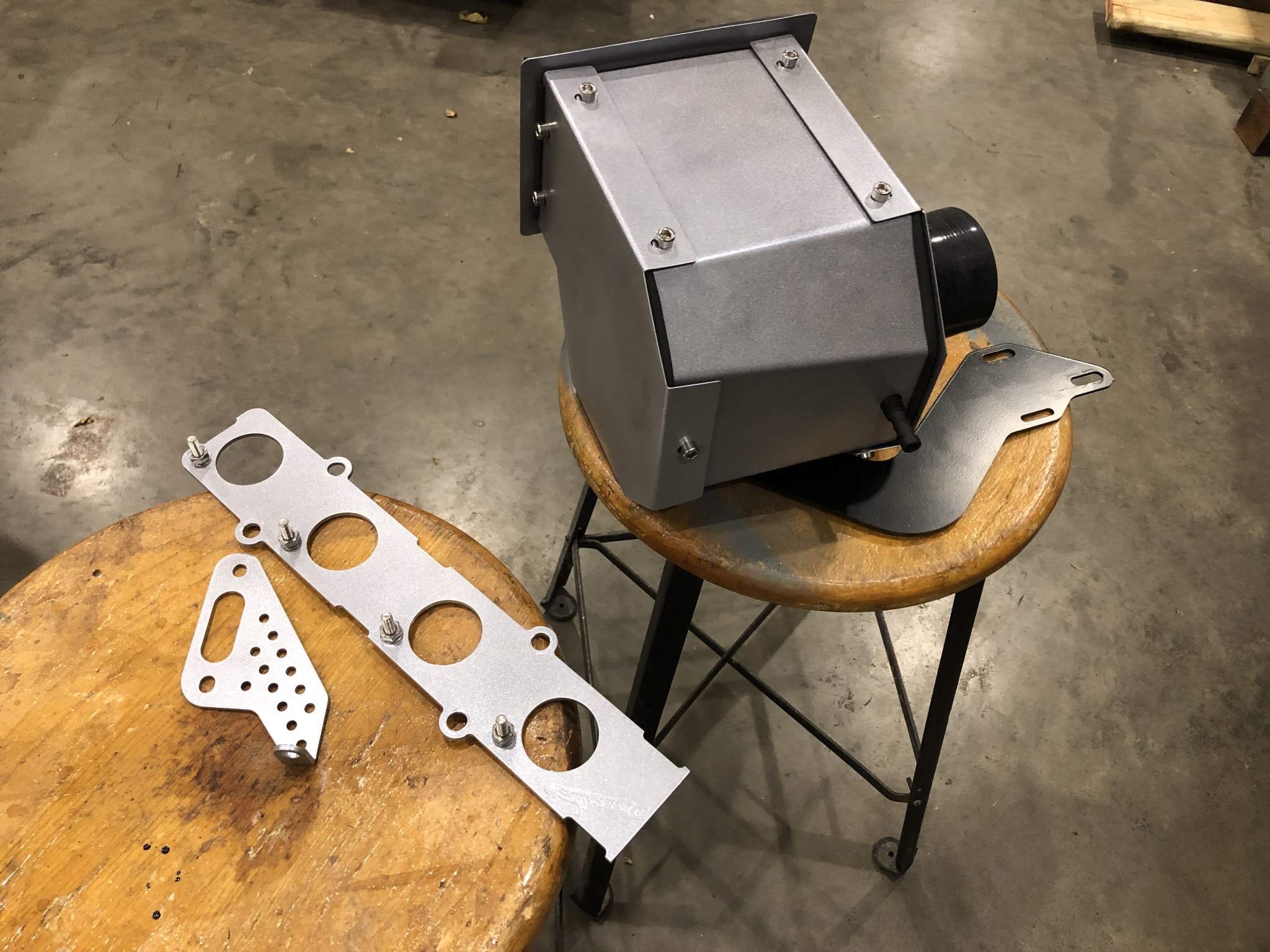

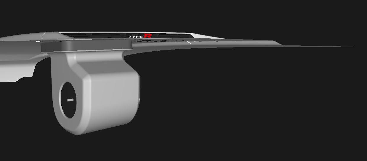

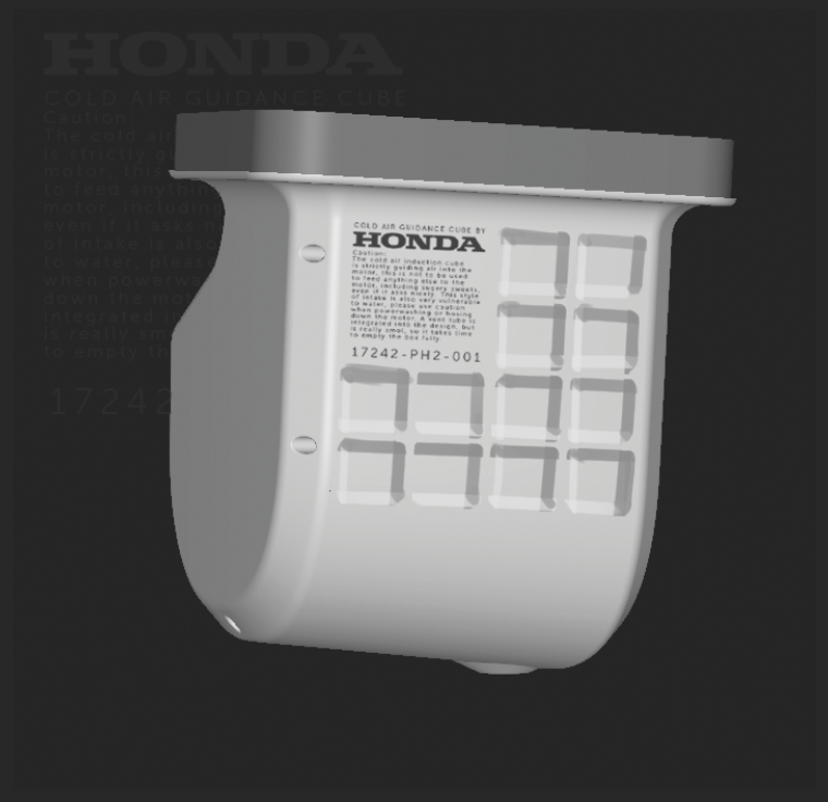

    Which leads me perfectly to the first project, the (like…fifth) redesign of the airbox, this time as a 3D print! I think I already wrote this, but in short, current airbox is suuuuper clunky looking, a print gives me acres more design freedom, thus- it’s going for a redesign! I’ve got the math started on it, and looking from the rear view forward, here’s about the jist of the shape. Biggest change from “box” I want to make is adding chamfers around both edges, and then adding a large strip of foam to the top of the box. I think the thin tape of weatherstripping I had didn’t include enough jounce for my motor mounts (and the LUDICRIS AMOUNTS OF POWER) so I’m going the old school route and just added a fro to the top of the box. Taking notes from muscle cars, like shaker hoods, or classic Ram Air air cleaners. (my hood included for fun):
    Then as for the front- I’d like to utilize that design freedom to do SOMETHING with, rather than just a blank wall. I’ve been trying to look at factory airboxes, intake tubes, and the VTEC Valve Cover for inspiration, and would like to do something that at least fakes the look of a believable “factory” part. I don’t think I’ve found THE theme for it yet, so I need to put some more sketches together, but here’s a first barrage into what I’m thinking.
    Pointing out my favorites here, seems like first pick (a bit of a crowd favorite, according to friends and family) is this here- the side cover still needs to be removable, and while we considered factory A20 air cleaner retainers, alans, the idea with this is that it uses a bit of a rail system and a key, so all you need to do is pluck the little red guy out of the front, and the side slides forward and off to access the filter. No tools necessary! I like the simplicity, and spark of red would be a cool touch (or maybe yellow or something???)
    Second theme that I’m kinda digging is the waffle design, very much a factory look. And while its not perfectly “clean” I think you at a glance it has the right look to it, and I could probably go further to add texture to wrap the side as well. A few of these have blocks of text on them, and I’ve been getting into building models lately, and want to put decals on everything, so HYA. That said- having Honda on the airbox is kinda redundant since the valve cover says it better, and I don’t think being repetitive with it will do much good, so that detail will probably be nixed, but I do like the look for the sake of sketches.
    In third place, I was toying with the idea of putting like trans-tunnel wrap over the face to give the airbox a sorta functional pop. I like it in my mind’s eye, but it definitely goes a bit too far into showcar/racecar territory for my liking, although it’d look at home in like a SEMA booth or something. Maybe I’ll print 2 lmao.
    So I’m still I’m sketching on it, and will probably have more work to show as we go, but in the meantime- what do you guys like? Any of these stand out?
