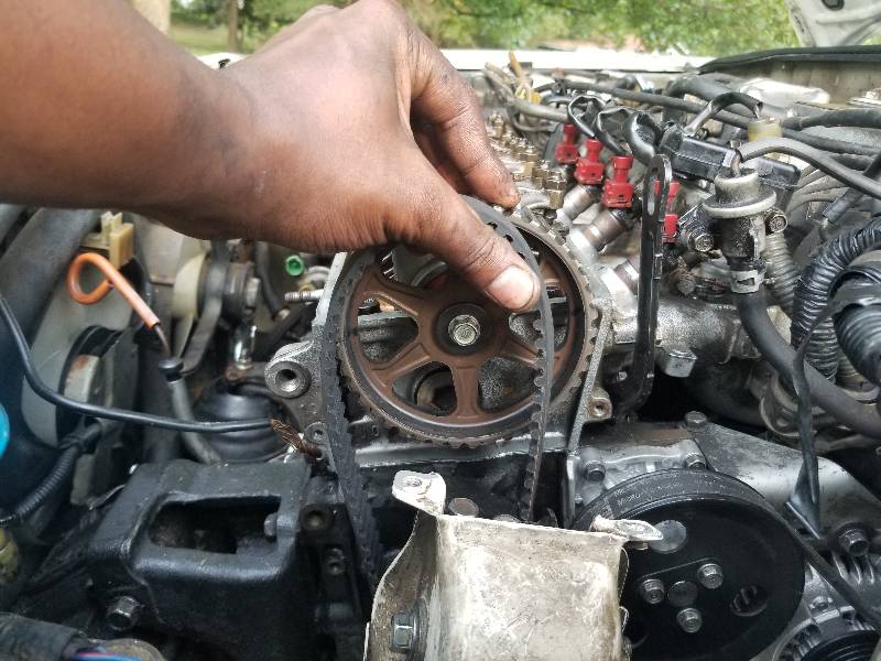

    i must say. that was the weirdest, most frustrating timing belt i've ever had to put on. why couldnt they have made this any easier.. dont see how some of you guys say the belt " slipped off and slipped on".. i've read that on here. the real question is now... judging by these photos, is my engine out of time????

    Re: silly thread, best way to get front left motor mount realigned
    The belt has to be tensioned so you'll have to struggle with it one way or another. You can take the spring off the tensioner, set the belt and then try to manhandle that spring back on while reaching down into the engine bay with needle-nosed pliers an no clearance, or you can leave the tensioner sprung and do it that way. It needs to be tight on the front side of the car. Put the first few belt ribs on the cam gear at the front. That will line everything up so you won't lose TDC, even if the pulleys move. Then just like you were doing, walk the belt bit by bit over top of the gear. It's the best way I've found to do it because it doesn't involve contorting your hands at funny angles down deep in the bay.

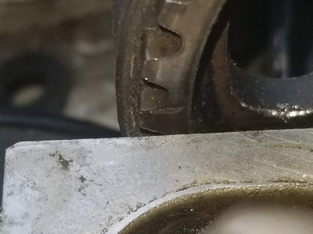

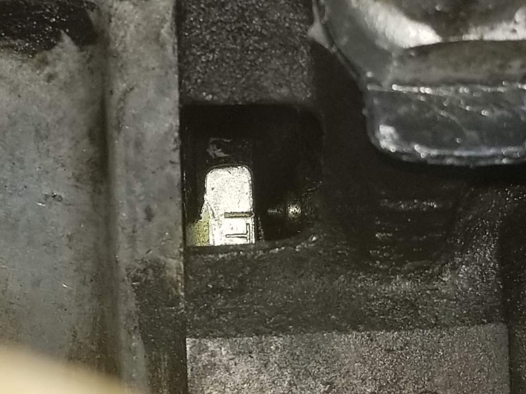

    Two dash marks behind cam pulley aligned to cylinder head though " up "is not directly in the middle.. slightly to the left, engine directly on white timing mark above "T" . Just gonna run it and see what happens. I dont ever want to do that again for a while

    yeah looks like you're off a little bit. it's a royal pain in the ass to get it right. when taking pictures try holding your phone at a different angle like upside down then went how you usually take them

    This is how it currently is

    Look close enough to me lol
