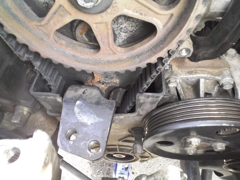

    well, I decided to go for it, starting with the timing belt, which has been really chewed up. As I was taking the side engine mount off I noticed it was really loose on the engine.
    Turns out, the part that it bolts into has completely broken off, and there were chunks of rusty iron bouncing around in my lower timing belt cover. It's just filled with dust from rubber and iron. Im not sure how to reattach the engine mount or what at this point.
    Any crazy ideas welcome.

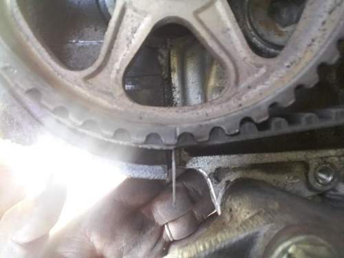

    quick question: got the cam at TDC but not sure how to tell if the crank is lined up. theres a little dot on it and a little groove nearby but they're not lined up. please help!Click image for larger version.

    Are you saying you broke a bolt off the mount bracket? If so, you'll have to extract it. Which will be fun given the tight quarters. You'll need an extractor kit, a right-angle drill and some patience. but it can be done. Try to hit it with a bunch of Liquid Wrench in the hours before you try to extract it. If the bracket itself is broken, then just get another from the junkyard.
    For the crank, you're looking for a line with a "T" next to it in the timing hole on the trans bell housing.

    no, I didnt break anything. One of the protrusions that the bolt screws into on the engine block had broken off. I suppose this is why the belt was so shredded.
    I used a longer bolt and blue threadlocker and padded that gap with rubber washers and replaced the mount. I think excessive shaking might have caused this, so i loosened and retorqued the front mount before tightening the new one on the side. I've seen some good tips for the shaking on here I'll have to investigate more. And I took the A/C compressor out to lighten the load by that sketchy mount.
    But I got the belt on! I dont have a white mark or anything on my crank, couldn't find the arrow either, but the key lines up with the "up" on the cam and the valve-cover bolt.

    These motors have a lot of vibration. I am fighting oil pan bolts that keep backing out on mine. It's why Honda started using balance shafts on the 1990 Accord re-design. For us, we just need to use more Loctite and less anti-seize.
    The crank marks can be hard to see. There is a lot of grease, rust, dirt and etc. on them by now. Last time I did mine, I had to shine a light down the hole and glob a paint pen over the marks to be able to see them. I'm sure I'll have to do it again by the next time too. Harbor Freight has a timing light for $30 if you want to give it a whirl.

    Had something similar happen to the gold accord I had before. The part of the block that juts out in between the timing belt that the actual mount then bolts to broke off and sent chunks of iron through the belt. One piece about the size of a dime got up to the cam sprocket and broke 3 of the arms of the gear itself. Destroyed the plastic cover with it. Engine was still running though even with a half broken cam gear. It was toast though cause there was no way to fix the part of the block that had broken off.
    When you said something about the protrusion off the block breaking, that was the first thing I thought of and winced. Glad yours wasn't as engine killing as mine was.

    Thanks for the vote of confidence Doc! Oh and i finally found confirmation in the Chilton manual that the key lining up with the cam's Top mark means we're lined up!
    Damn InAccordance, now I feel lucky I didnt lose any teeth in this mess! Heres a pic of the break, and one of the aluminum chunks being lodged into the lower belt cover for the morbid:

    Yea, you got lucky, on the one I had, that whole piece broke off entirely rendering the engine unusable.
    I'd be worried about that though, seems like the mounting point would be weakened like that.
