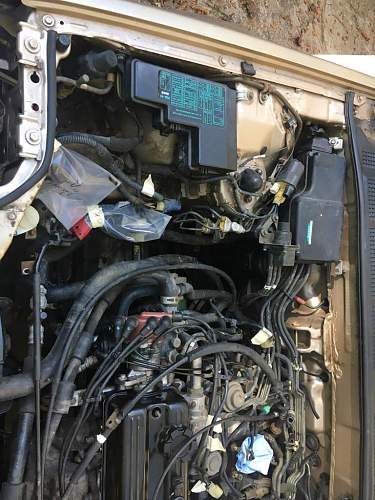

ID:	9124Pulled battery out, air cleaner assembly and carburetor. Pulled all belts and valve cover. Progress during the week will be slower than I'd like since I only have an couple of hours of daylight once I get home from work. Under valve cover looks pretty good considering it's age but it doesn't have THAT many miles, sitting at 173k.

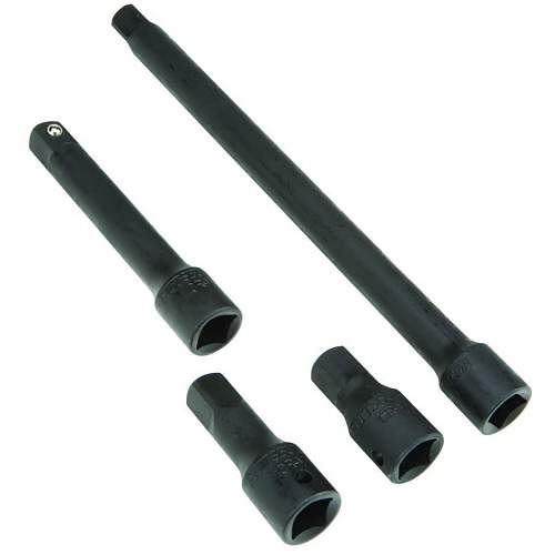

    If you have a manual, put it in 5th gear and set the parking brake. If you the car jacked up, drop a screwdriver or a drift punch or something hard into one of the vanes on each brake rotor so that they jam against the caliper brackets. That trick works great in junkyards when you don't have anything other than basic hand tools with you and need to stop a wheel from turning.
    On the autos, I have a set of these guys: https://www.harborfreight.com/4-pc-1...set-67972.html
    I insert one into the timing hole on the trans bellhousing and it jams the drive plate. The flared end is big enough that it won't fall completely down into the bellhousing, so you'll be able to remove it when you're done. I use another of the extensions to get at the pulley bolt through the fender hole. If you put them all together, you can get your breaker bar out past the fender and get a better angle on it (though I don't recommend extending the socket out if you have a really stuck bolt).

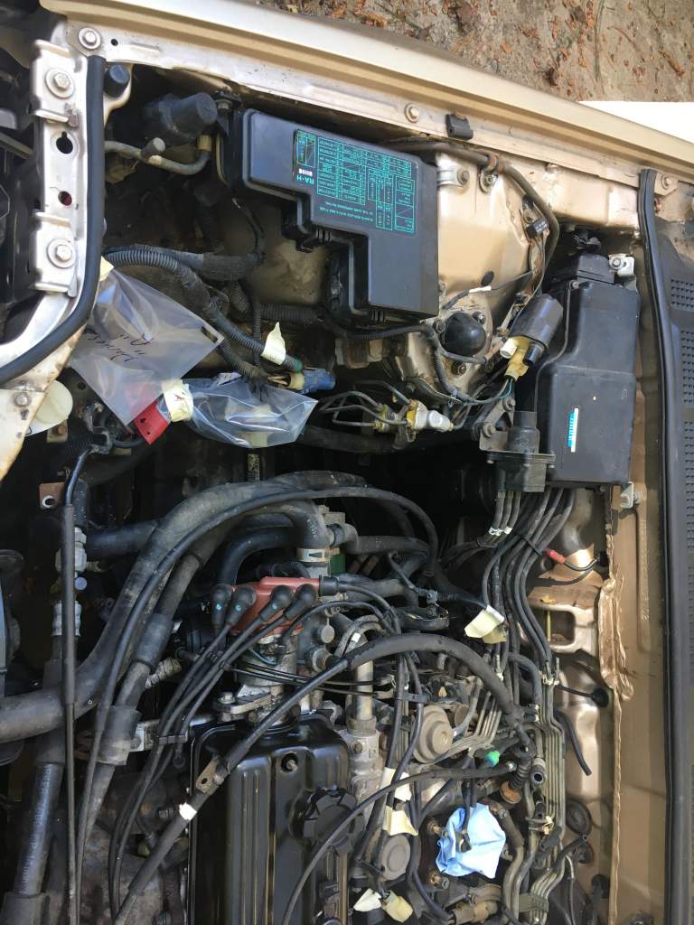

ID:	9138 rained here the last 2 days, hurt progress a little bit. i got some work done on sat but didn't have a chance to update yet. i appreciate all the feedback about the crank pulley bolt, ill take that into consideration once i get to that stage. I am assuming its not reverse thread??
