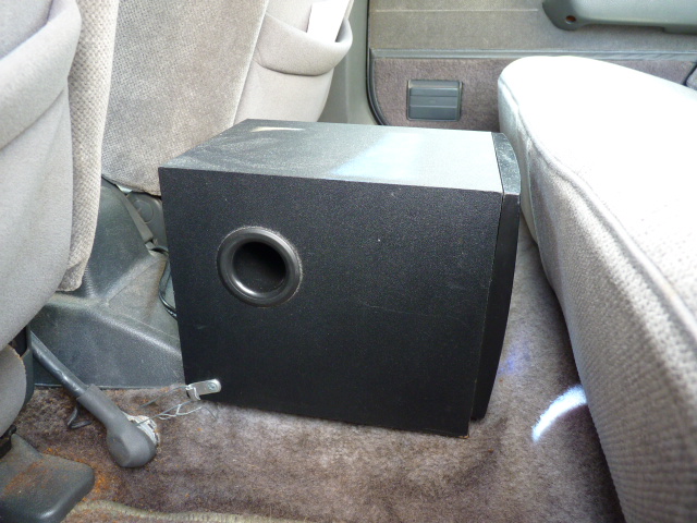

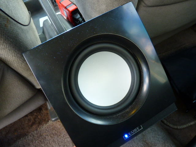

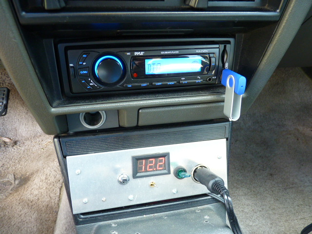

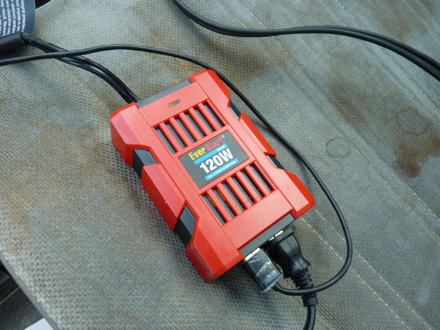

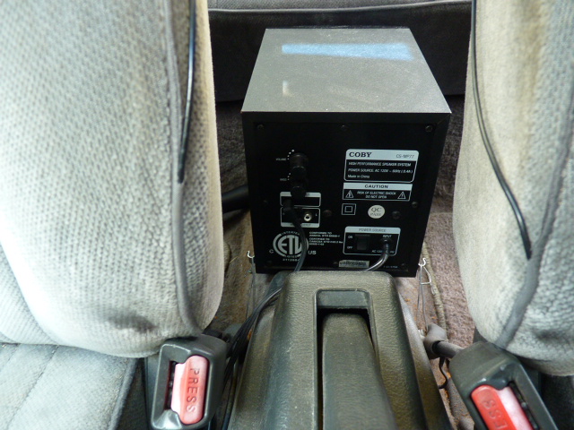

    Ok, some pics for my setup...
    The inverter also has USB charging port, great for my phone. The inverter is plugged into my custom electrical panel, which is switched on only when engine is running. I don't have to manually turning on or off the inverter.

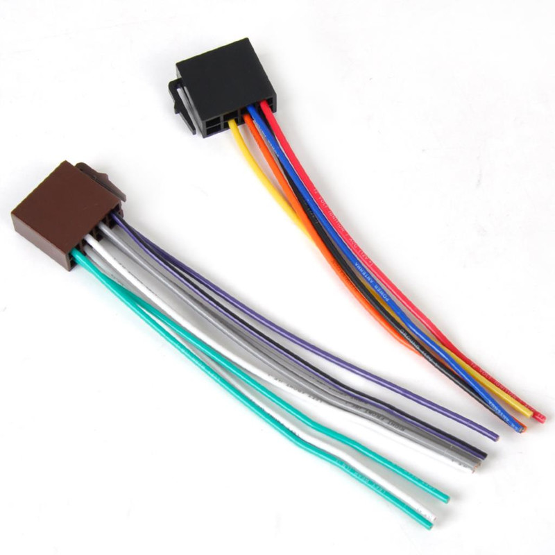

    In the past 10-15 years (or maybe 20 years), the aftermarket head unit manufacturers adopt a standardized connector format. The radio comes with its hardness with the standardized connector which plugs into the back of the radio. I usually will cut the OEM connector, solder and heat shrink the standardized connector hardness and that's it. You just unplug from the back of the radio when you need to remove the dash. My latest radio was a replacement to the previous aftermarket radio because I want blue tooth and the installation was a plug and play with of the standardized connector.
    In the older days, the aftermarket radios have a bunch of wires (11 to be exact if no antenna motor control) coming out from its back so this will be a problem if you have to remove dash later on.

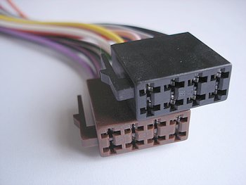

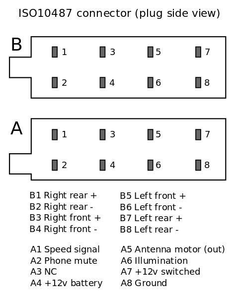

    I changed my head unit few years back. The one got replaced was Blaupunkt, the new one was the Pyle. I was preparing to cut wires again but when I looked at the manual of both radios, the connectors for both the old and new radios were totally identical in terms of dimension and pin assignments. It was basically a plug and play.
    Those are called ISO connector.
Name:	ISO connector.jpg
ID:	9140   Click image for larger version.
