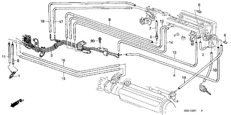

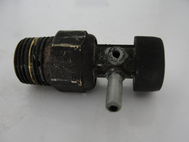

    Well, before I swap the dizzy, I was thinking about cleaning the injectors first. I followed the manual cleaning method for the injectors and they are now cleaned. Its hard to tell if one of the injectors were dirty. For that one injector, it took me a couple of tries to force injector cleaner through it after applying voltage to it. But at the end, they are all good passing injector cleaner.
    Then I broke this part during reassembly (see pics, 2 from another member). FSM has no reference to this part on the thermostat housing. FSM only show A20A4 engine which does not have it. Mine is A20A3 so its different. Its a thermo-switch with 2 ports, labelles as "1" on the lower left side of the vacuum diagram Have absolutely no idea what it is for. I can see from the other member's picture, the vacuum hoses were disconnected and "jumped" through the small metal vacuum pipes with a short U shape hose.
    Anyway, I JB welded mine back together and will put new vacuum hoses for connection....
    Update: put the thermo-switch back together, top off coolant and road test after cleaning the injectors - absolutely no change, so dirty injector idea has been ruled out. Wait for a warmer day to switch out dizzy stuffs....
