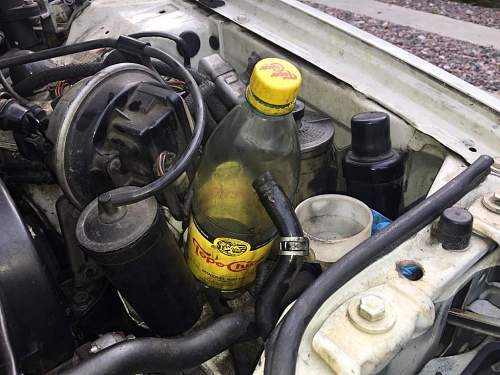

So far, got the car up, wheels off, banged out the tie rod ends (probably gonna replace those too), removed the crossmember bar and exhaust from header to catalytic converter. Since my power steering system is contaminated, I ran 3 bottles of honda power steering fluid 1 at a time through the system, turning the engine on (before removing exhaust!) steering hard left to hard right, and catching the fluid out the return hose.
Catching the fluid was a challenge, ended up cutting a hole in a bottle:
