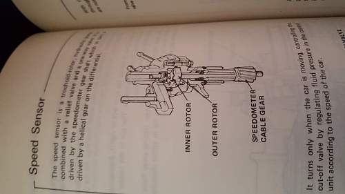

    Here's an update after a few months. I got the transmission rebuilt, and repainted the shift linkage, brackets, pedal assembly, etc. I don't have much pictures. Mostly I've been gathering parts and now I can get going with the project. This weekend I started removing the automatic and ended up getting stuck on the converter plate bolts. I will get that part figured out though.
    The only thing I'm not so sure about is the speed sensor and how to re-route the power steering lines. The manual speed sensor has two lines going into it, while the automatic speed sensor has two lines similar to the manual sensor, but just one more larger line. I can't upload a picture of it for some reason though. I know some people bypass that system by looping the lines together, but that won't help with the third line hanging around.

    carotman's Avatar
    Montreal South Shore
    9,984
    Re: 84 Prelude Auto to Manual
    Isn't the larger line just a vent?
    The larger line actually refills the reservoir after reading about it. There is a pump in the speed sensor that reduces steering assist as you gain speed, so I'm thinking the two smaller lines recirculate or reduce pressure somewhere else in the system.
    That being said I'll try out using the automatic speed sensor since the one that came off the manual transmission doesn't even have a third line.
    The guy who sold me that parts car gave me a shop manual for an '83. Even the speed sensor shown there has 3 lines, so I'm starting to think that speed sensor never belonged to that car anyways. He was having issues with the power steering system's reservoir cap blowing off.

    Mine only has 2 lines on the manual trans. I 5 speed swapped it at the end of last year. Maybe it's a Prelude thing but the auto speed sensor that came off my accord only has 2 lines as well and from what I've read are not interchangeable.
    As far as I can tell, the assist reduction is done in the sensor. My evidence is that I swapped the lines by mistake recently when I had to fix my clutch. It would give me no assist at a stop but full on assist at higher speed. Doing 70 and barely touching the wheel was an adventure.
    Are you talking about the post right in the center of the sensor? Cause that's where the speedometer cable goes..
    Whenever I take a picture of the speed sensor in my car it will not upload on this site.
    I did take a picture of what it looks like in the shop manual, and its the same.
    Yes, in the picture attached before is the hole for the cable.
    Jun 2010
    967
    I've never seen one with three lines like that. Funky.
