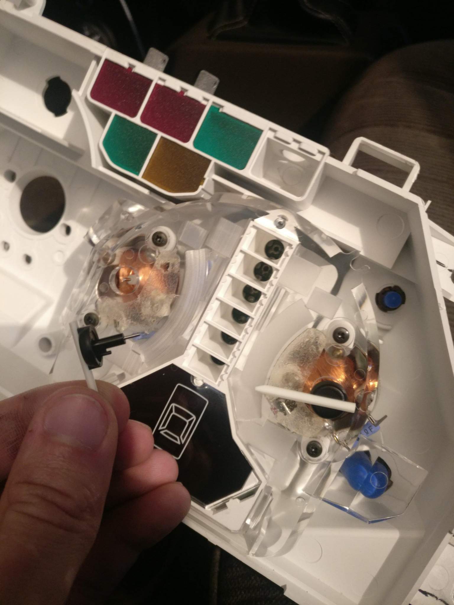

    I opened the cluster the other night to desolder the BRAKE LIGHT warning, put it back together and the fuel gauge pegs. Opened it up again and checked the voltage, looks ok just needs the needle adjusted I think. The whole shaft pulled out of the needle and it snapped when I tried to pull it out. I think the same thing happened to the coolant gauge before I opened it, I think Ive got the needle in a little better place... or it could be totally whack, idk. Pretty sure my low fuel light works... at least it worked before.
    My plan is to swap in eg/ek gauges, looks like they fit, if not its close enough to modify. I need to get a wheel speed sensor somehow though. Surely I can use the trans speedo output, it just has to drive something I can get a reading from.

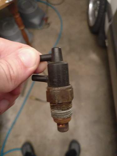

    I got my cooling fans working. Turns out the temp switch that was previously in the radiator will fit in the thermostat housing. The thread is wrong, it is not BSPT and it seals with an o ring, but it is the same diameter thread as this weird vacuum thing.
    Yes, I have no learned how to attach smaller images from imgur, please clap. By fixing this I learned my car is running extremely cool, no wonder why my temp gauge never moved. I was actually about to run a 160deg tstat in it, but idk. I want to get as much heat out of the head as I can, all I care about is my winter heat. Works fine right now even though it is 20-40deg below normal operating temp, actually based on my findings the car starts to run normally well before I see my temp gauge start to rise, so probably 140-160, it just needs to heat soak a little bit. I don't see that it will run any cooler than that. What I don't want is the normal temp tstat to open and close constantly under normal operation, trapping the pressure in the block. I am assuming the fans kick on at 220 also, not sure if thats bad or not if I am running lower than normal temps, I would think its fine on an iron block.

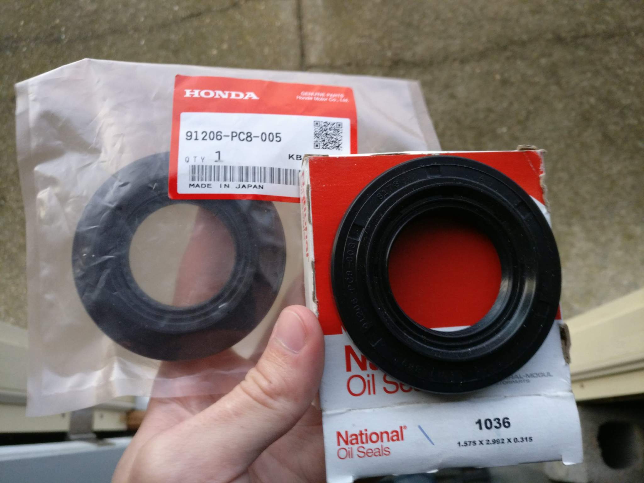

    Lastly I just want to share this: I have got the part number for the passenger side axle seal. You can still get it from Honda actually, but I got this National seal from Oreillys a while back, where it was listed as a seal for the AT, its the same seal. Honda 91206-PC8-005 or National 1036.

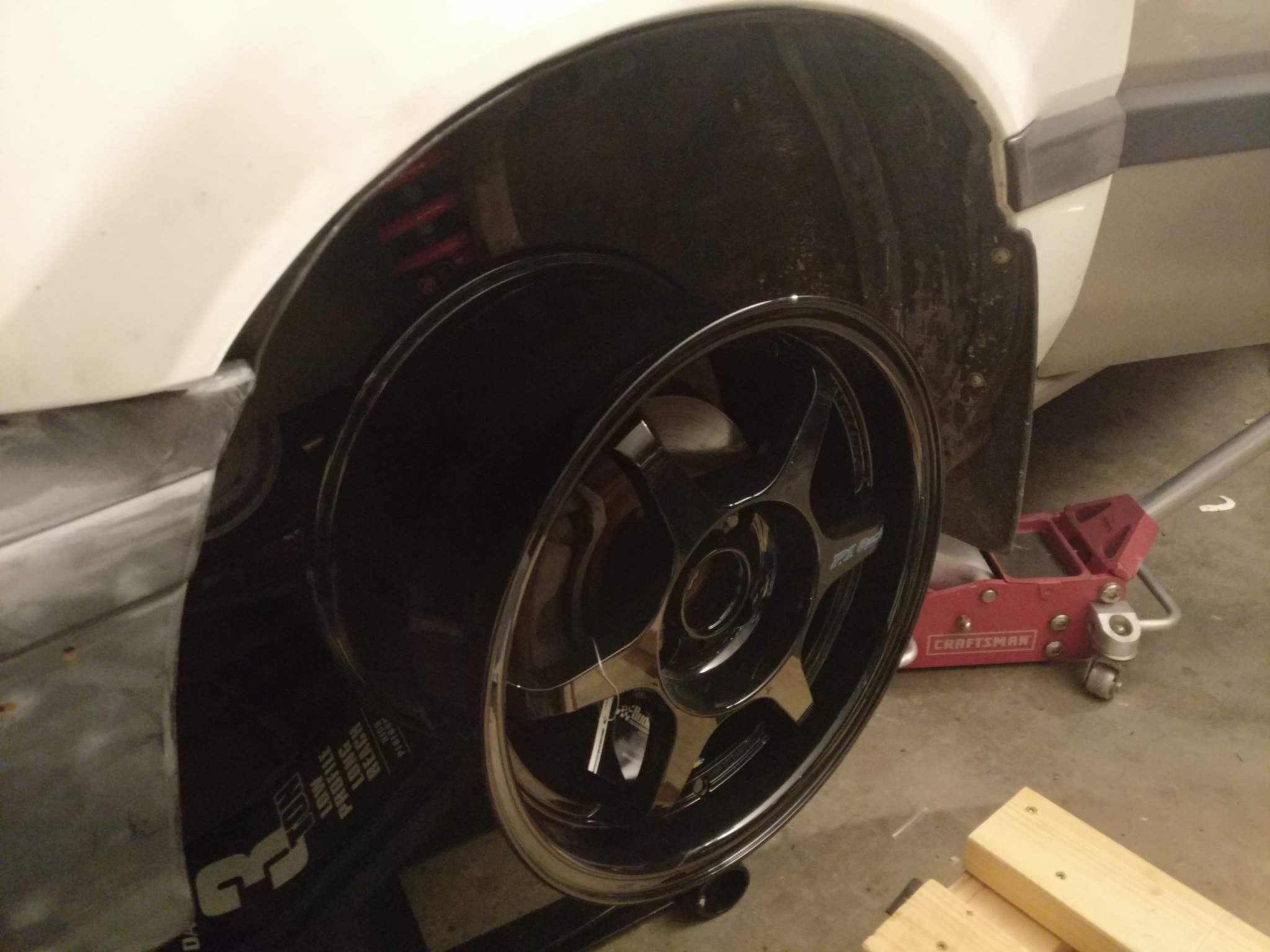

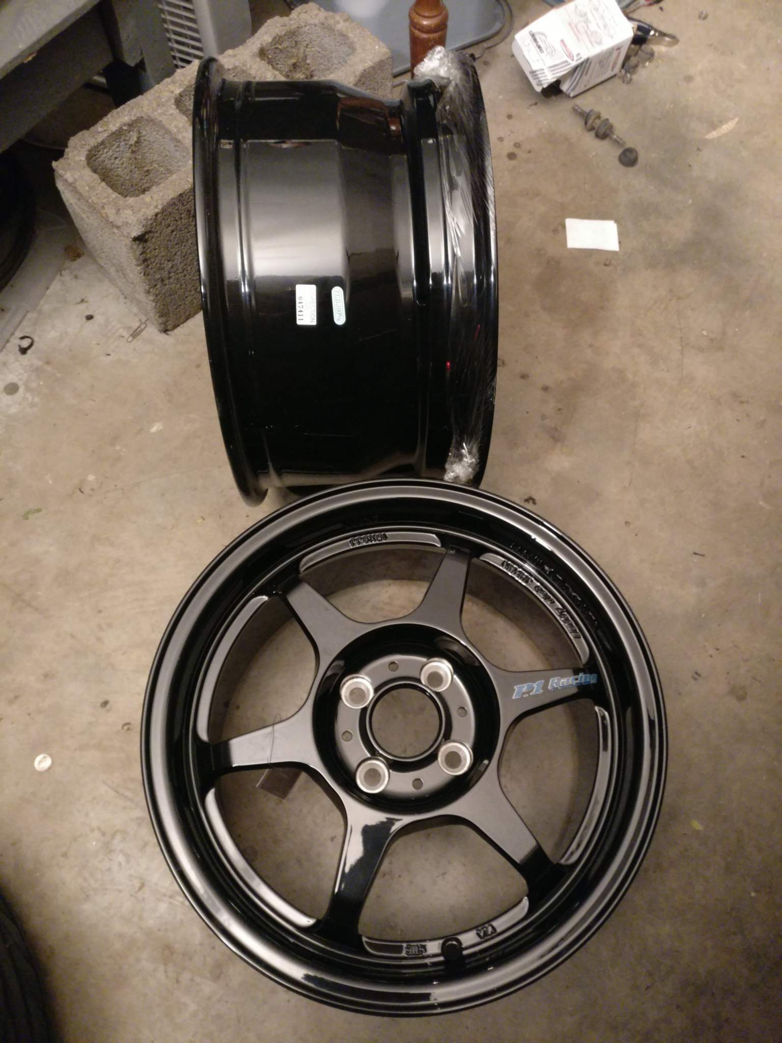

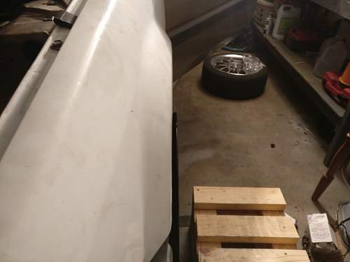

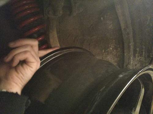

    Buddy club SF 15x8+32JJ, will mount a 225/45r15, probably Nankang CR-1. I don't think fitment can be any tighter than this lol.
    At a later date I might get a pair of 15x7+35s and 205/50r15s for the rear to run a reverse stagger, but I got a deal on a full set
