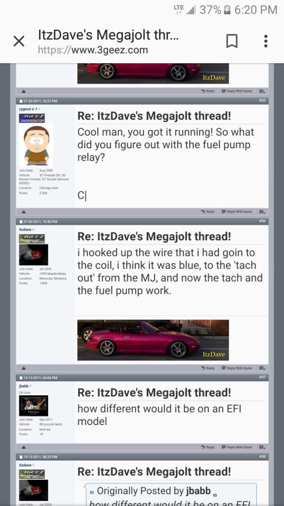

    The stock fuel pump relay,well for EFI, looks at the neg side of the coil to confirm the cars running that might be what you need.
    This
  20. #70
    Jun 2010
    967
    Re: Megajolt conversion
    Well yea, there it is. So I need to get a tach signal into the relay.
    Knife doesn't say what he did to fix that issue though, I wonder what he did.

    i hooked up the wire that i had goin to the coil, i think it was blue, to the 'tach out' from the MJ, and now the tach and the fuel pump work.
  24. #74
