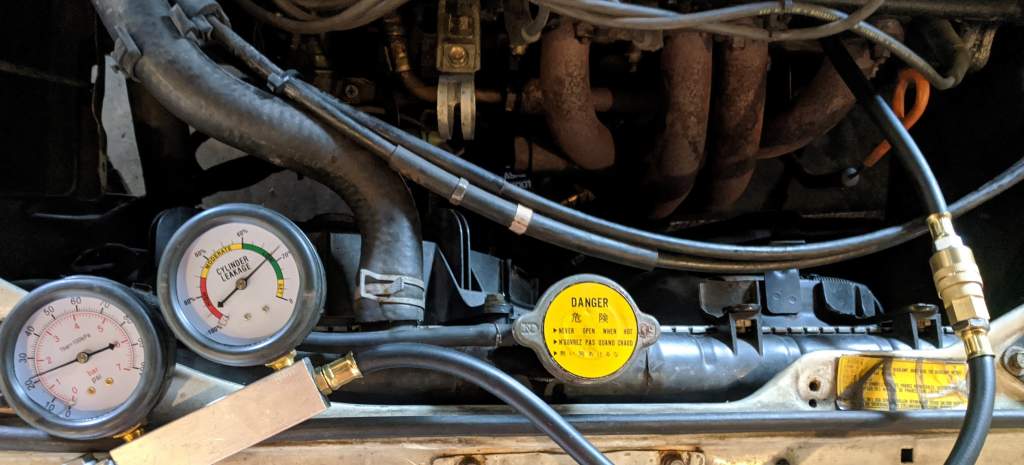

    Ok, I am 90% sure I have excessive blowby. It leaks oil from every gasket and seal top to bottom of the engine. You can feel it when opening the oil fill cap and I'm loosing about a half a quart every 500 miles now. I don't think I'm burning much.
    What can I do to test and figure this out. This is supposedly a new engine but had some cold starts after it sat for 3-4 years. The performance seems really good, pcv valve is fine, has plenty of power and doesn't smoke. I'll do a compression test and maybe get a boroscope to look at the cylinder walls but other than tearing it down to see if my piston oil rings are stuck I don't know.

    Cylinder leak down test will tell you what you need. A vacuum gauge might also be useful. I'd start with the vacuum gauge.

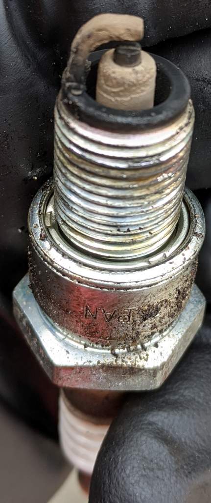

    I purchased a leakdown tester and a boroscope the other day. When checking the engine cylinders 1,3,4 had no leaks but cylinder 2 had about 25% leak. So then i connected the air compressor to the cylinder and it was definitely leaking down into the crankcase. A look with the boroscope in that cylinder looked fine, all the cross hatch marks were there and there were no vertical scoring. So my guess is a stuck piston ring or oil control ring or both. I attempted to free it up if that was the case by putting just enough Marvel Mystery Oil in through the spark plug hole to cover the piston and let it soak. I did this repeatedly for 3-4 days, turning the engine over by hand before adding more. The last fill the oil did not drain through, the other times the oil was gone in an hour but this last time the oil sat there for a whole 24 hours. I got the oil out and ran the car for a bit and did another leakdown test and it did not show any leaking. I'm not calling it solved yet but that result was hopeful. I did drive it for a whole day after that and while i still had quite a few oil drips when parked the oil dipstick was still seated correctly and not pushed up.
    Pic of cyl #2 and the spark plug. The other spark plus were normal, but you can see here it was definitely burning oil.

    Other news, i exchanged the new starter that was put on the other month. It wouldnt start consistently all the time, sometimes resort to chugging. Replaced it and the new one starts fine all the time but now i get a metallic sound, its as if the gear is hitting the flywheel too hard. I am unsure if i installed it upside down, im not even sure that possible but ill take it off and have a look. The old one was off the car for a week or so while waiting for the autoparts store to figure out how to order the correct starter. They kept on ordering the automatic starter but since the old one was off for so long i forgot how it originally was on there.

    That's impressive that you got the blowby fixed so easily. If you had taken that to a shop, it would have been an engine rebuild.
