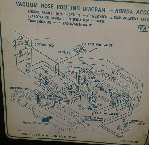

    I was wondering if you had any info on the EGR valve on how to test that part. I know that if that's wonky it could make everything run ruff and rich
    Here's a snapshot of my hood sticker

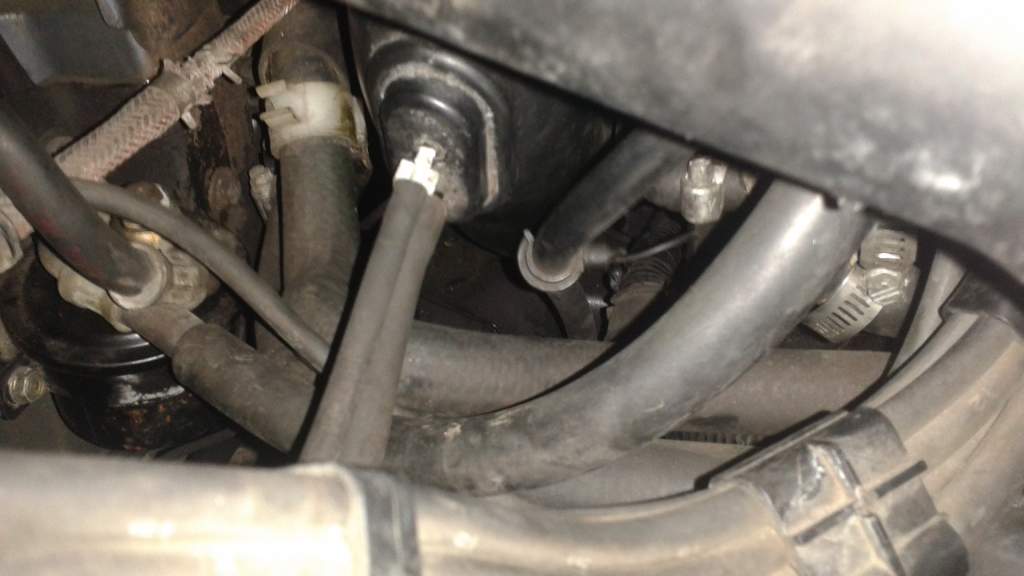

    This hose was leaking so I had to put a new one in. It connects to the main coolant pipe across the back of the engine to a fitting on the intake manifold right by the PCV valve.Click image for larger version.

    The hose connects to the underside of the intake manifold. It's "piped" at that spot to make it to the topside of the manifold right between the throttle body and the valve cover.

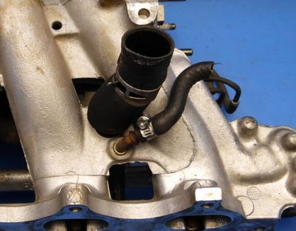

    https://www.ebay.com/itm/86-87-Accor...-/192716986383
    Sorry for it being an ebay link, but about the only picture I could find. go to the pic of the manifold bottom, that small hose connected to a metal fitting right next to the large hose, is that the one you're talking about?
    Yup, that's the one. It looks real innocent there, but trying to get to it is a real chore.
    If I was to get into the heads of the design team for Honda I think this was their way to pass this line from the bottom of the manifold to the top without risk of cooking a rubber hose on the manifold (their is another coolant fitting directly above it right next to the PCV valve.)

    OK folks, we're REALLY close to solving this.
    So, as I started to suspect, the EGR is going wonky..... could be on it's own or by fault of in proper input.
    > First thing, started the car then pulled the vacuum line and plugged it. The car's idle instantly leveled. After it warmed up the idle dropped to it's normal 750 rpm. I tried to reconnect and she instantly started to sputter, so I unplugged it again. After a quick drive around the block everything sounded great with a slight hiccup around 2k while accelerating in 2nd gear. Naturally, when I rolled up into the driveway the car got a code 12 (I expected that due to the fact that I had the vacuum hose disconnected from the EGR)
