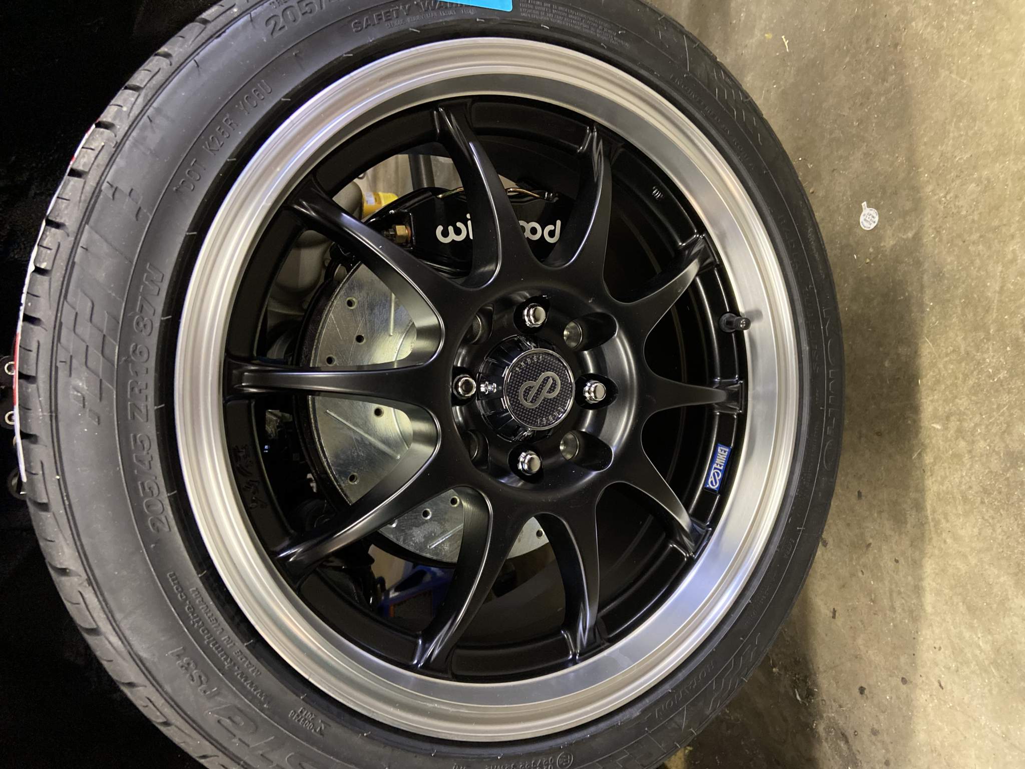

    Re: Wilwood Front Caliper Kit
    They are quite fetching when installed
