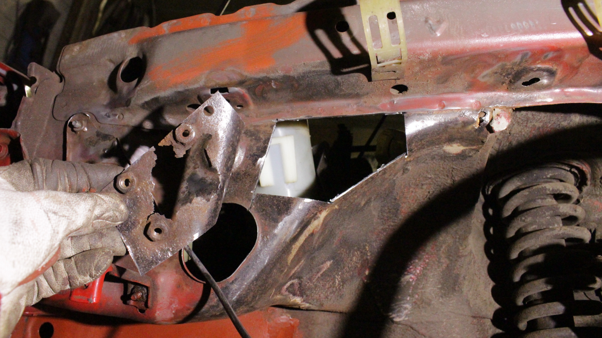

    I had the most productive day ever this weekend. There is not a lot left to do in the front now. The right side is finished, short of a layer of undercoating. The left side is ALL WELDED UP YAAAAAAAAS (almost). One m8 nut needs to be spot welded on, because I forgot that one, then it's finished.
    Picture time. Sorry for the shitty pics but i keep forgetting my good camera at home.
    Rust. Not as bad as the right side.

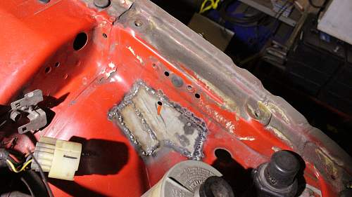

    All welded up and primered. WERI NIIICE

    There we are. As you see I had to make another bit aswell. The metal was too thin and I kept burning through so I had to cut a bit more. I ordered a band grinder just to make grinding inside the engine bay a bit easier (any excuse to buy new tools)
    All that is left to do in the front is make the patch in the enginebay look nice, paint the front end, paint the inside of the frame (if you take of the brackets for the bumper you see straight in, perfect for paint and wax), some undercoating and then put it all back together again. EPIC

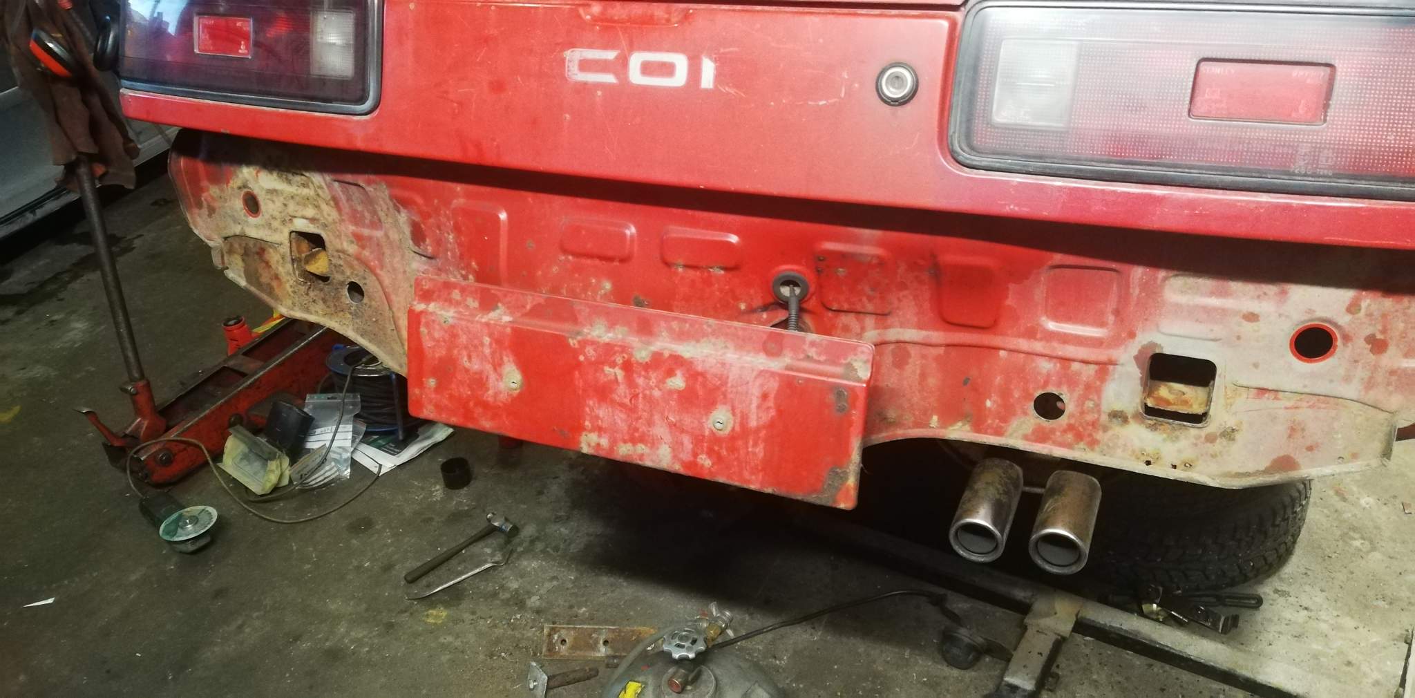

    Rust upate!
    I have taken of the rear bumper. At first glance it looks like just surface rust, but it has gone through in alot of places. Alot of teeny tiny holes with thin metal around them. I know what I'll be doing for the next couple of weeks .
