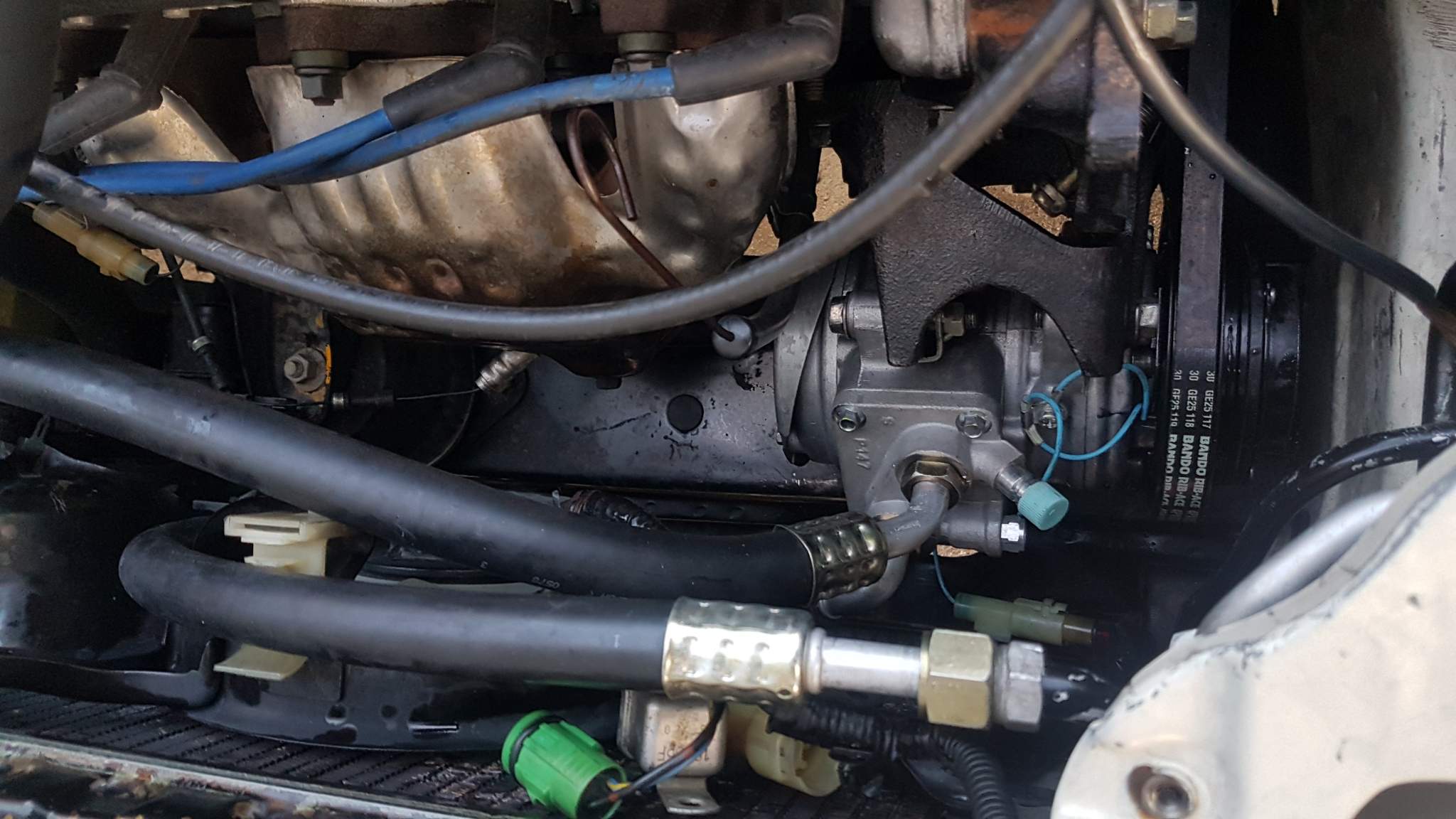

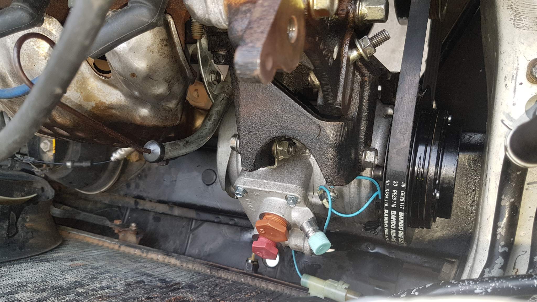

I did the kehien to Denso swap on my 86 prelude as the kehien compressors just didnt want to last with r-134. i do have several pictures of the process that i would be happy to share if needed.
heres the Kehein compressor mounted in the car
And heres the Denso mounted in the car.

If I remember correctly there are two ND compressors that can use the same bracket, one just has a longer body... and the Keihin has its own.
Back in the day they used to say the Keihin doesn't play well with r134 but I doubt that, as long as you flush it all and run PAG it should be fine. Hell I ran iit on propane at 70psi low until I found all the leaks

PAG might help, but in my experience r134 leaks right out... Performance would probably be awful at that
