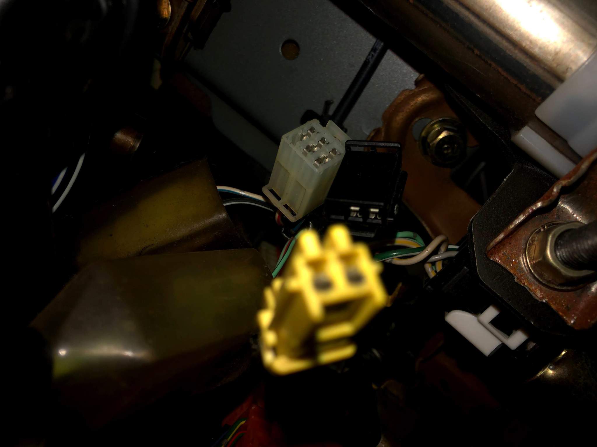

    oh and another side note im also wondering where these 3 wires go its a yellow and white connectors located under the dash sorry the picture isn't the bestClick image for larger version.

    I think all thats inside that little box under the radio mount. it might be unpluged or the ringer modified. I cut mine out years ago but keep the box to let me know if I left my headlights on.

    Sounds like a ground problem to me.Try putting on a straight ground from chime negative to chassis and see if that works.

    right so turns out the grey box under the radio was giving out so I think I'm probably gonna go to a junkyard and pulling one out of an accord there or if anyone has a spare one that still works and wants to sell it to me that'd be great too still haven't figured the key in chime though
