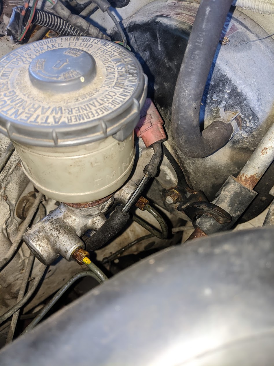

    Ahhh! Now I see what you mean ShiRen, I guess I'm gonna have to take a look at the piston bore of the old cylinder and compare it to the size of the new one, having thought about the pressures I agree with that too ShiRen.. The part in my car is the same way round as the US ones, not like in that pic dont worry Oldblue (I've tried to attach a crappy photo of how it looks in the car atm). The one I bought on RA for reference is the Centric 13140008 https://www.rockauto.com/en/moreinfo...942&cc=1166969 .
    I was considering a rebuild of the old one, my mechanic said he thought that could be fishy since given the sinking pedal, the piston could be off centre and gouging into the metal, no clue how one of these works so not really sure I can comment.
    Really appreciate the help guys!

    Re: Master Brake Cylinder Bores
    Yhe just had a check, the new one I bought was an LXI one so 15/16 bore, I guess thats what I'm hoping for!
    5,315
    Well looks like same size fittings. The fittings are soft and pretty easy to cross thread. Yours are a little rusty too.
    You may want to thread the fittings on then put the master cylinder all the way on just to make sure you got them threaded correctly it can be really frustrating. you bottom out the line against the female cup in the master cylinder then start the fittings
    Dont forget to bleed(bench bleed) the new master cylinder first like I have in that picture above to get the air out. you will never get all the air out all hooked up in the car bleeding at the wheels.
    Getting air out of the ALB modual is a whole nother thing that maybe the dealer can help you with.
    Yeah now that you posted a picture that does look exactly like the US spec master cylinders. If it actually does fit then I don't see any issue in running the 15/16 bore even if the one on your car is 7/8. Imo my 7/8 is a bit underpowered, I am just going to grab a Wilwood master cyl since I don't have power brakes anyway.
    It would be a very good idea to replace the oem fittings, they are made out of the worlds worst pot metal, so I would still verify your line size and if they are 3/16 grab some good, preferably stainless, M10x1 fittings.
    Right, did some checking with the calipers. Both lines are 3/16, and the fittings are M10 (front one) & M10.5 or M11, (couldnt get in close enough) as suspected. Given the lines are the same I'm more confident going ahead with the new master cylinder. Plan now is to do some research on the OE part, if nothing, get the old one out again, check the internal bore diameter and then cross fingers, hopefully the inner piston is the same and bobs your uncle.
    Good shout on the fittings, will get the manky things changed over.
