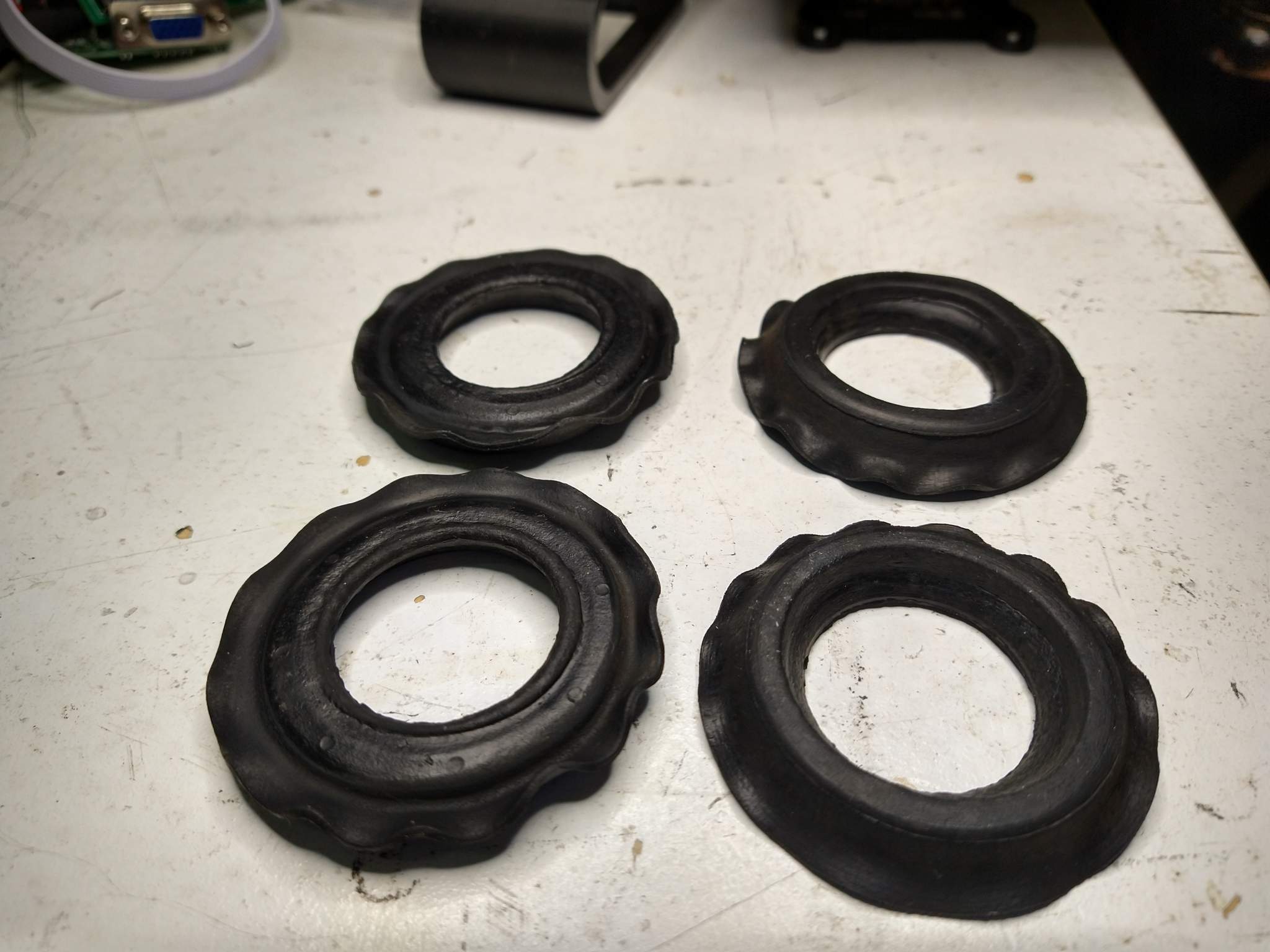

    The crossmember bushings look to be a 2-part deal..meaning that there is a metal/rubber bushing pressed into the k-member (4 total, 1 for each bolt) and these rubber bushings that go around the pressed-in bushing where it protrudes on the upper side of the crossmember. I will get some pics of the other bushings after I remove them from the kmember.
    These have seen better days and my ultrasonic cleaner seemed to have warped them a bit, that is why those edges look wavy.

    I too found a couple of mine to be warped. I believed it was the two below sweeping master cylinder.Click image for larger version.

    What do you plan on doing to the crossmember? This "traction bar" isn't really factory style, but it may be better than messing with the subframe bushings. The biggest difference is the strut rods have a metal bushing, might make it ride rougher or make noise, I don't think it would be too bad if you don't swap out your whole suspension for poly or solid bushings. If you do use a factory crossmember I would suggest machining the bushings out of aluminum. I reckon they are rubber for easy fitment in the factory. Aluminum bushings will last forever, just make sure the new crossmember is sitting in the car square and tight up against the frame.
