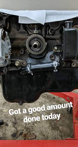

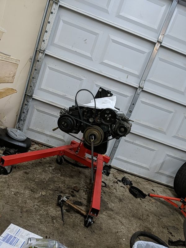

    Re-assembly of the A20 was going pretty smooth.
    There was one hookup while assembling the bottom end where it didn't want to rotate smoothly.
    Swapped the rod caps out on two different pistons and it turned like butter.
    Also put all new accessories on block (used old PS pump, Alt, and Starter), new belts, new gaskets.

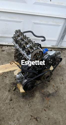

    At this point, half of the hard work was done.
    I had a little bit of help on assembly from some local Honda friends of mine, but I knew assembling the top half, getting the motor in, and getting it started, was going to be all on me.
    The second-half of assembly was a lot less nerve-wracking, and went very smoothly.

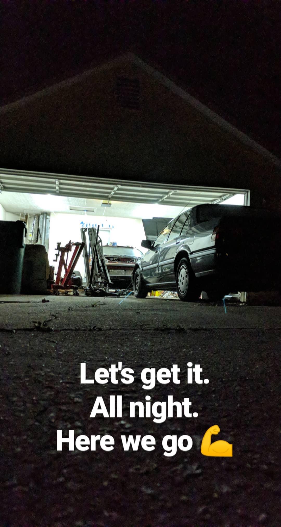

    This was going to be the hard part, because I only had straps and an engine jack to do it with.
    No second pair of eyes.
    No leveler, or second pair of hands.
    No muscles on my scrawny arms to adjust much.
    But after a lot of cursing and working overnight, it got back in!

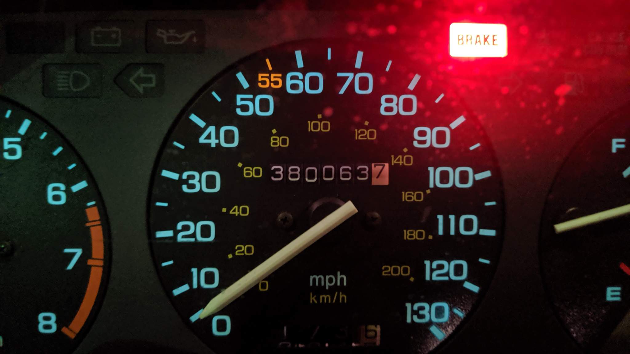

    It eventually made its way to 380K miles, right before my spedo cable broke, and my odometer sat like that for a good few months before I could replace the cable.
    I eventually got the cable replaced a few months later, and adjusted the odometer accordingly to what I calculated to be the actual miles..
