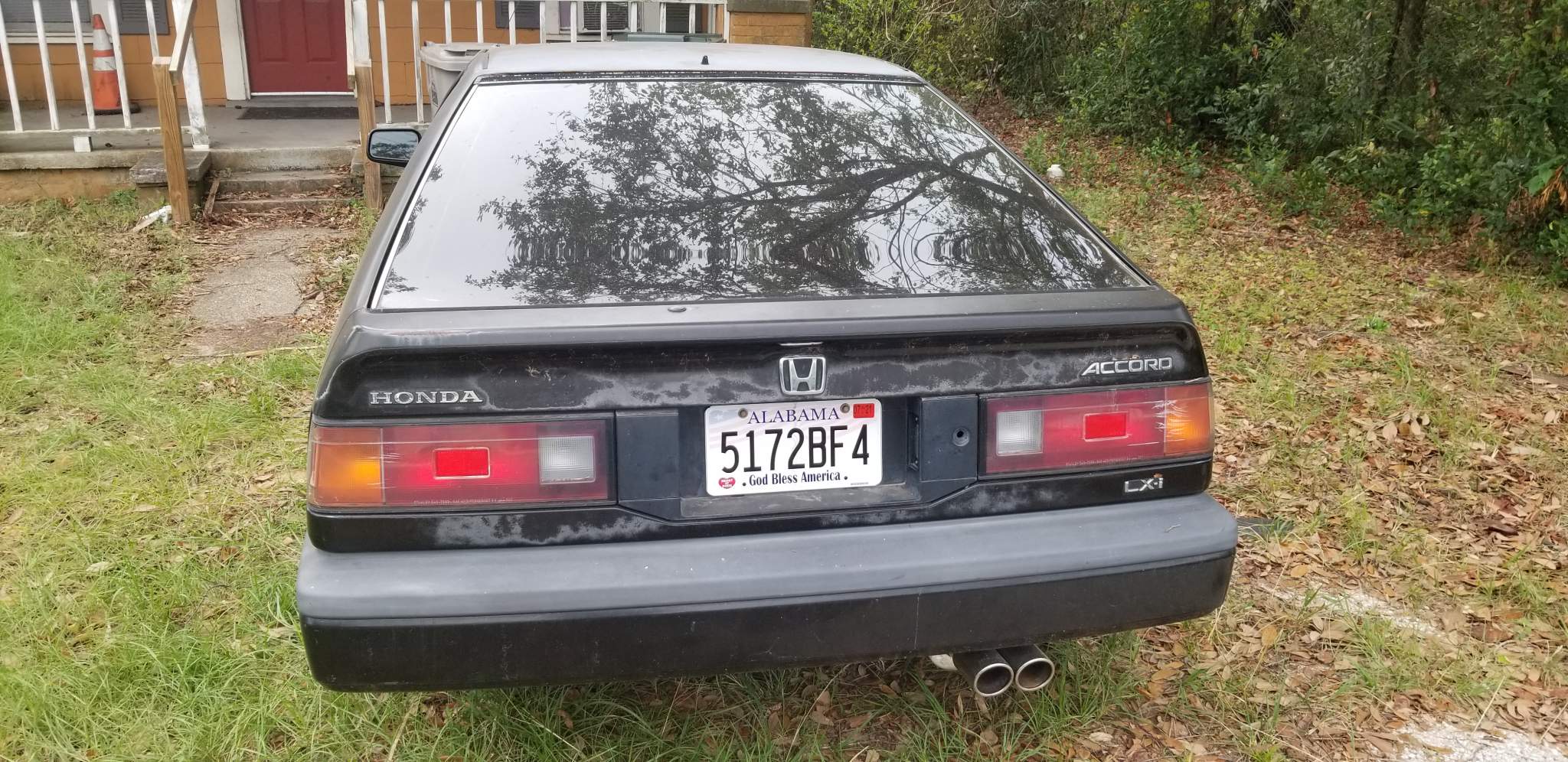

    Vacuum lines seem to be a mess, there isn't even a line going to the EGR valve. Pics of car incoming!
