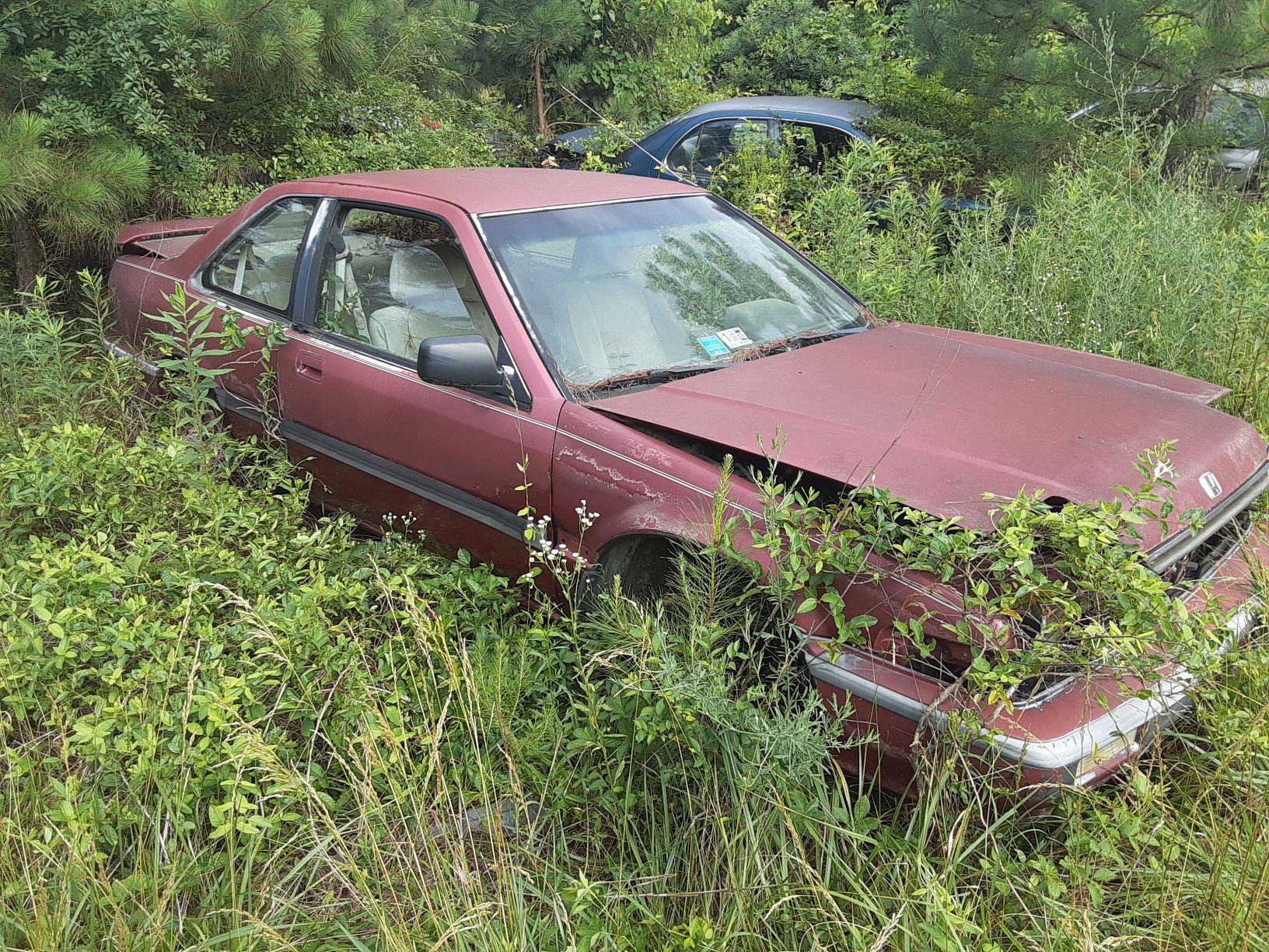

    Finally got to show her some love today.
    Power failure at work resulting in me getting the day off and I got to visit the only dedicated import salvage yard in my area (it's only 50 miles away) for the first time today.
    They actually have an 89 LXi coupe! And it's nearly complete!
    Here's a pic:

    Snagged the intake pipe (from fender to filter box) that was missing from mine.
    Will be back for the passenger rear window, trim and hardware.
